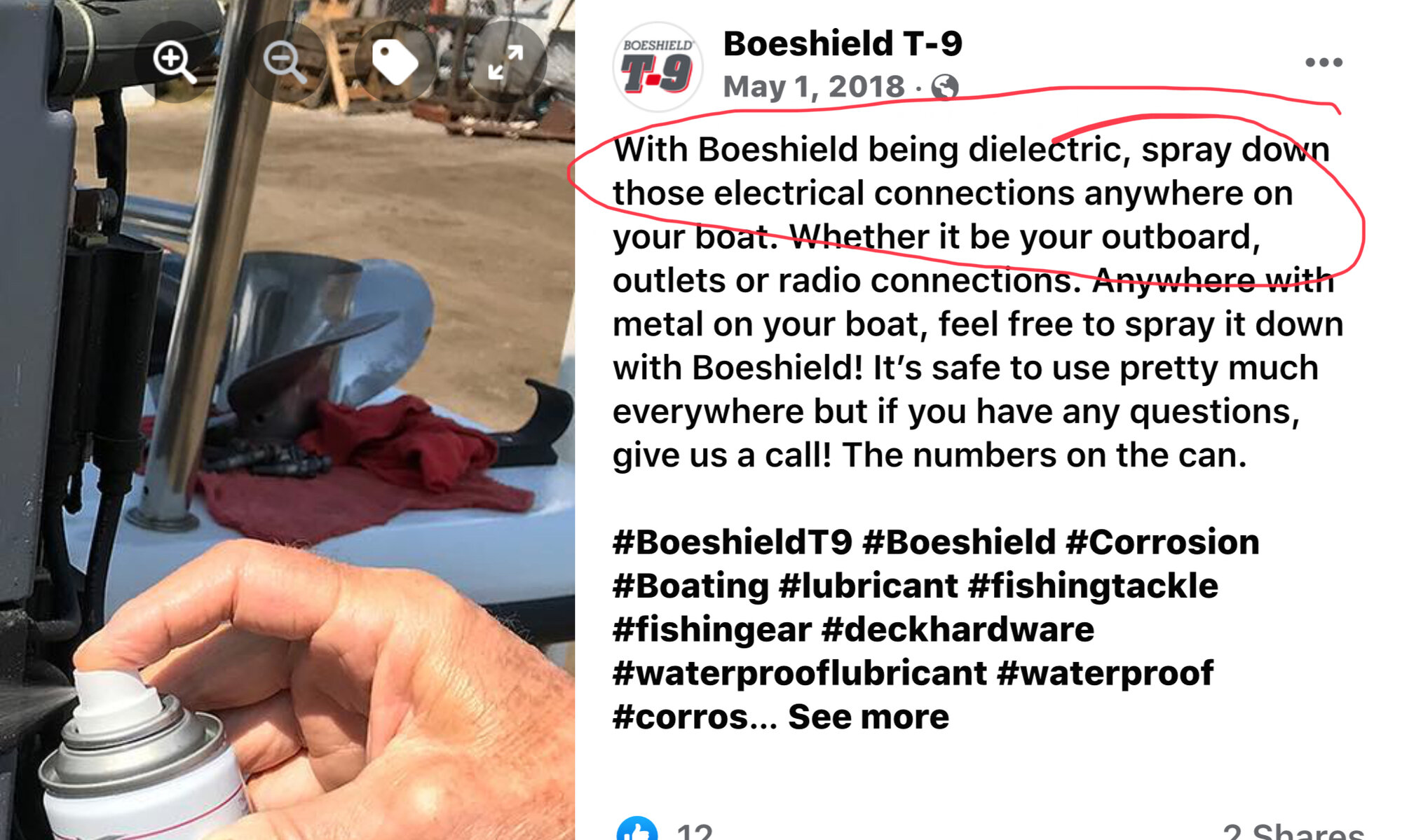

... and I know we've discussed and disagree.... but I've written and spoken with the manufacturer, and this product is not recommended for application directly on electrical contacts. Though application on the plastic surrounding the copper contacts as a pseudo dielectric grease is acceptable.
I guess you talked to the wrong guy.😲 I fueled aircraft for an FBO in my miss spent “Yoot”. I figured if Boeshield was safe for Jet Ranger electronics and the AP’s it’d be fine on eBike. Boeshield wrote, “T-9 is nonconductive and will not cause short circuits, so it’s also safe to use on electronics.”

It's recommended for electronics but not electrical connectors, switches or where there is a potential for movement and/or arcing.
If there is any arcing it will foul the connection quicker and be harder to clean when caught in early stages.
As you started, it is non conductive and hence should not be placed between two mating conductors. 😉
Which is what I did and it was explained to me that it is best applied to the outer shell of the connector and the plastic/rubber mating points of the shell to keep moisture out and not to apply directly on the electrical contact points. If some does get on the electrical contact points, the connector should be mated/unmated a few times which should scrape off any T9 from the electrical contact points. These are their words not mine... But it is in line with everything I've ever read from the manufacturers of the hardware I'm trying to protect. Rule 101 is to keep contact points clean, dry and free of contaminates.
