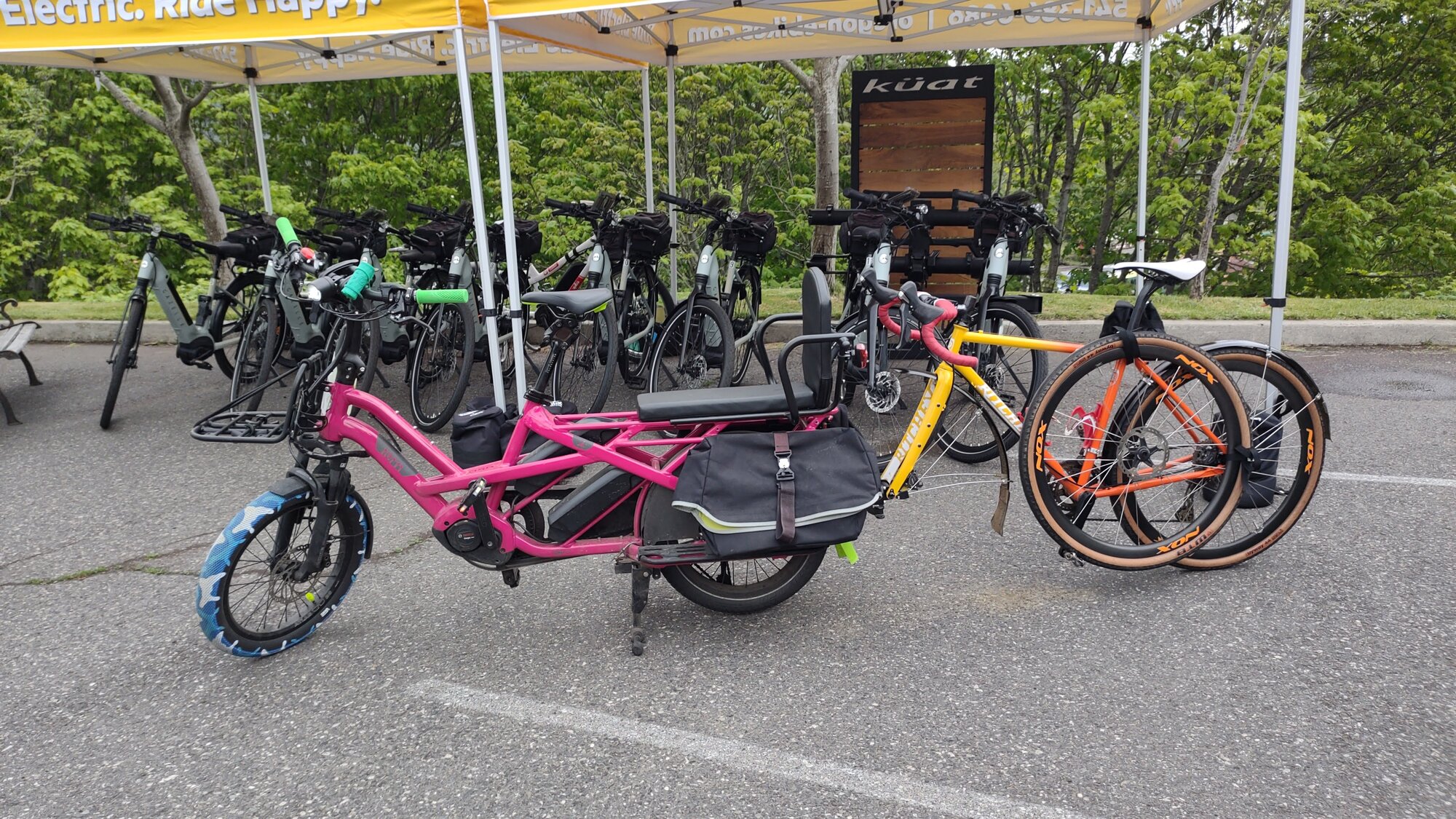

Did you end up finding a bike? If not happy to offer insight! We're a Yuba and Tern dealer and both have great options that feature the Bosch Cargo motor which is a complete game changer!
Personally I ride a Tern GSD S10 LX, shown below! Great option that can haul a person or kiddos and with the new trailer attachment I can tow my windsports gear to the river or bike to the trail head!
The Yuba Spicy Curry City is another great option too, same Bosch Cargo motor but there's a Speed version if you wanted that class 3 28mph pedal assist! Accessory story isn't quite as clever as Tern, but still very expansive!
