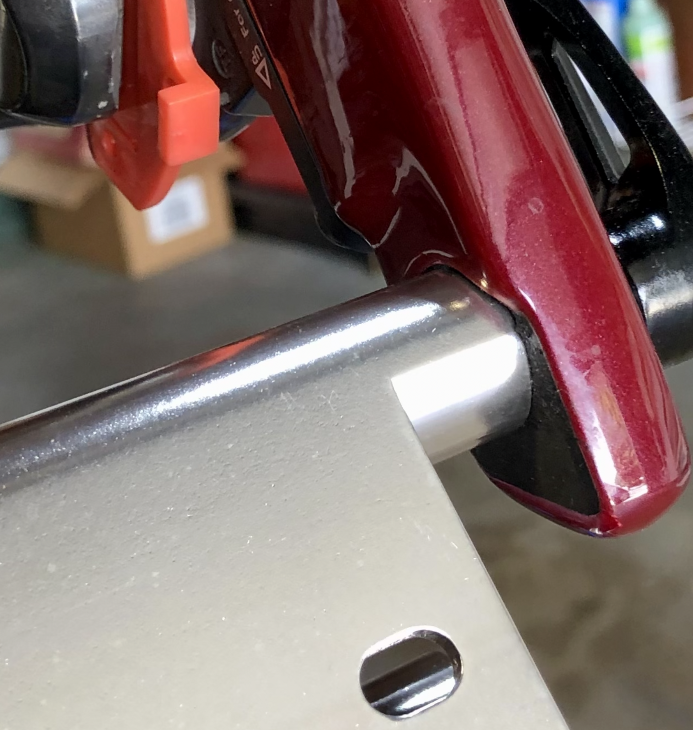

The build and finish is excellent. The length (110 mm) is perfect and the outer diameter is perfect where the fork just drops on the adapter without scratching the fork.

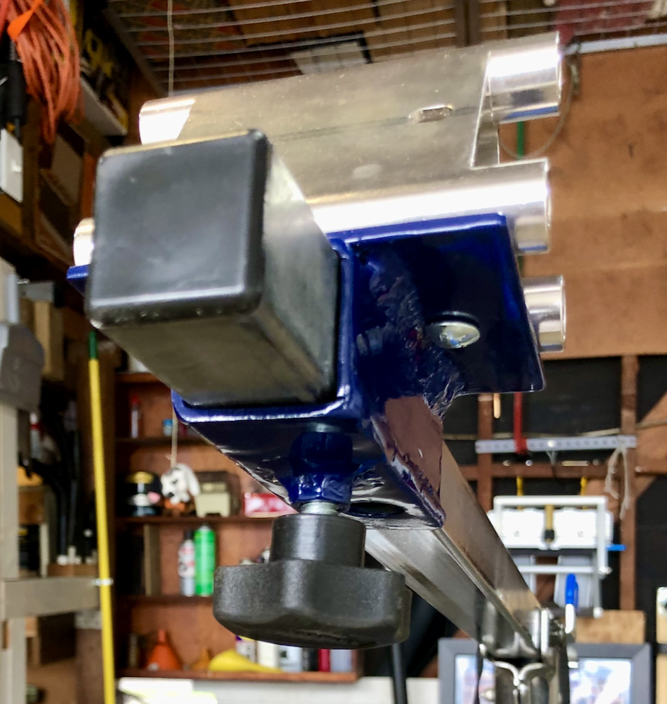

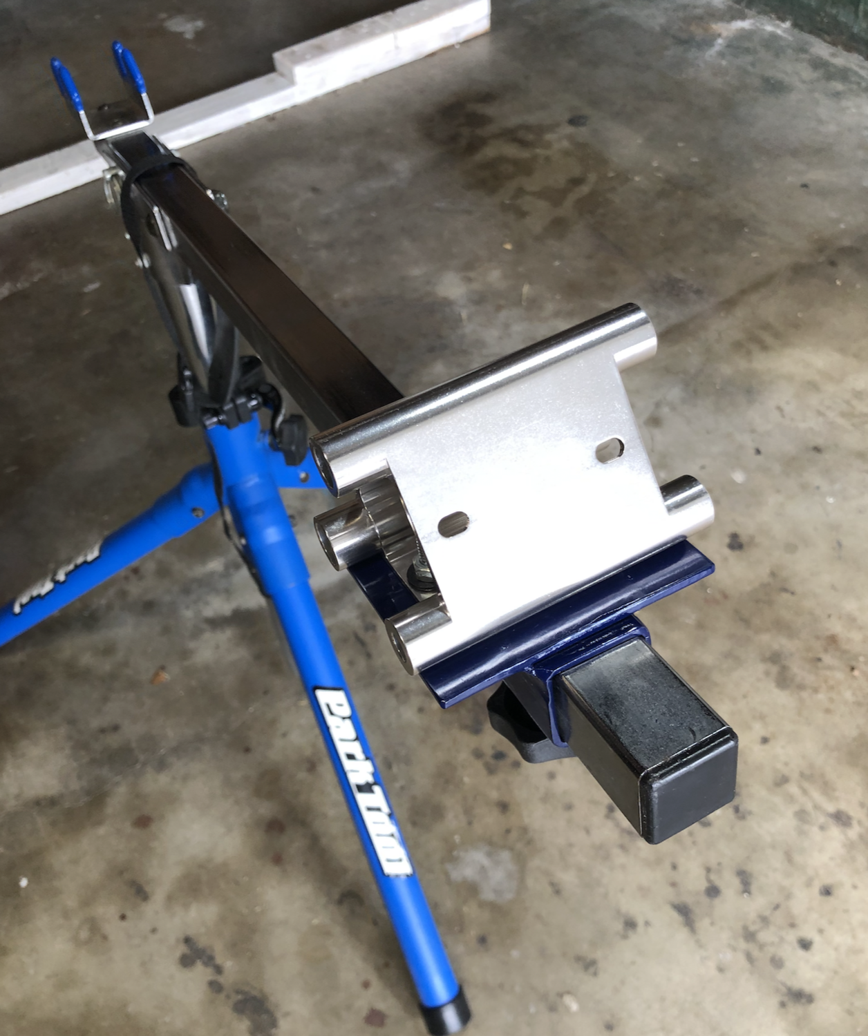

With my build, some welding was needed. I don’t know if it is possible to build this without a welder. It may be possible to clamp the adapter on the old sliding mount but I didn’t attempt this. The welding involved building the sliding adapter, welding a flat plate on the sliding adapter and welding a nut on the sliding adapter. Then, to finish, drill holes in the flat plate to mount the adapter.
Here are some pictures. Top.
Bottom

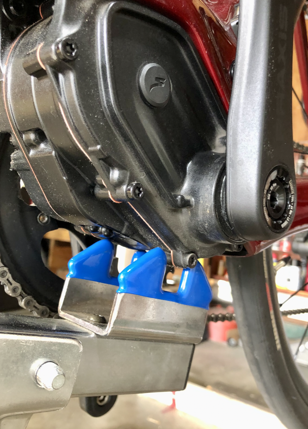

Rear mount with motor shield removed.

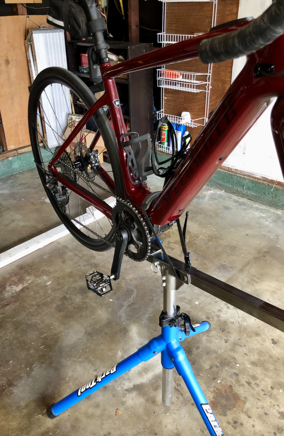

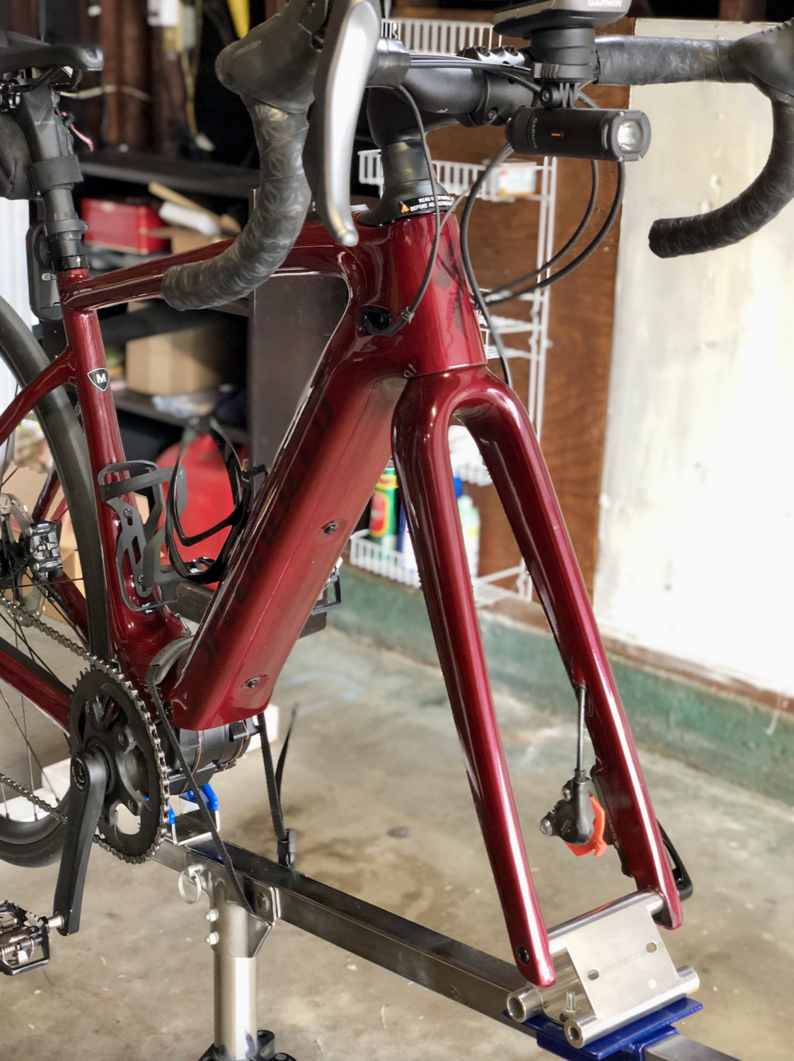

With this setup, I can mount the bike without any help. After dropping the fork into the mount, the bike will balance on there without installing the axle but with my bike, I didn’t let it balance for long without the axle installed. With the bike weight, the bike feels stable on this repair stand. I have one feet of the stand parallel with the fork in the front but this leaves the rear less stable. In the future is will try with the rear feet parallel with the bike.
