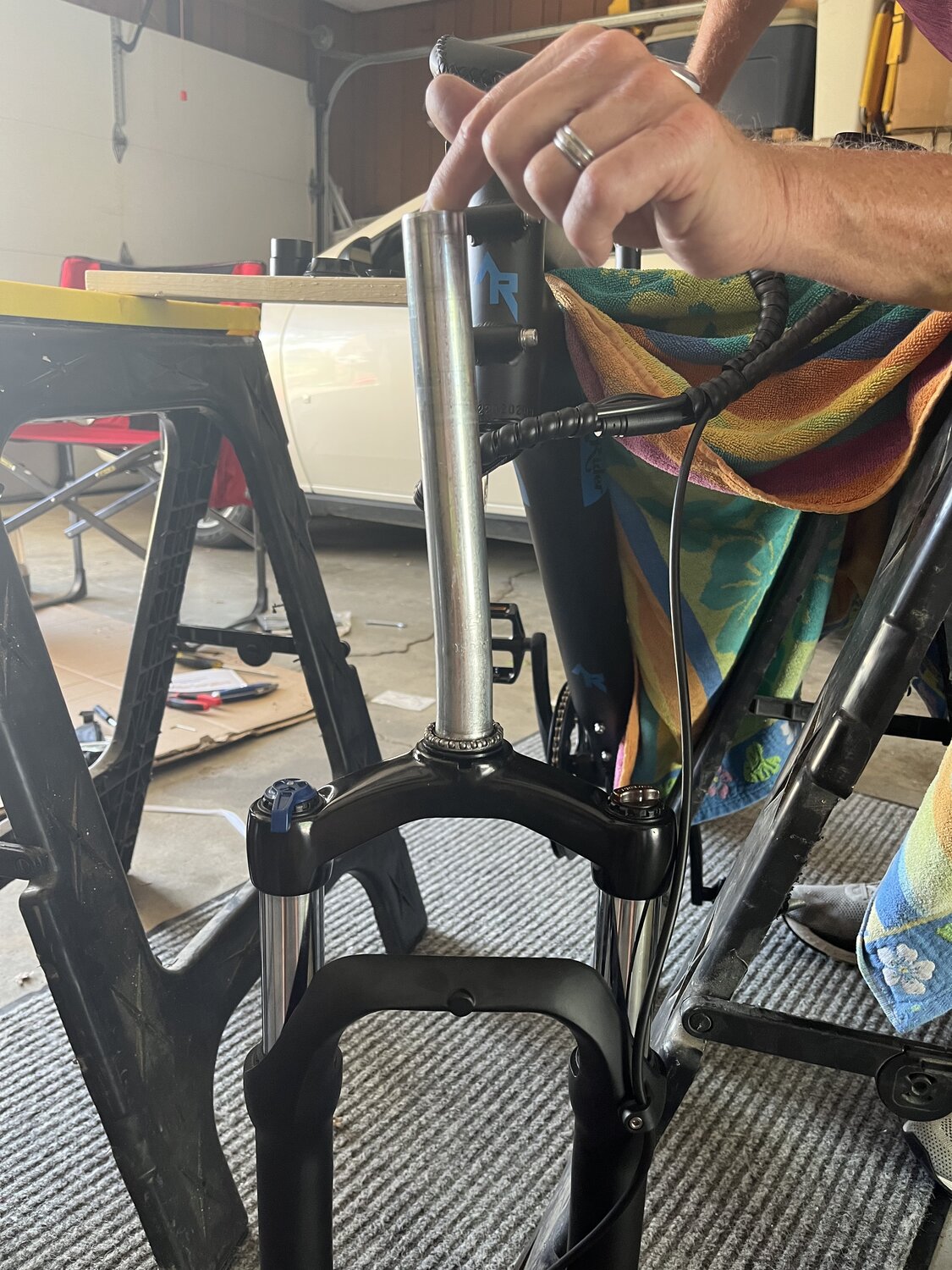

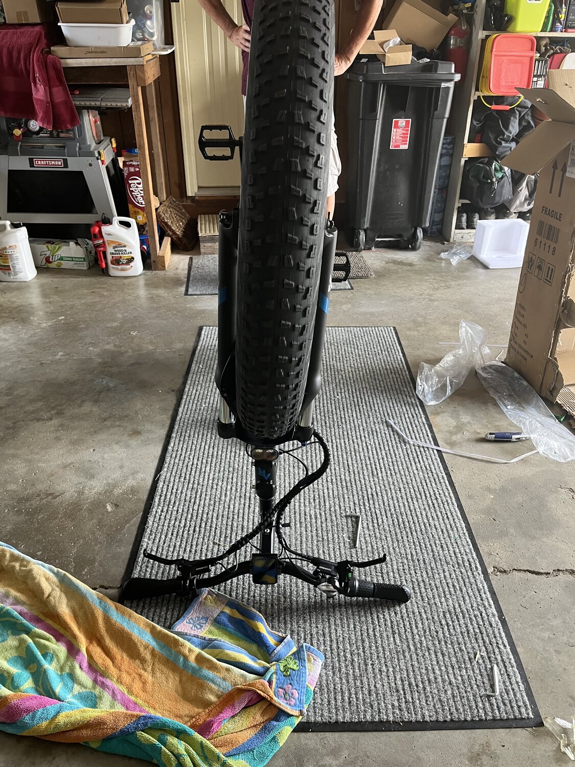

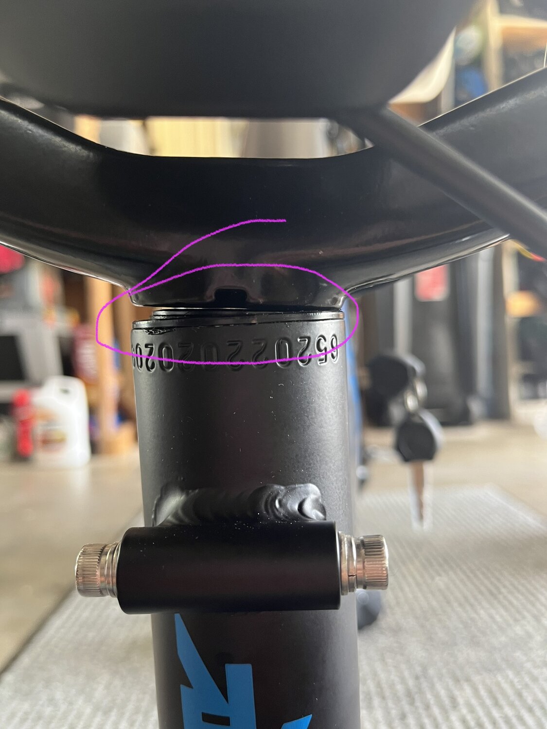

Any suggestions for replacement fork? Haven’t heard back from AR yet. Kepler unrideable with the bent tube.
FYI: Marked up photo—bike is upside down.

Should turn to the left well?
That is a really bad place for a bend. You could massage it back in place if you knew how to, I would recommend your local frame builder or good bike shop, but probably money ill spent because you could never trust it and that is not a spot where it will end well upon failure. Looks like you need a warranty claim or search for a 135mm fatbike fork online.
Ariel should send you a new one, and offer a credit for your troubles. Better than returning the bike on their dime, which is your right,
