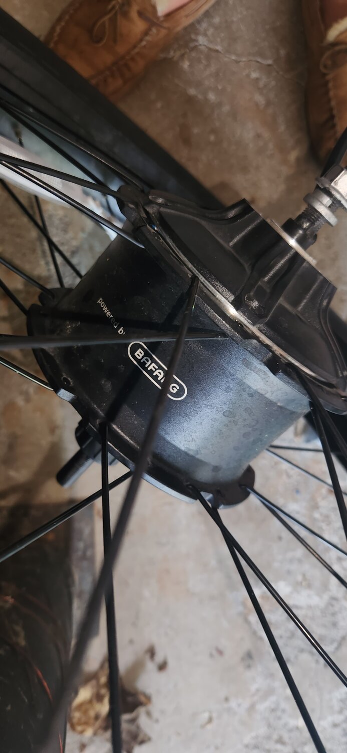

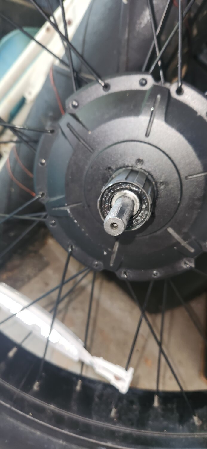

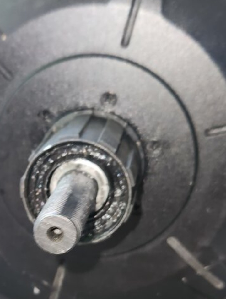

I have one of the new Juiced RCS bikes with the new 1000w motor. I need to remove the casset hub but am having a hard time getting the motor to open up. Watched a video on doing it and is pretty straight forward. Once all the nuts and screws are removed should just be able to pull it apart. Any ideas would be appreciated. Don't think I've overlooked anything.

I'm just guessing, but if it were me I'd remove those Philips screws to see what's underneath.
There might be a big C-clip to remove to get the hub off?

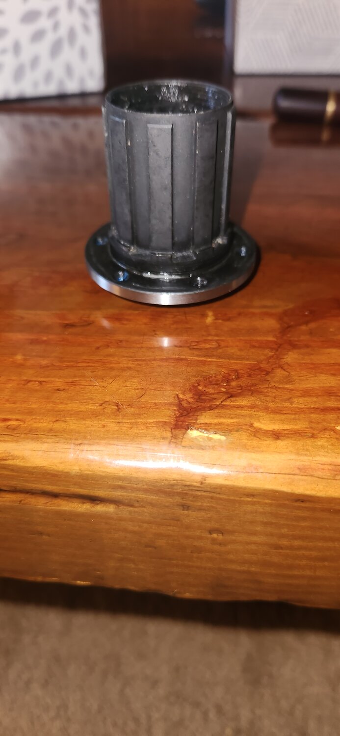

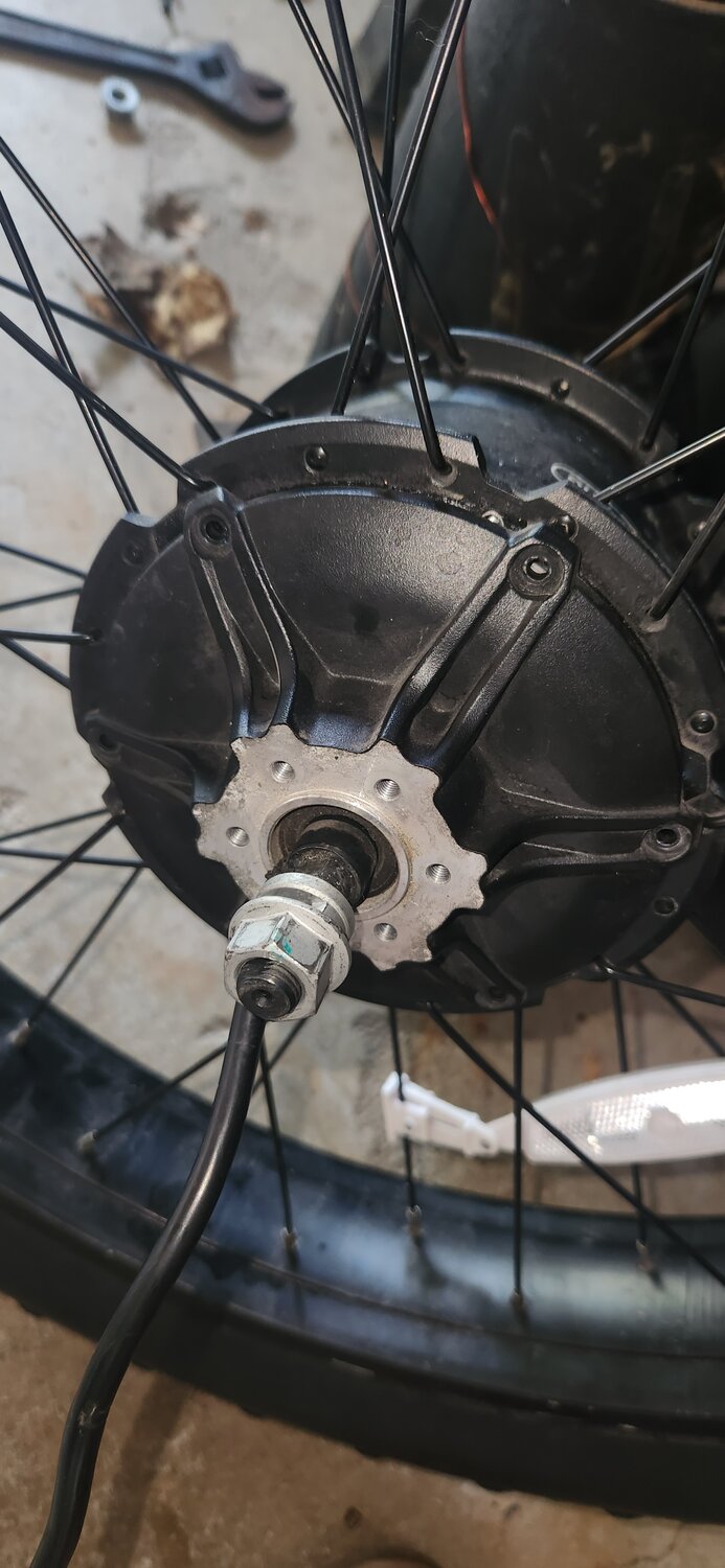

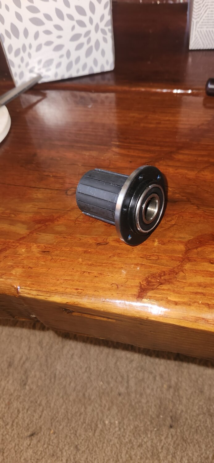

The axel should slide out of the casset hub. Once the Philips screws are removed the hub slides back through the hole in the housing plate. I did believe the axel shaft was press to tight on the casset hub bearings. Thought about that for a minute and realized if I removed the Philips screws then the motor plus the casset hub should slide out as one piece. It worked and then I used a 3 jaw gear puller to pull the casset hub off the axel.
