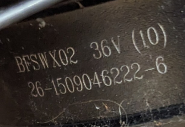

I'm looking for your help with a new bike build. I've found a bike for $150 that's missing the display, battery, and thumb throttle. It has 0 miles on it and the missing parts were taken for use on another conversion.
