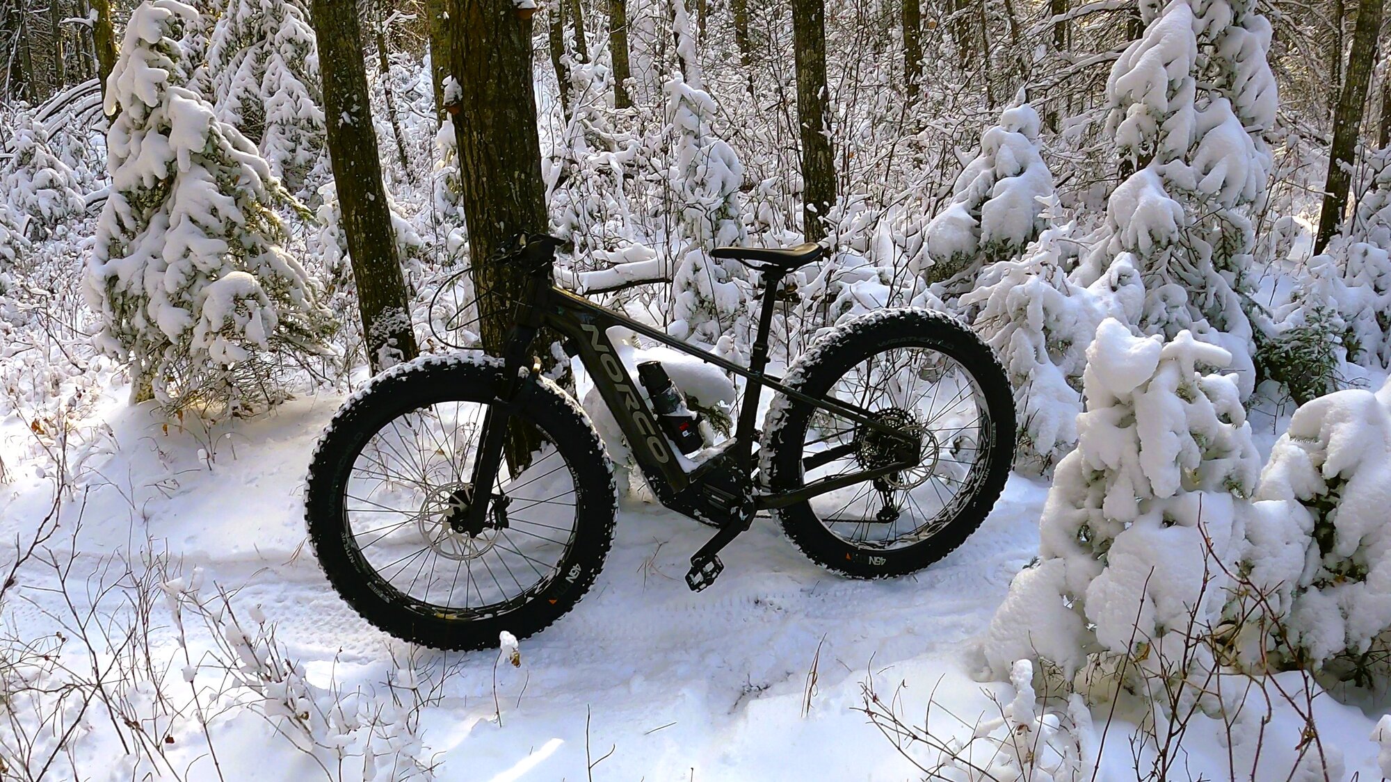

Where do you ride if you don’t mind me asking? I’m afraid that I've only ridden one mid drive brand of fatbike up to this point so my opinion may be biased. I currently own a 2023 Norco Bigfoot VLT1 and all I can say is that it’s an exceptionally capable bike for winter riding. It’s powered by a Shimano EP8 motor that puts out 85Nm of torque along with a 900 wH battery. Norco has opted instead to offer its customers a range of three separate battery capacities to choose from depending on how far you want to extend your ride. It has plenty of grunt to tackle the steepest of icy climbs and is quite nimble for a 54 lb bike. The Bigfoot comes with a set of studdable tires but I chose instead to replace them with 4.5”, 45North Wrathchilds with 252 XL tenacious concave carbide studs. The tandem really makes the bike a beast on the local singles. The VLT 1 is also equipped with a 100mm Manitou front shock which is a nice luxury to have.
Here's footage from the first day I picked it up from the LBS and immediately rode it to the nearest trail.
...and the epitome for me of where the Norco excels would be along brutally icy spring ground conditions as evidenced by the chatter of studs.
For 2024, Norco has introduced the VLT S2 as their entry level model but it still offers serious performance for any demanding winter fatbiker.
