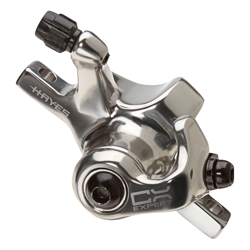

Another thing is the brakes. Now, I have worked on quality bikepacking bikes with high-end mechanical disc brakes that are a joy. The reason for mechanical is that if you are in the Andes or 100 miles from civilization, you do not want to spring a hydraulic leak or vapor lock. That said, these bikes have the worst mechanical (cable actuated) disc brakes. Most of them on the road have no rear stopping power after about three weeks. And it is mostly young teens riding them. Many cannot be properly adjusted because the rear hub motor blocs access to the inner adjustment. The inner pad is fixed and needs to be adjusted weekly. The parents do not check that the kids have no stopping power. Here are what good mechanical brakes look like. These are like jewelry and work super well. So, it is not just hydraulic vs. mechanical. It is all about quality. Stopping is a good thing.
