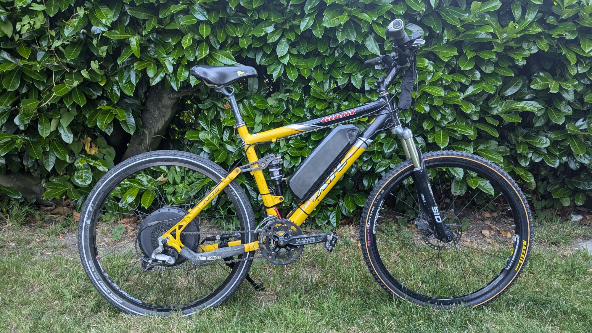

The quietest motor would be a direct drive hub motor, which also tends to be big and heavy. Also problematic at slow speed, which isn't all that much of a problem if you enjoy pedaling. I use a rear direct drive motor and ride trails all the time. Not all that technical, and no down hill racing for me, but the bike does great:
By using lighter motors in each wheel, a dual hub motor trail bike might be interesting.
