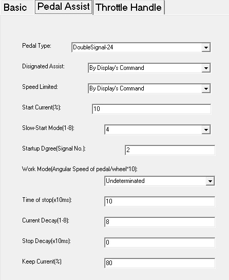

BBS02 750. After setting up the speed sensor, the bike seems to be working normally. Except when I slow down a lot or come to a complete stop, the power cuts out and it takes a lot of pedal spins after turning down PAS level to one before I get any power. Which setting should be modified to bring the motor back to life quickly after a stop?
Thanks
Lower your Start Degree
Read the article @tomjasz linked.
I don't like anything under 4 but ymmv
