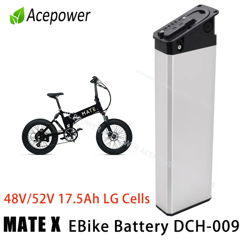

Who makes this battery case?
Looks like 52V 17.5Ah is possible.
I don't know if it's the same case as your Wallke though.
I don't know who makes the case. It looks like the same one though. I'm new to the battery business, if I have a 48v system can I even use a 52v battery? Can I use a 48v battery with a higher Ah rating? My bike has a 750-watt motor.
