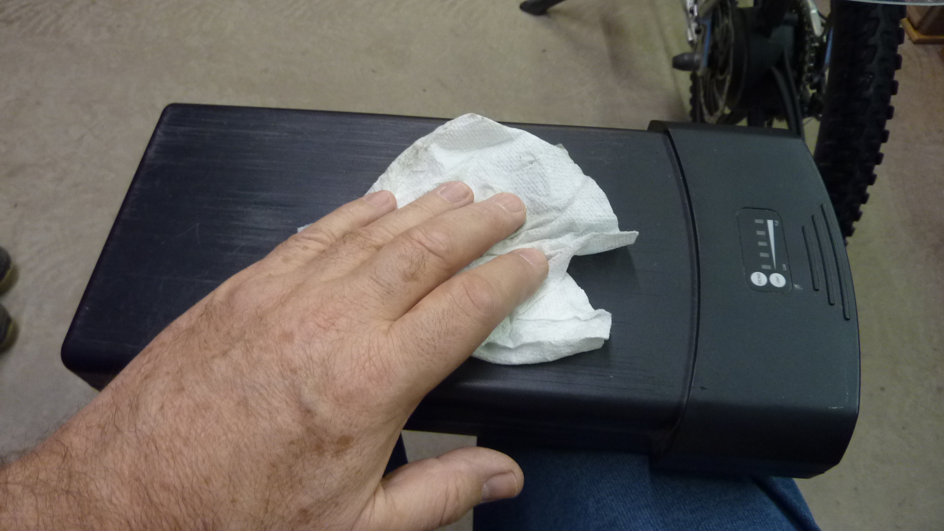

I wipe down the battery and the interior of the battery housing regularly. Over time, grit & road debris work their way between the battery and case making removal more difficult. While covering the battery contacts, apply a VERT LIGHT coating of dry silicone spray to the cleaned battery. Do not spray anything into the bikes battery housing.

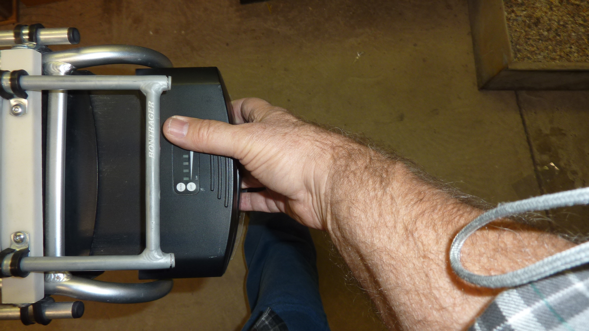

I found the best approach to removing the battery is this:
Place your right foot behind the rear tire to "chock" it
Hold the key lock open with your left hand and the battery with your right.
Rock the battery back and forth as you draw it out.

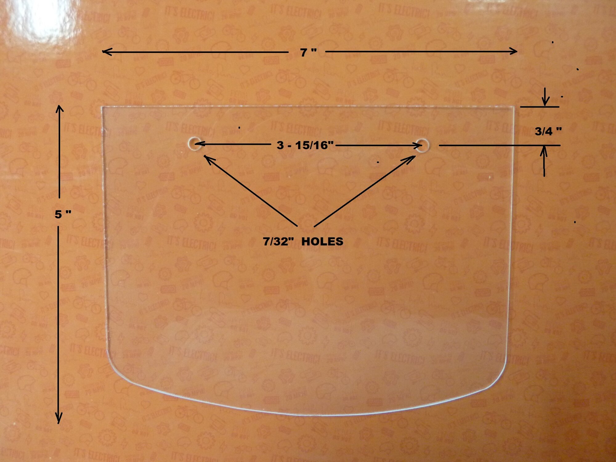

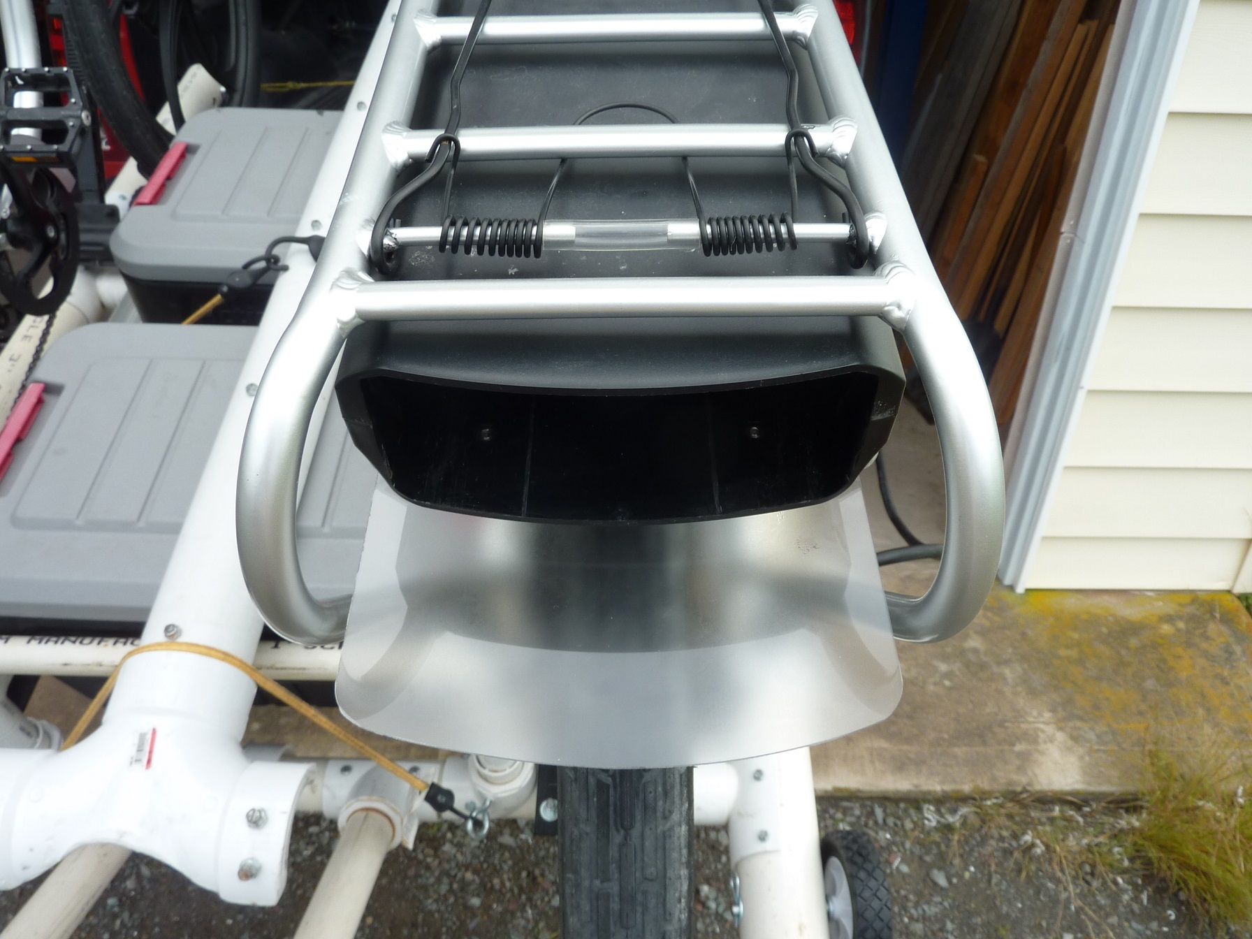

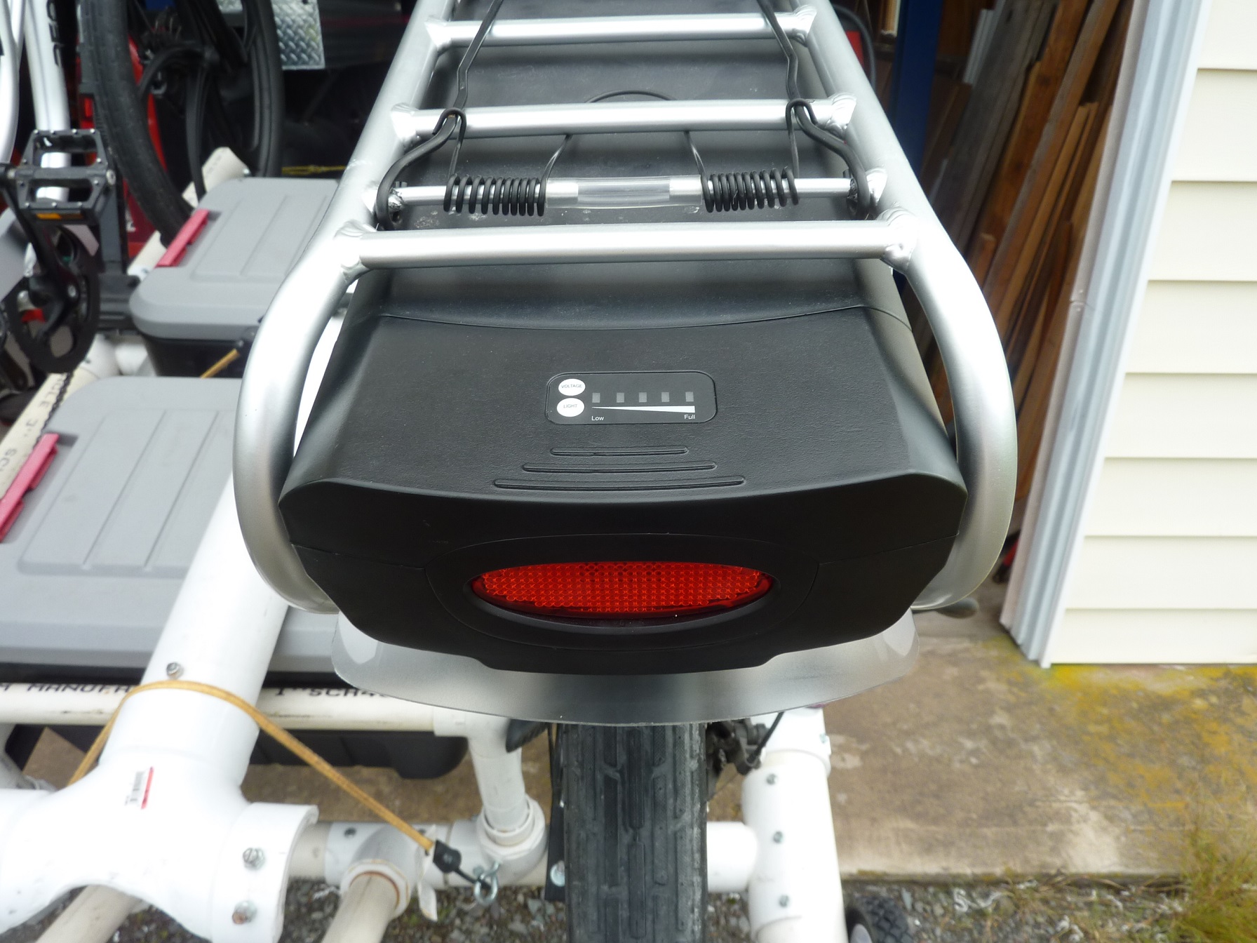

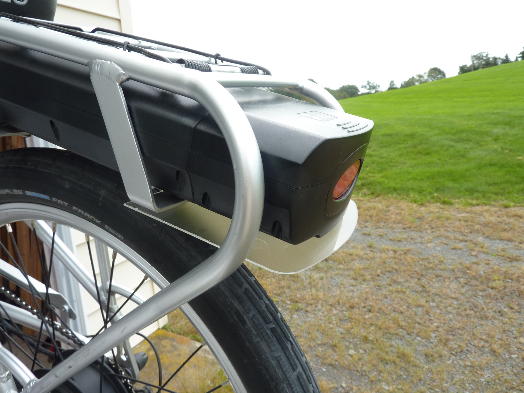

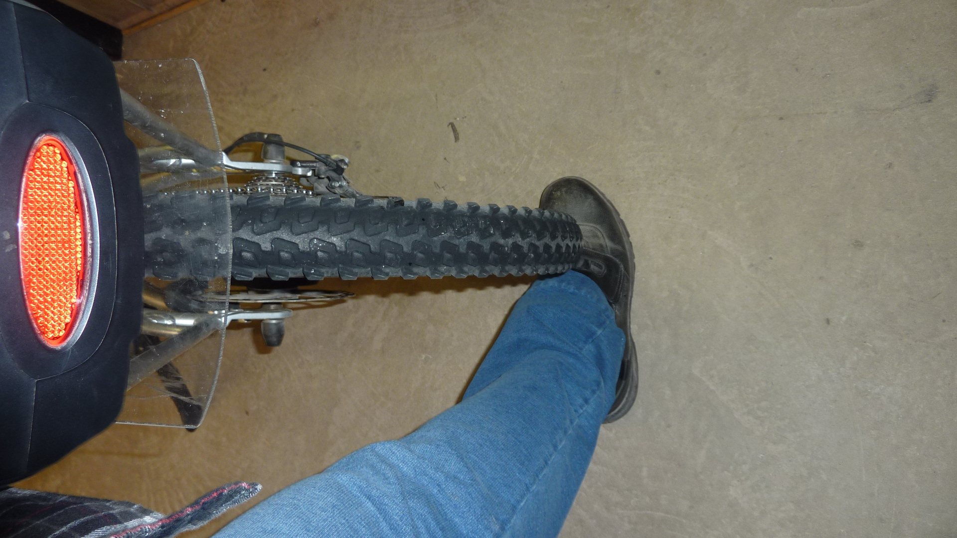

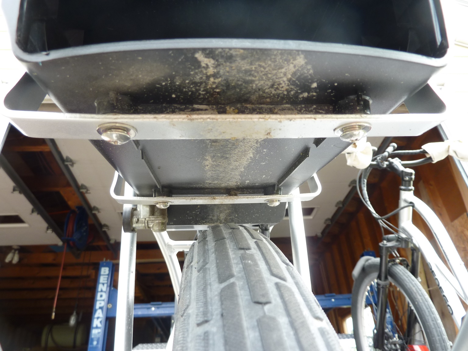

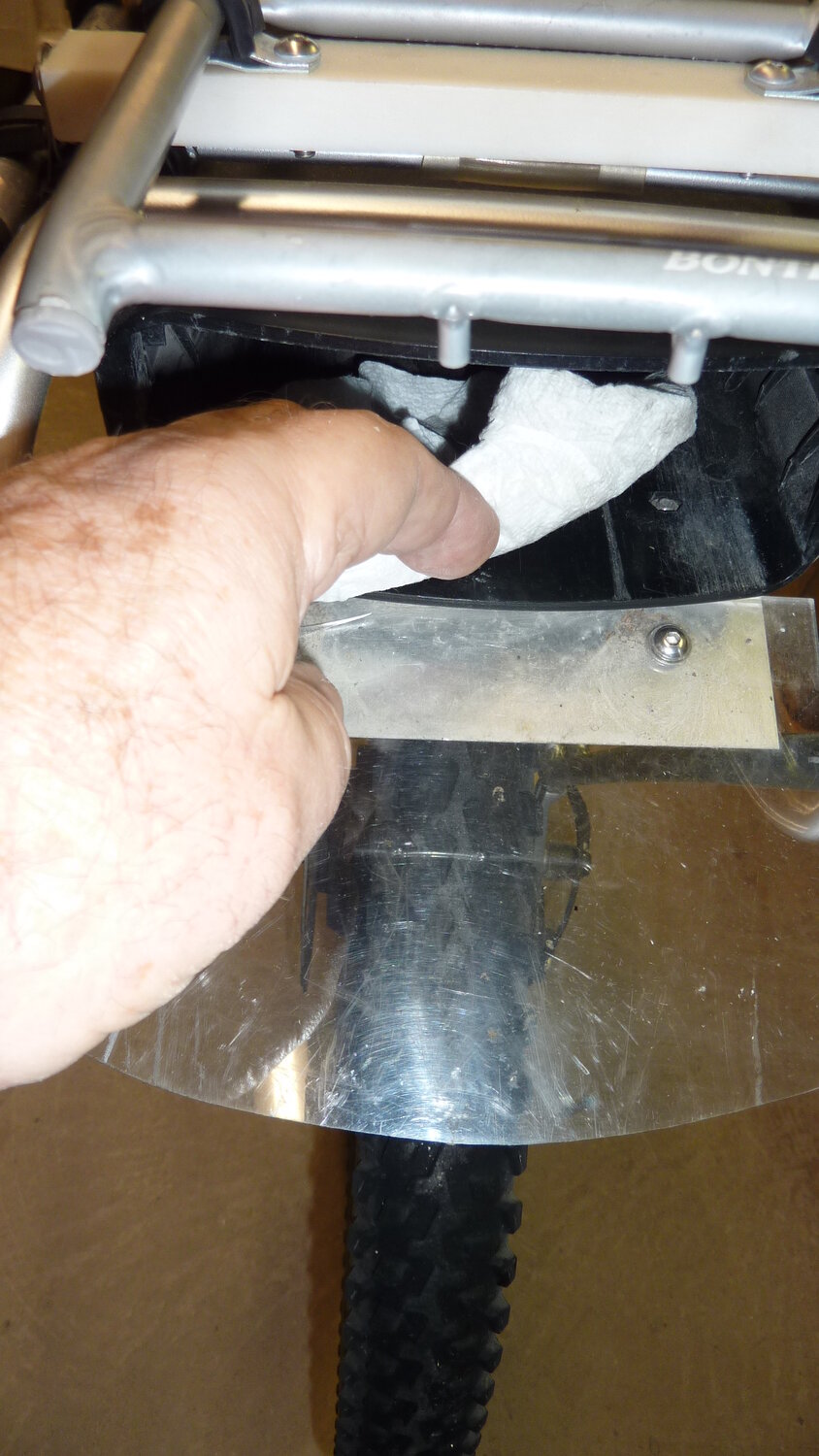

Keeping the battery & case clean is the trick. I ride gravel trails and have a frequent problem with grit in the battery case. To help minimize this, I made a "mud flap" from a piece of poly carbonate sheet.
It easily attaches to the rear bolts of the battery case keeping most road dirt off the underside of the battery and out of the housing. For models with fenders, including the Latch, this flap may not offer much additional protection though.
View attachment 74542 View attachment 74543
View attachment 74545 View attachment 74547 View attachment 74548 View attachment 74546 View attachment 74549
