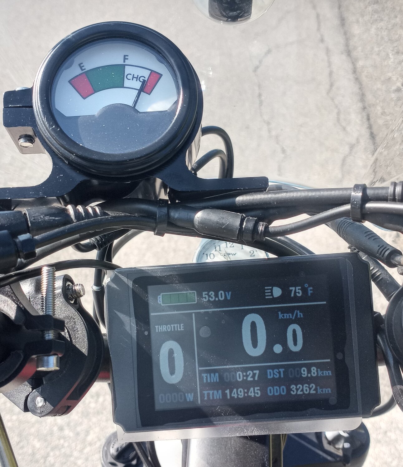

I am surprised, MY battery indicator on my Bafang BS01 shows just like a petrol gage and is really accurate, I carry a spare battery on a longer run say over 20 miles just in case
MY battery indicator shows just like a petrol gage,..
Mine does too,..
A needle bouncing around has a lot more to say than a digital readout or bargraph,..

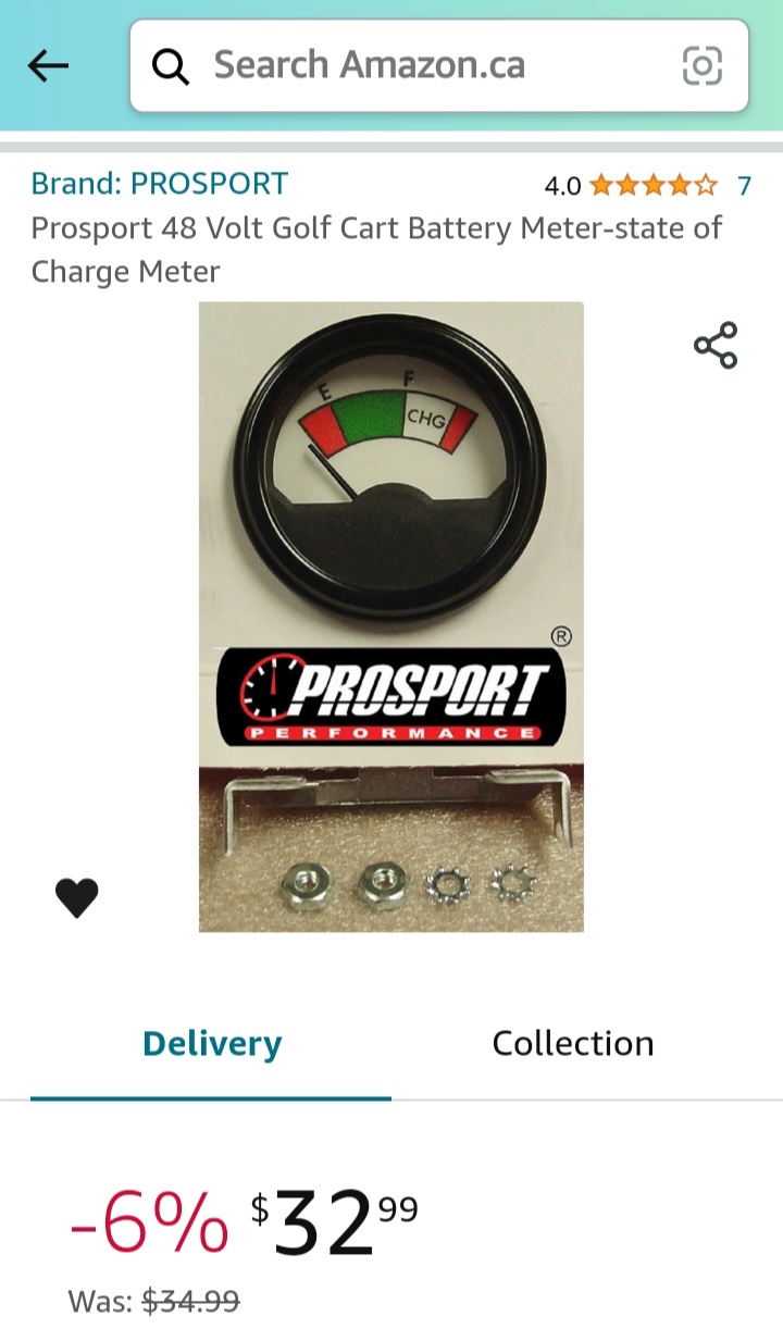

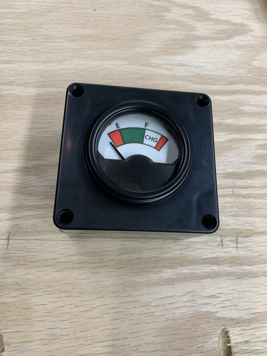

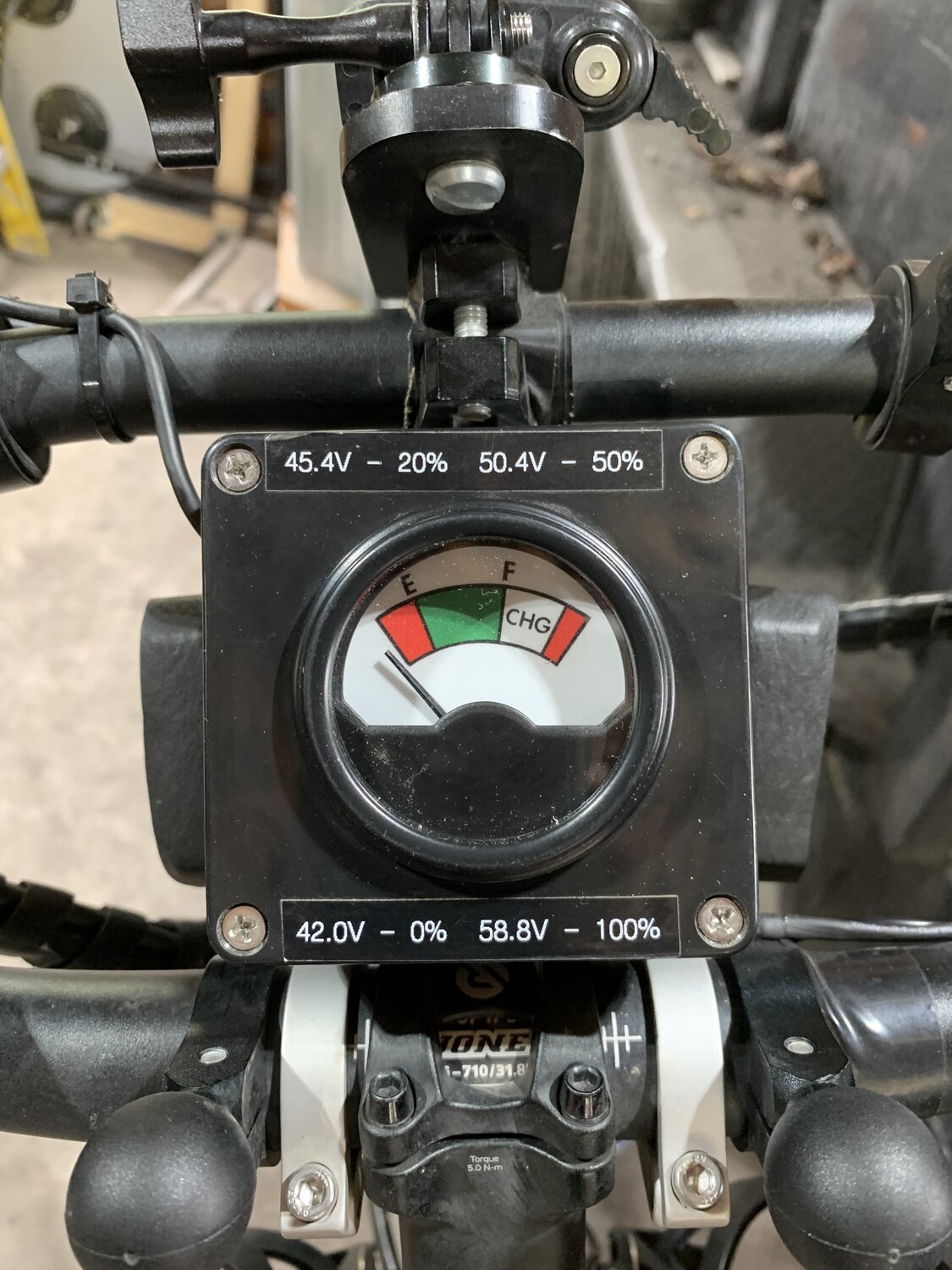

These are indeed good gauges for those who prefer an analog readout, and they are available for 36 & 48V systems. For 52V bikes, a 510 ohm resistor needs to be wired in series with the gauge to make it read correctly.

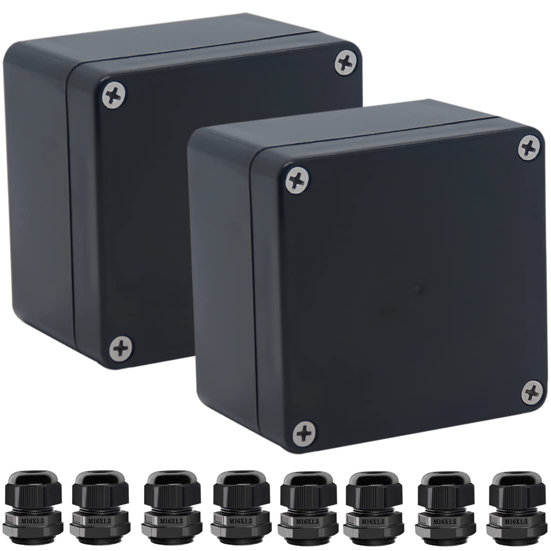

The gauge is designed to be panel mounted, which can be awkward to place on handlebars. Also, the face of the gauge is waterproof but the back isn't. I use these weatherproof ABS project boxes to mount mine:

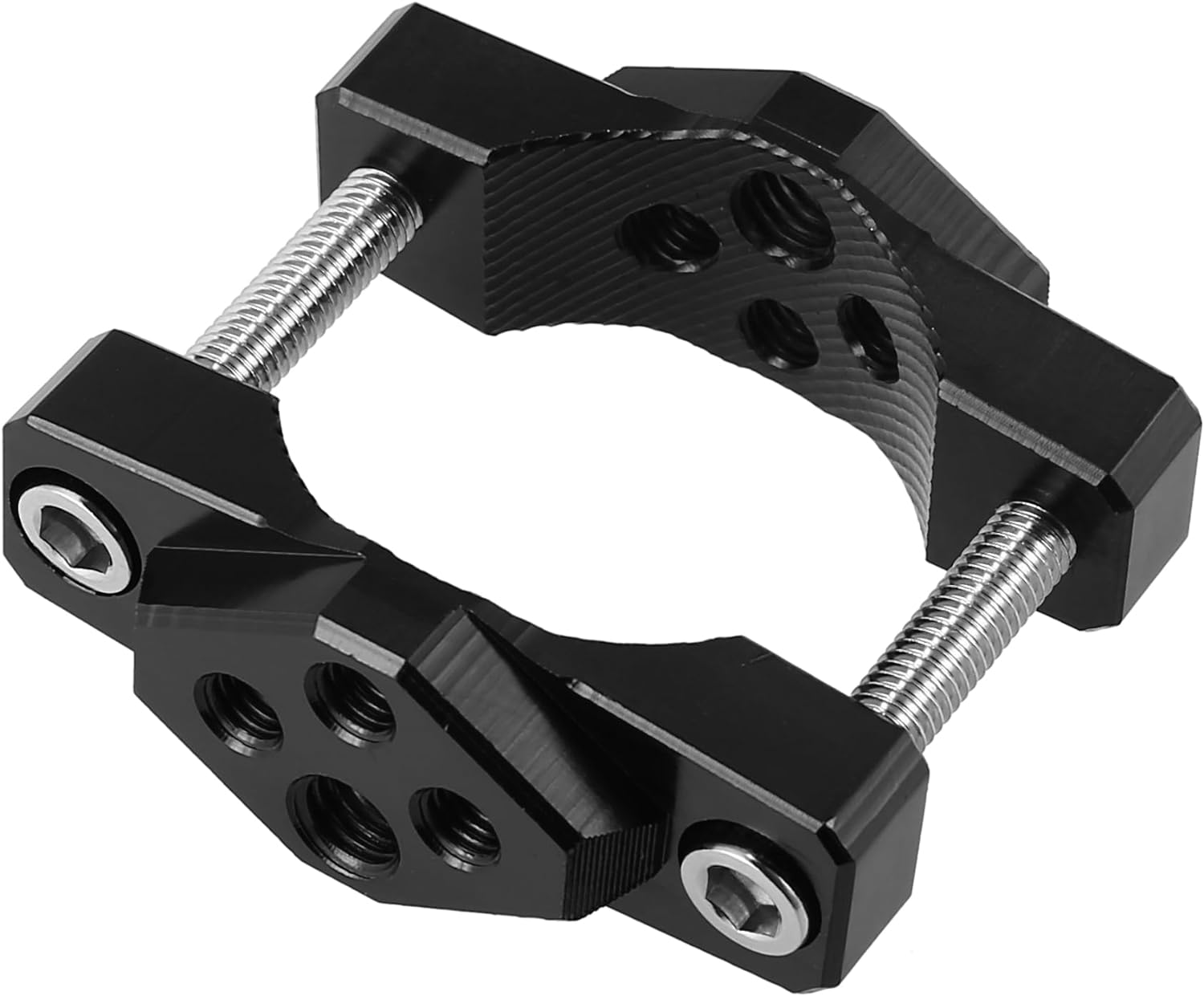

The box is easily mounted to the bars with this clamp:
