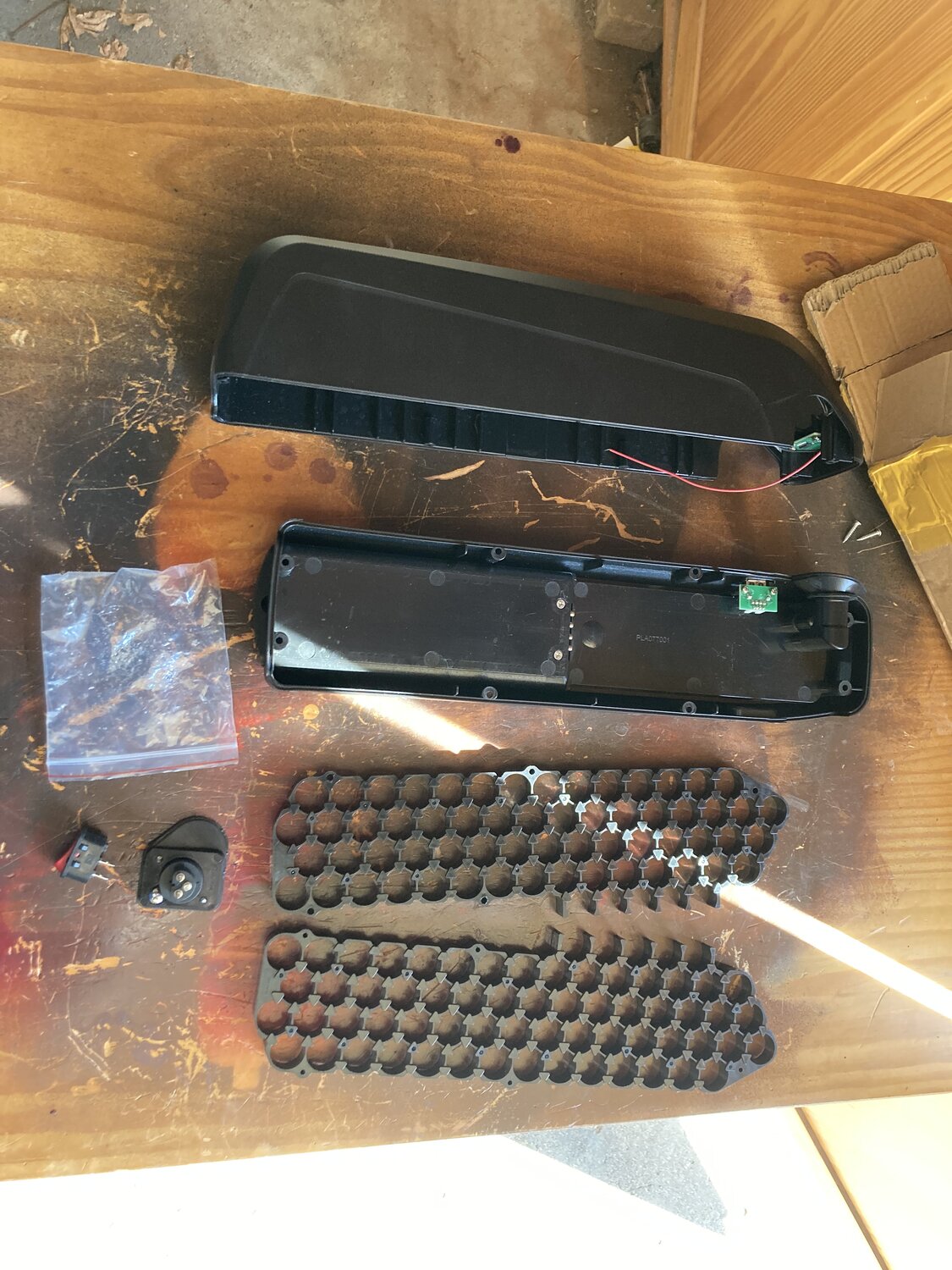

I dug one out of my battery parts.
65 cell max with cell holders.
