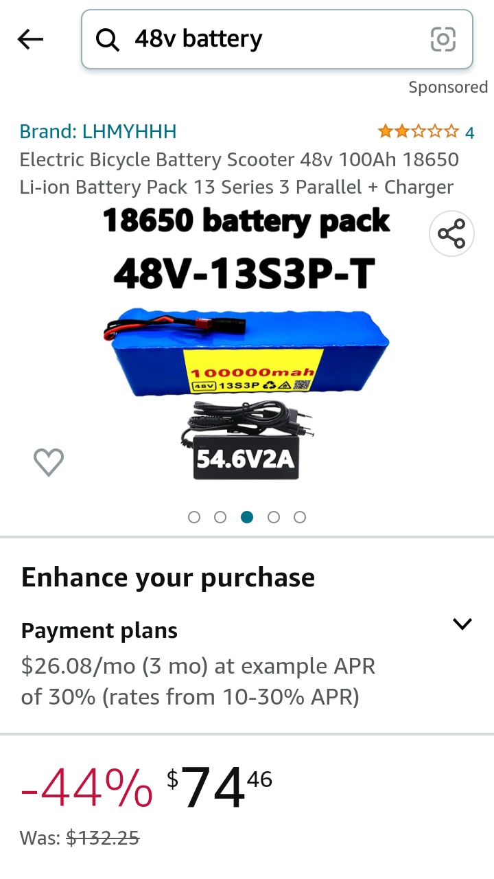

Here's a battery on Amazon for $75 CAD. It includes a charger.
It's a 100ah battery. Lol 😂

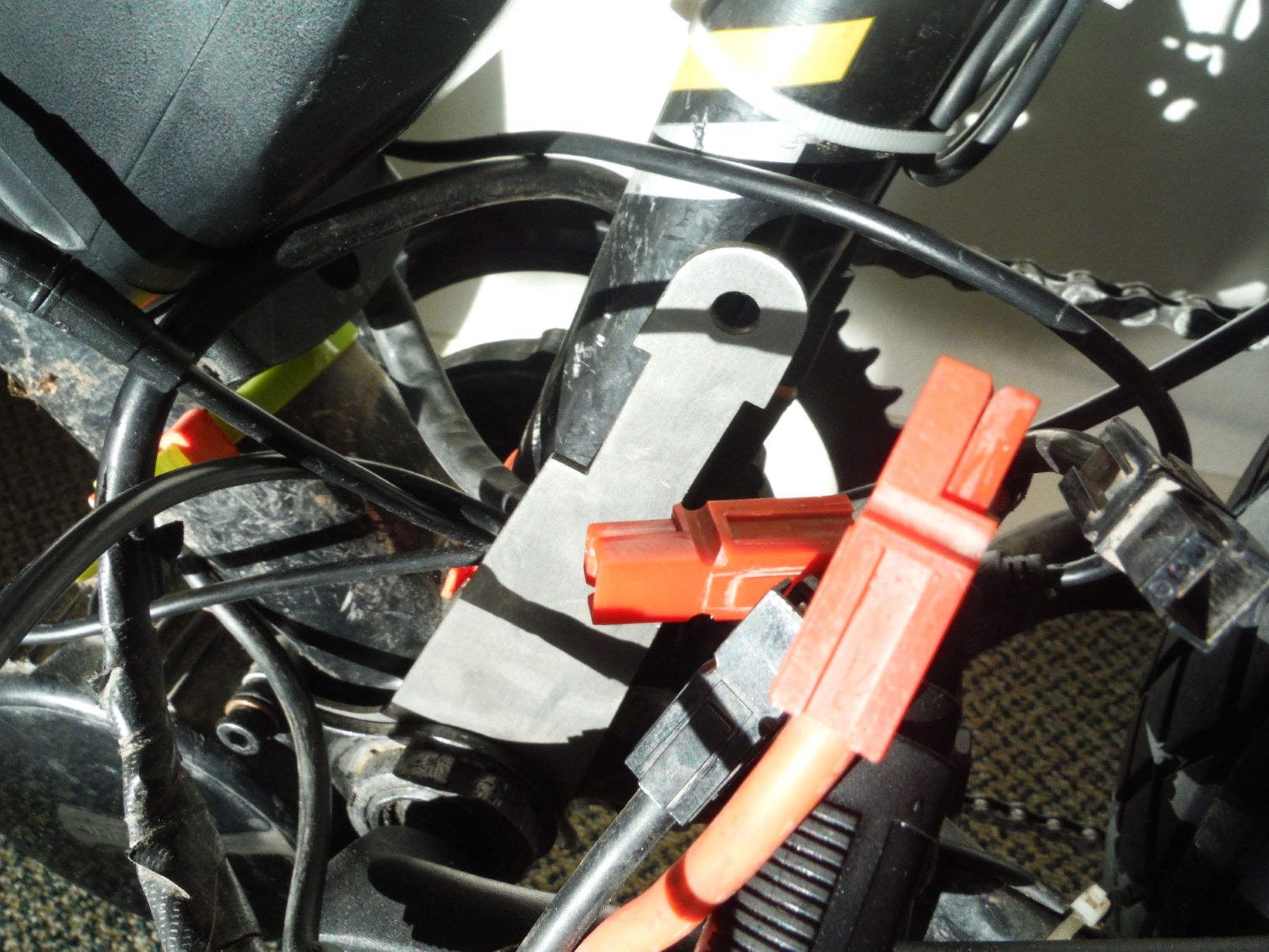

There was water ingress and the guy fully charged it after, hoping that would fix it. White crystals were growing out of the Hilong discharge port. That is the lowest part of the battery, where the water settled. The area around the battery's lock at the left top was open to the elements, that's where the water, rain, came in. The bike was non-functional. It was also a mess of wires, connectors, and zip ties. Sloppy backyard build. The brakes and shifting didn't work. This is what I did. It is a BBS02. Zoom the down tube and HB. The guy still owes me some money that was due over two weeks ago. It is his primary transportation and I gave him a break for a second payment. I will need to go to his employer.

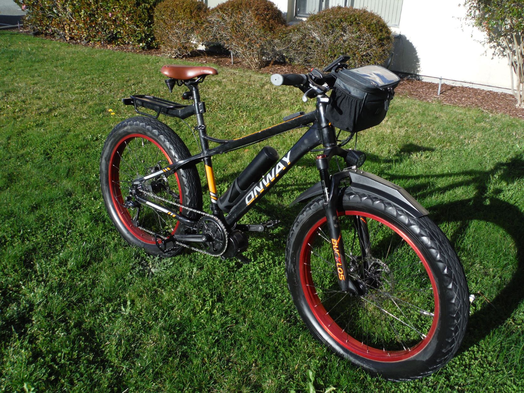

My Ariel Rider C class has a battery that mounts in front of the downtube, making its connected via prongs that slot into the receiver (iow, not a wire with a plug on the end). Occasionally it will cut out, either as I'm about to start a ride or while I'm riding. Disconnecting and re connecting the battery usually fixes the problem. It also helps to clean the electrodes with denatured alcohol.
