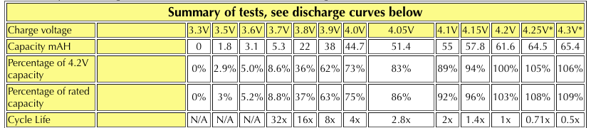

The following link has some information related to the effect of charge voltage on lithium battery cycle life.
http://www.powerstream.com/lithium-ion-charge-voltage.htm
The information in the link provides data and charge profiles from a small lithium battery. Also, an equation that describes the effect of charge voltage on battery cycle life is provided. The equation suggests a strong effect of decreased battery cycle life with increased charge voltage.
There is some lack of clarity in the article. For example, how battery cycle life is defined is not mentioned. It seems it must be a decreased capacity below some fixed amount. Also, no reference is provided for the equation and it is not clear whether the effect relates directly to the charge event or the cumulative time at a given charge. However, if the information were applicable to larger lithium batteries, it would seem to predict that a lithium battery would withstand ~8X more charge/discharge cycles when charged to ~63% compared to fully charged.
Table from article shown below:

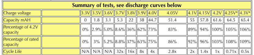

That is true. It's the only way Prius can guarantee 8 yr warranty.
If you go to Chevy Volt forum, you'll see lot more details about the SOC and battery life information. The battery on Chevy Volt is rated at 16.5 to 17Kwhr but usable capacity is only 10.5Kwhr (approx 61%) and owners who have driven the car over 200k+ miles report that they still get 40+ miles per charge.
So, the bottom line is get a ginormous battery ....
Good chart. The better ebike suppliers like Cellman EMV3 supplies battery chargers that are user adjustable for charge voltage. The chart shows that even a 90% charge doubles battery cycle life. Not a huge range penalty
