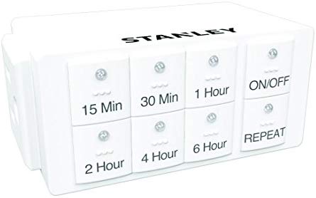

Buy a countdown timer. There are better, but this one costs just a few bucks, and when you know your battery and how long it takes to get a full charge, you can easily program this to stop charging when the battery reaches 80 or 90%. Simple steps can turn the need for an annual battery replacement into every 3 or 4 years.
Just use one of the auto off/on lamp timers you can buy at any Walmart or Walgreens equivalent. You shouldn't spend more than $5 on one of those and they should be everywhere.You have a link to that timer? Looks pretty useful.
EDIT: Just found it on Amazon Canada... $23 with free shipping, but it says "Usually ships within 1 to 3 months". Crazy!
(I'm currently using Siri to set a count-down timer to alert me when I should unplug the charger. But I am sometimes occupied with something else and don't get around to unplugging right away.)
