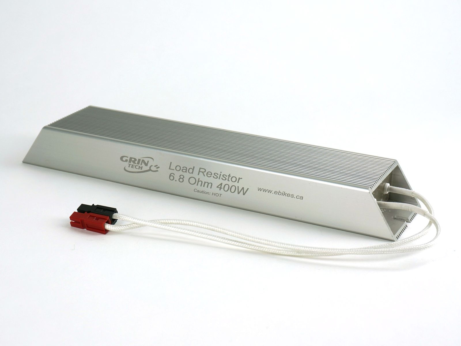

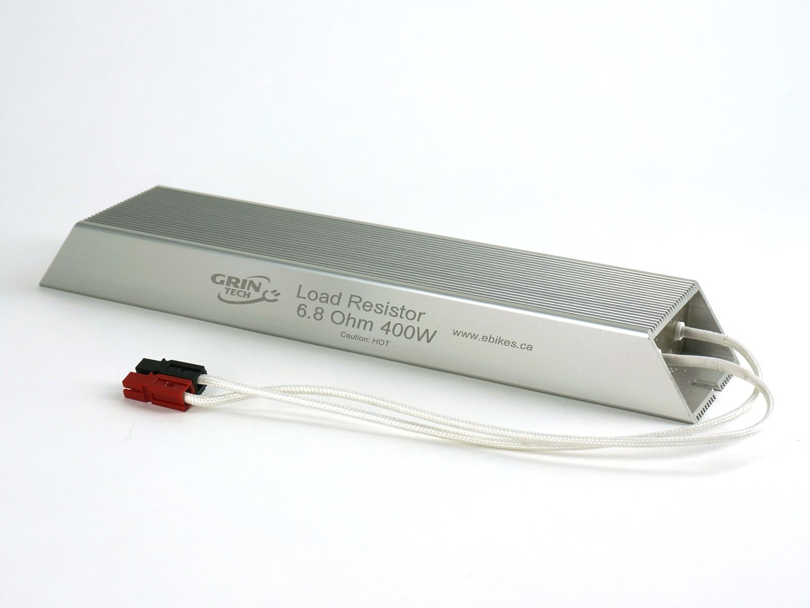

Something I bet just about nobody does: Use a simulated load to drain the pack back down if you zap up to 100% and then change your plans and bail on your ride. I have two of these I can hook into parallel that create about a 14a peak drain together, or just one for about 7a. Hook it up to a cheapie watt meter and when its back down to 55v or so job done.
You could just use a 1,500 watt heat gun and a volt meter. The blower might be a problem though. Use the toaster. Probably should say that tongue and cheek.

Its not something I do often. I'm riding for transportation but still have a car, and there were enough times when I was planning to ride into work and then all of a sudden something comes up and I have to haul ass and drive in. Once every few months but its something I am glad to have when I need it. I used to just leave a plain watt meter plugged in and let it drop maybe a half volt in a day from the illumination on the display.
The rig @6zfshdb posted is nice. I like the timer in particular. I need to work that into mine. The 7a draw of the Grin product is about what I'd do riding the bike on assist with no throttle.
