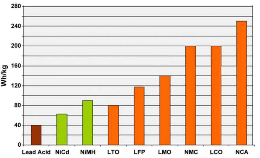

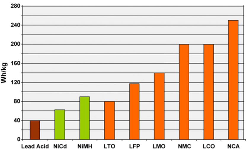

I guess our perception of what is new, is different then, we have different compositions and sizes and smart batteries with tech chips in them that communicate with both the chargers and tools which also now have chips in them too. I mentioned only 3 different compositions, but there is way more than that now, see chart.

If you think all these are the same, then I will respectfully agree to disagree.
Your chart is deceiving and actually missing one. Your chart shows over a 6 fold increase in the last 100 years. That does not actually happen in practice. Go weight one of your new batteries and divide the total Wh by the weight and see where you are on the chart. Now do the same for a lead acid car battery. You will find the chart has a bit of built in bias going on. What is missing is Lithium Sulfur. Its been around since the late 2000's and more recently commercially viable in light weight high power applications but still suffers from low charge cycles. Max out there is pushing 400 Wh/Kg NCA has never been really commercially viable at the power density. Lithium Sulfur is promising after 15 years of development.
