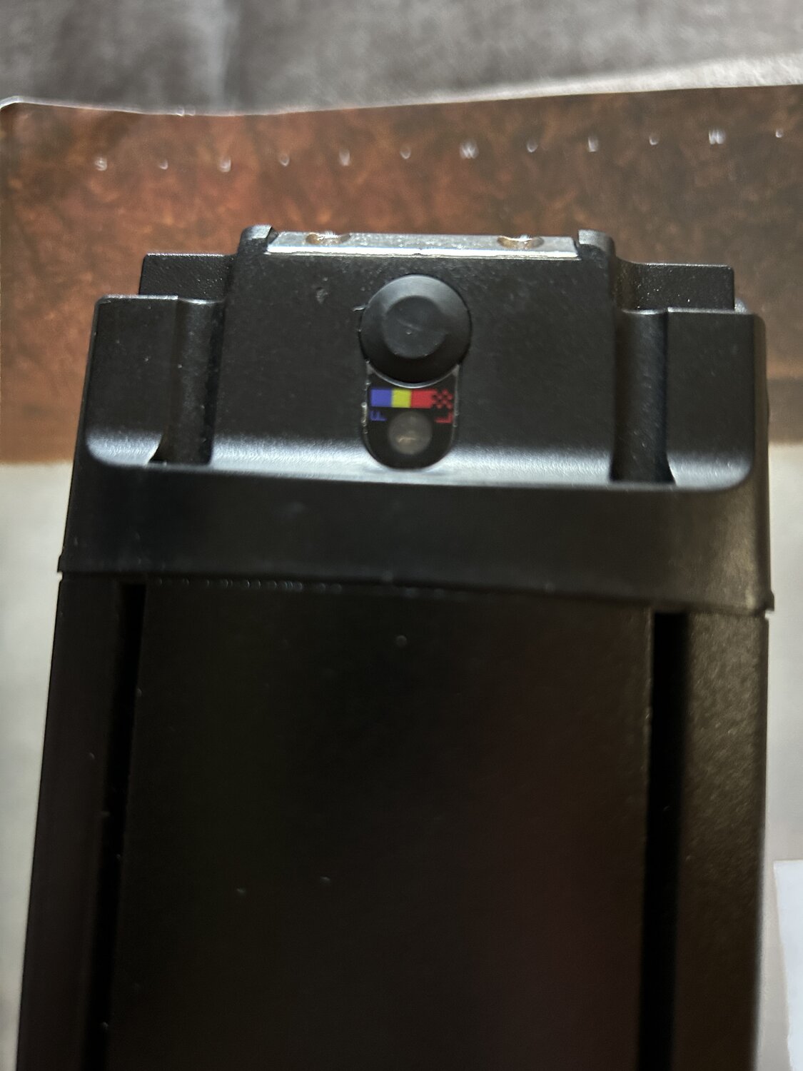

Is this the switch you are referring to?
That's probably the button to check the battery voltage status. They are not precise, but red means discharged or close to it.

I have never heard or had a spark coming out or going into the bike.
Manual says to turn battery to OFF position!?!?
Outside of the indicator I SEE no switch and have examined the battery thoroughly!

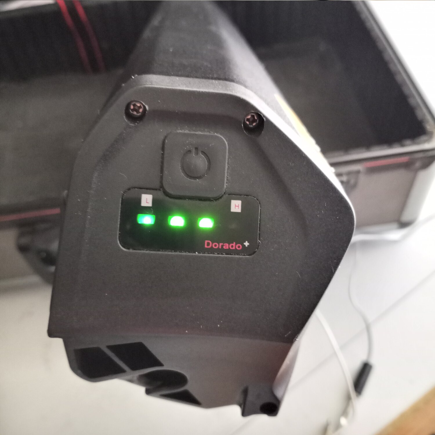

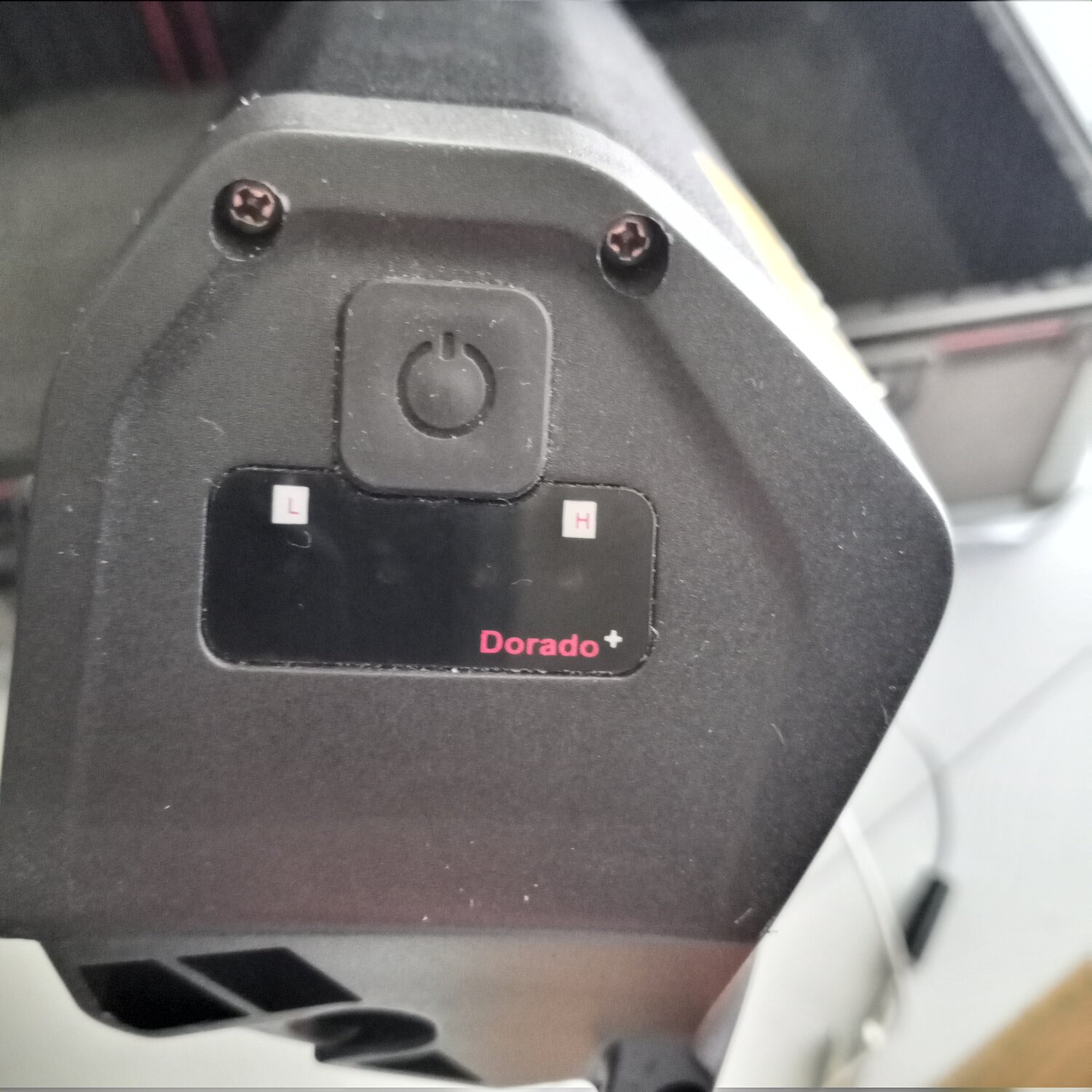

I have a similar button on my battery.
When I push the button, the battery turns on, I can see the charge level, and the battery output turns on.
I am supposed to wait for the battery to turn off before removing it from the bike.
Once the battery level indicator turns off, the battery goes to sleep and the battery's output is turned off so it doesn't spark when it is removed or installed on the bike.
Your battery may work in a similar way and shut off the output when the battery is "off". I would assume that when the battery display is off, the battery is sleeping.
I have a second battery and the battery's output is always on. It doesn't go to sleep.

As far as @leehop71 is concerned, I would assume that once the display on his battery turns off, the battery has turned off.
My battery just waits a few seconds then the display turns off and my battery goes to sleep.
My second battery doesn't go to sleep, but I haven't noticed any sparking removing or installing it on my bike.
