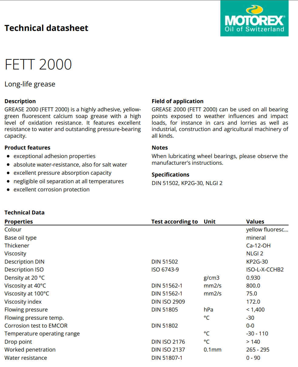

I will get a new controller for my G510. Then I will re-grease the motor. I have "Fett 2000" from Motorex here. Do you think i can use that? Here the datasheet
