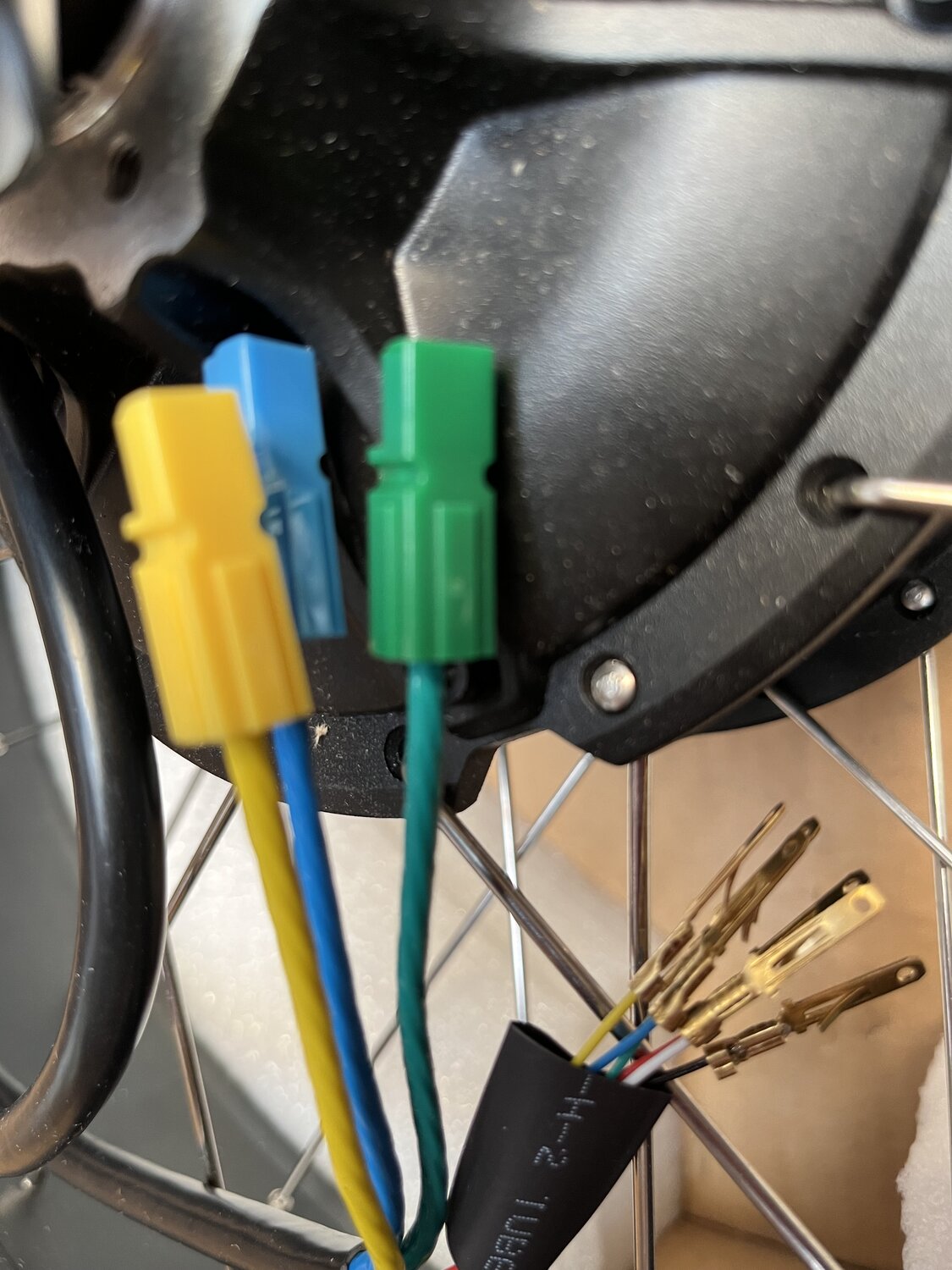

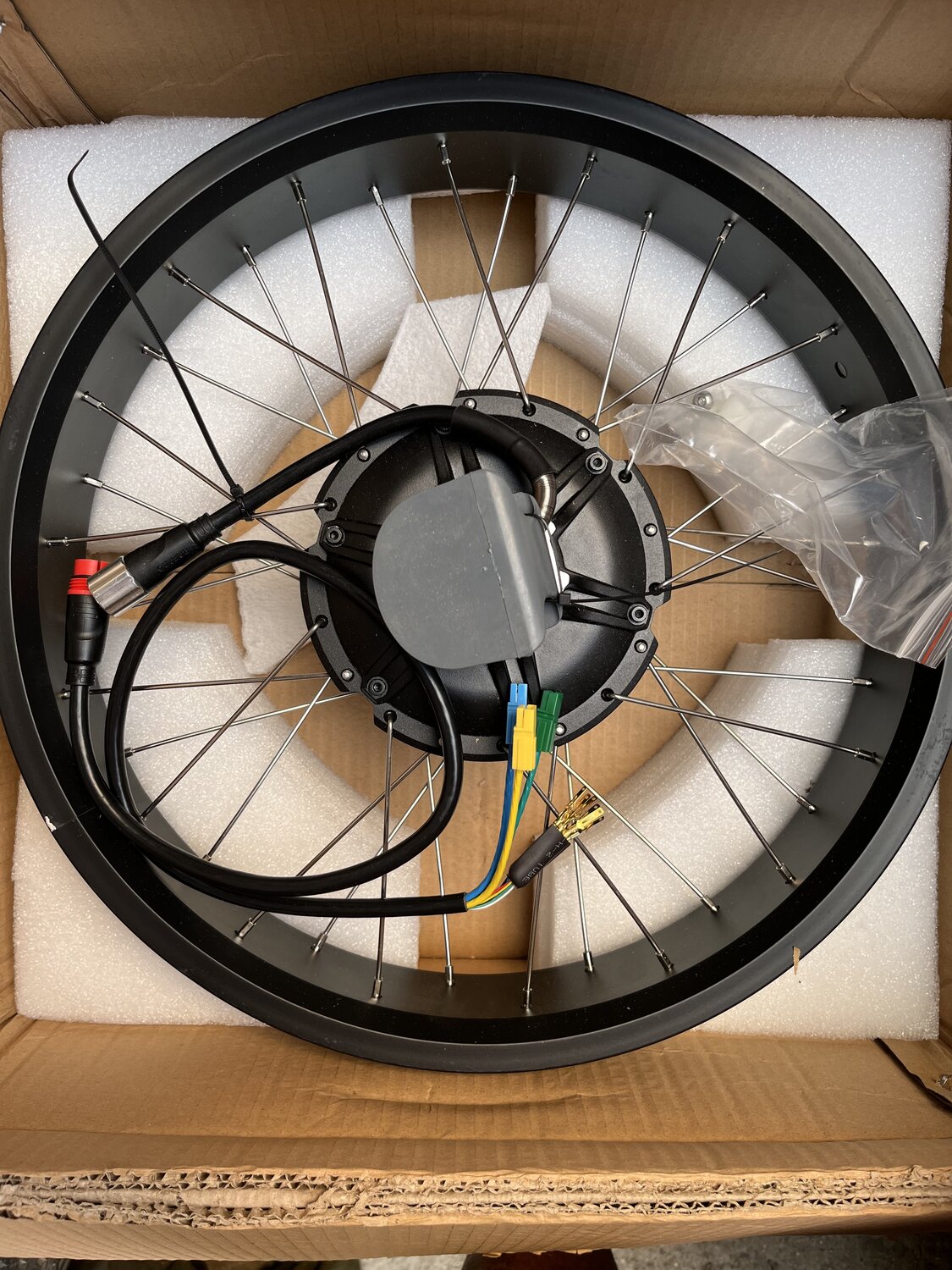

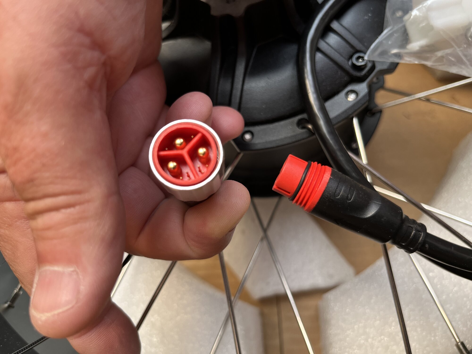

Just got a Bafang G063 1000 watt motor with the new type red connector. For my Rad Mini 4 . Can anyone suggest a suitable controller with display to use with this.

Easy way is to use common Rad KT 35A mod by changing the controller side motor cable into L1122. Not too hard.

Agreed. I have not seen any difference in G062/G063 other than the connector. As far as I know the 1122 connector is worse than the L1019, all of the cables I have seen are only 2.5mm2 phase wires, no better than the G062? Seems the G062 is better than the G063, plus has better aftermarket support. But im staying tuned.
Also agreed with JTK- what I do is use any controller, I buy a 6 pin hall box with pigtails for like $3, and a L1019 or 1122 cable, solder the phase wires to the phase wires of the controller, and the 5-6 sensor wires to the 6 pigtail wires of the hall sensor. It will turn any controller into a 1122 compatible controller.
