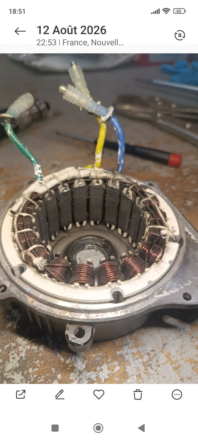

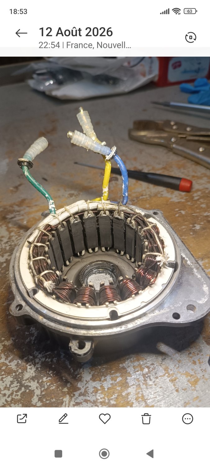

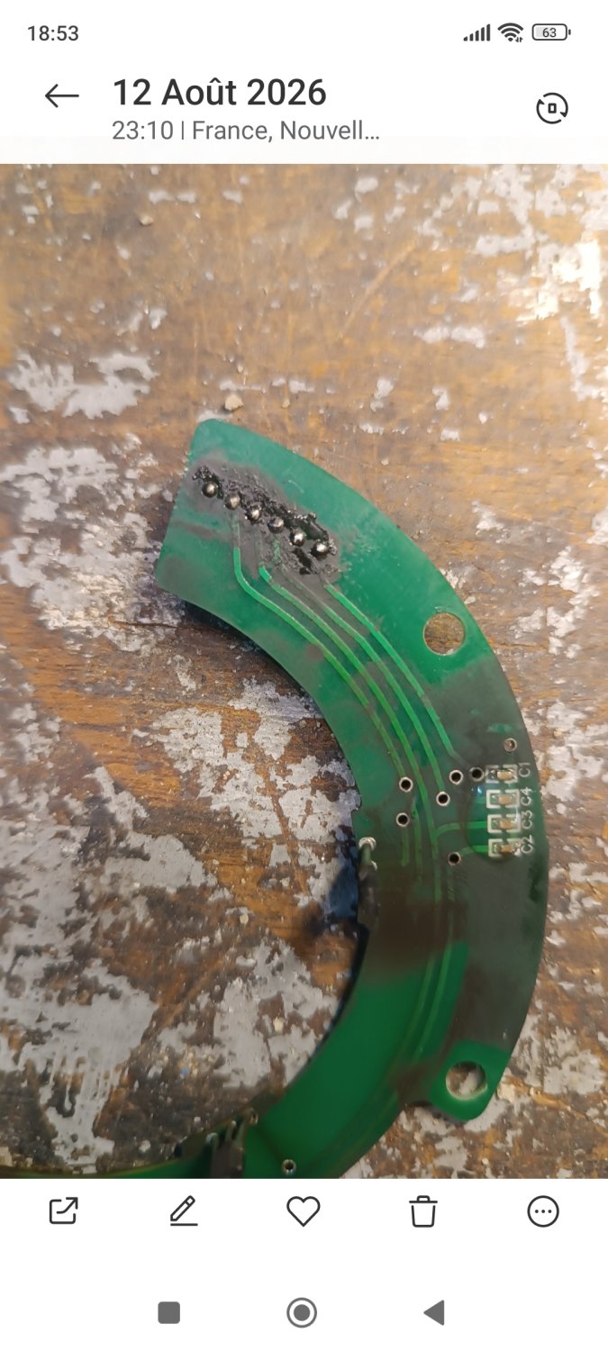

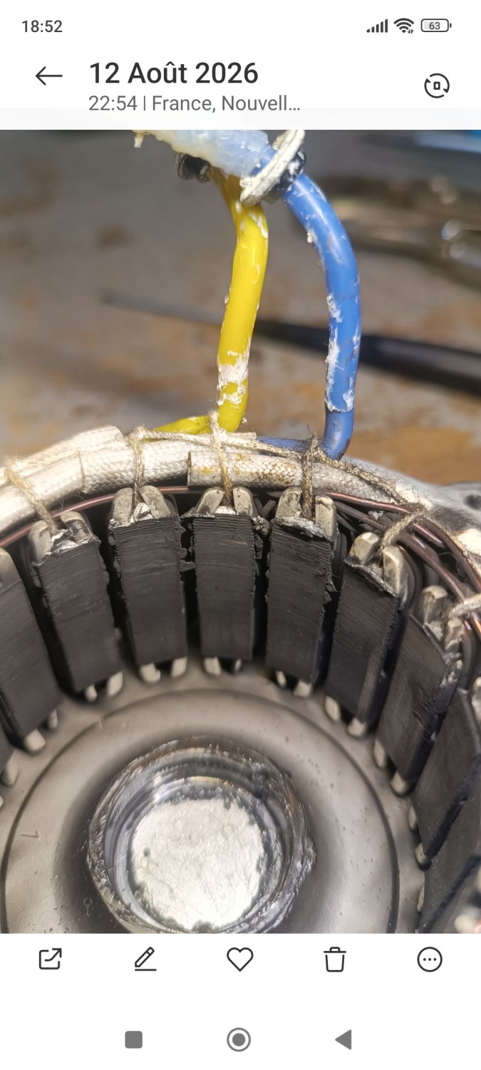

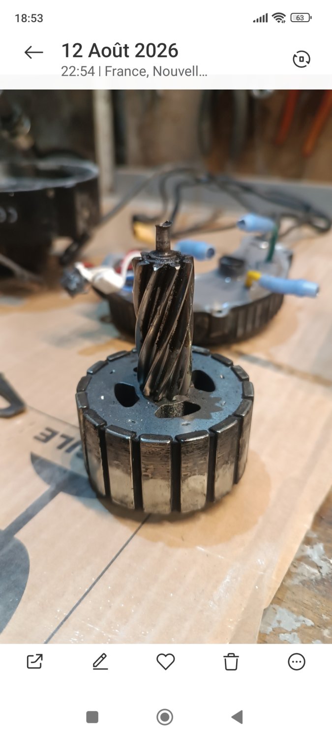

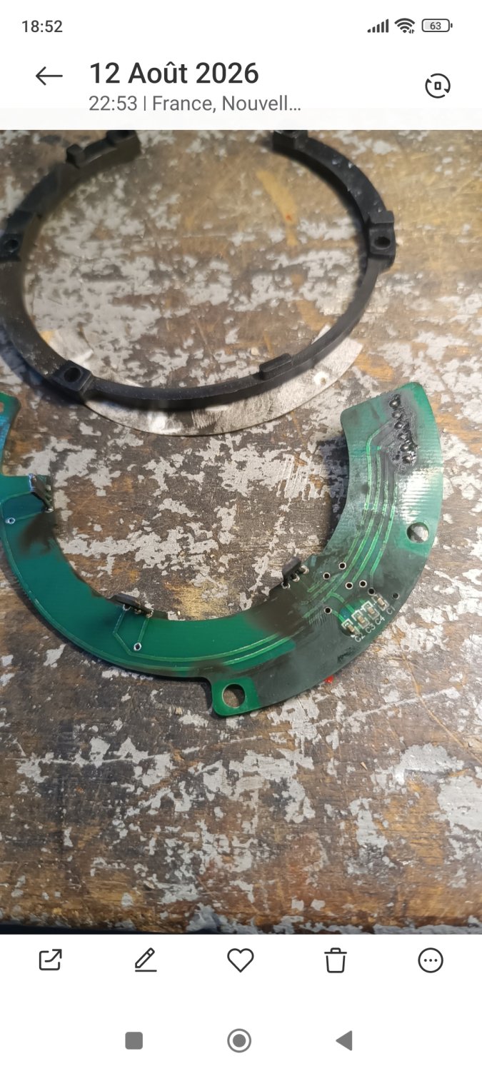

Bonjour, mon moteur bafang bbs02 ne fonctionne plus.

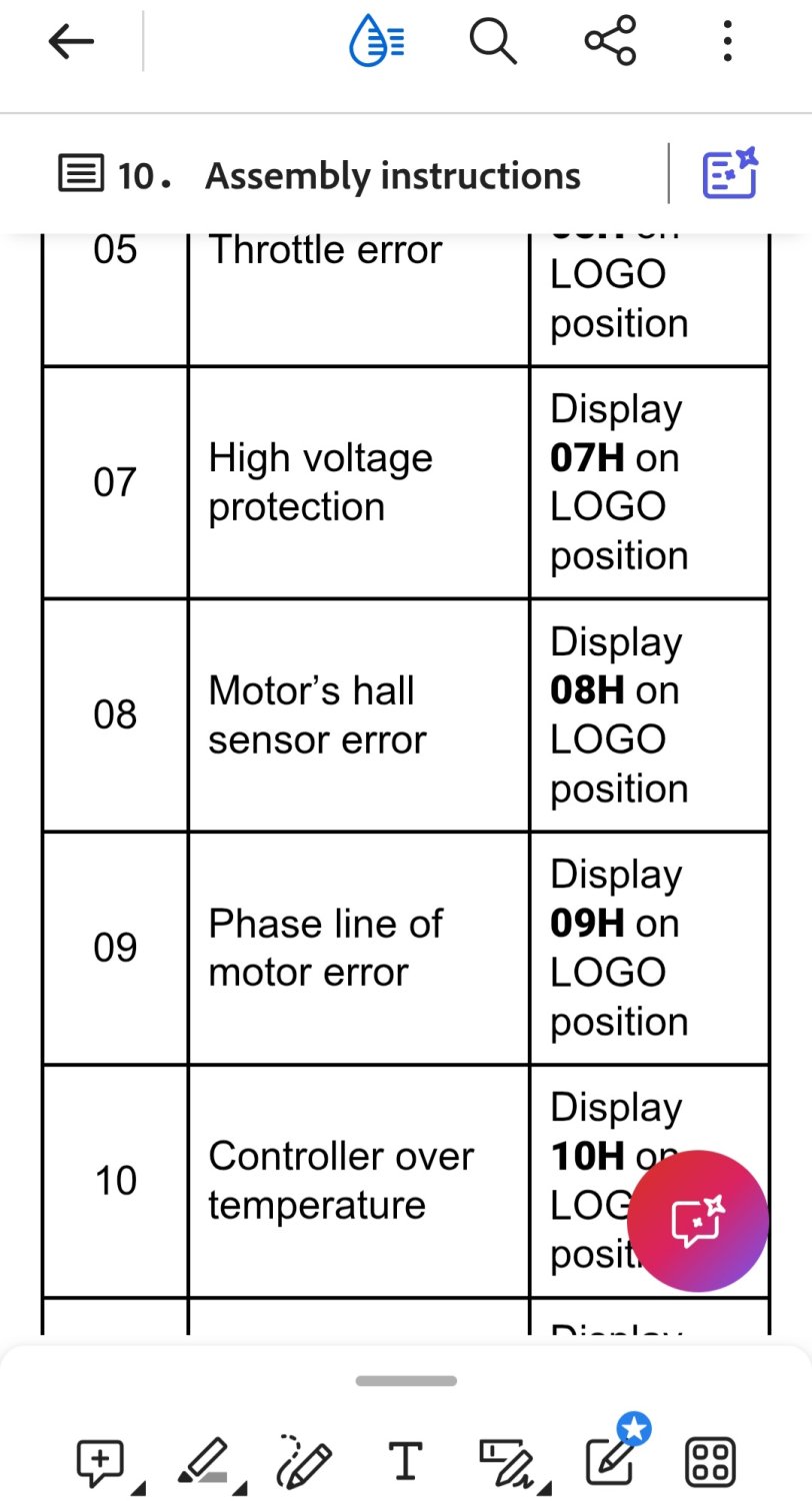

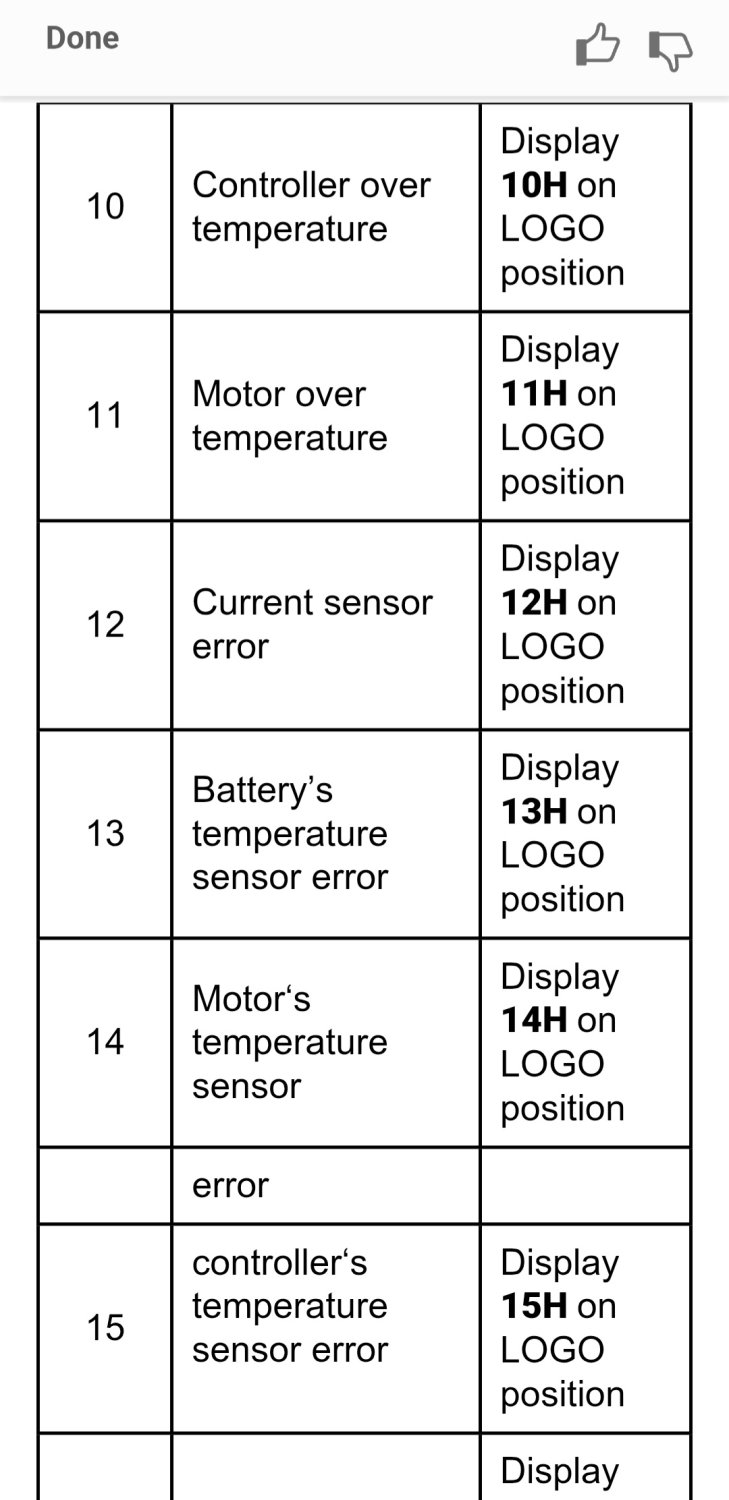

Il a eu très chaud, et j'ai un code erreur 08h.
Je joins à ce message les photos.
Je ne suis pas fort en électricité, et je voudrais des conseils afin de pouvoir tester avec un multimètre le stator, la carte hall etc...
Merci d'avance pour vos conseils.
Amicalement

Your PCB looks burnt, but the motor itself may be OK?
I personally would take the $12 gamble on a new PCB
Ps,.. I don’t speak French even though I'm from Canada.
You'll have to translate this yourself. 🤣
You may have overheated your motor 🧲's which can cause them to lose magnesium and motor efficiency.
I personally would still take the $12 gamble and try a new PCB before throwing it in the garbage.
Hello, my Bafang BBS02 motor has stopped working.
It got very hot, and I am getting error code 08h.
I have attached photos to this message.
I am not very knowledgeable about electronics, and I would like some advice on how to test the stator, the Hall sensor board, etc., using a multimeter.
Thanks in advance for your advice.
Best regards.
Replace the circuit board and see if it works. Motor wires looked burned but may still be good, You can test the Hall sensors, but it is too much trouble if you don't know electronics. If the new board didn't work, then the motor windings are burnt,
Remplacez la carte électronique et voyez si cela fonctionne. Les fils du moteur semblaient brûlés, mais ils sont peut-être encore bons.. Vous pouvez tester les capteurs à effet Hall, mais c'est trop compliqué si vous n'y connaissez rien en électronique. Si la nouvelle carte ne fonctionne pas, c'est que les enroulements du moteur sont grillés.

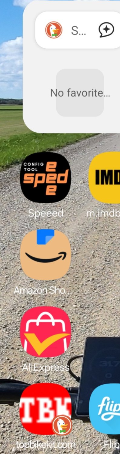

I finally added Top Bike Kit to my home-screen, along with Amazon and Aliexpress.
More than half of what I buy is for my e-bike. Top Bike Kit is really well organized and easy to navigate.
And a better price too.
