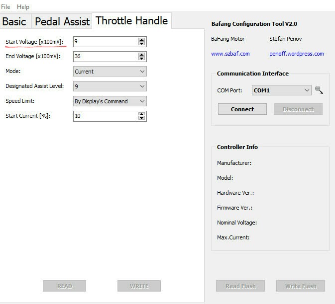

04 error could be that the controller Throttle Start Voltage is not set properly. Possibly set too low.
