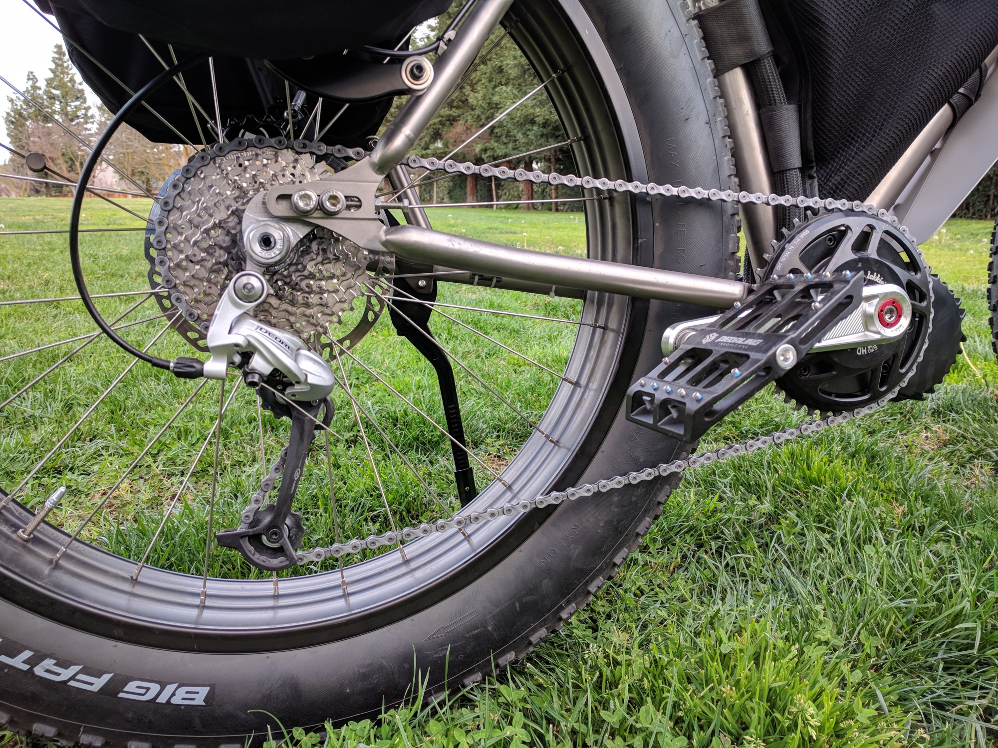

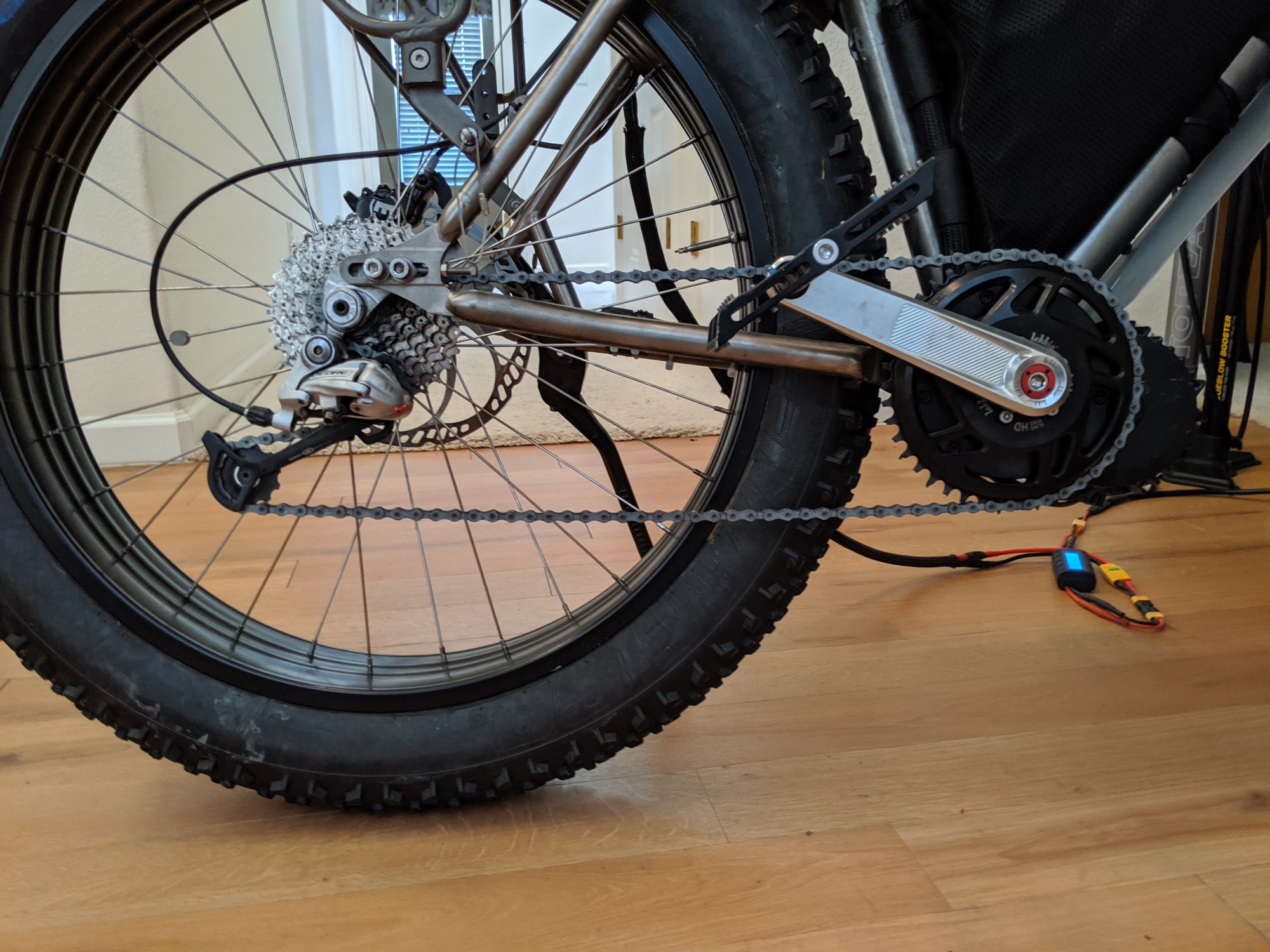

Might be stating the obvious here but how is your chain length? When in the small cogs there is the least amount of tension on the derailleur and a slack chain can cause skipping, maybe taking out a link or 2 will solve the issue, as long as there are still enough to accommodate the big ring that is.
This was my first thought. Having one link too many on one of my builds caused this exact problem. Taking two out solved the problem forever. Here's why its an issue on the smaller cogs: The derailleur cage is no longer pulling the chain taut enough and even though it looks reasonably tight, its not.
Its either that or its chain alignment, or something is worn. More on that at bottom.
This length of chain looks OK, but the derailleur needs some tension on the cage and there isn't any here. In the smallest cog, the derailleur skipped only when it was wet. If you carefully compare this pic to the 'after' pic on the small cog below you can see just a hair of sag top and bottom and that is where I screwed up.

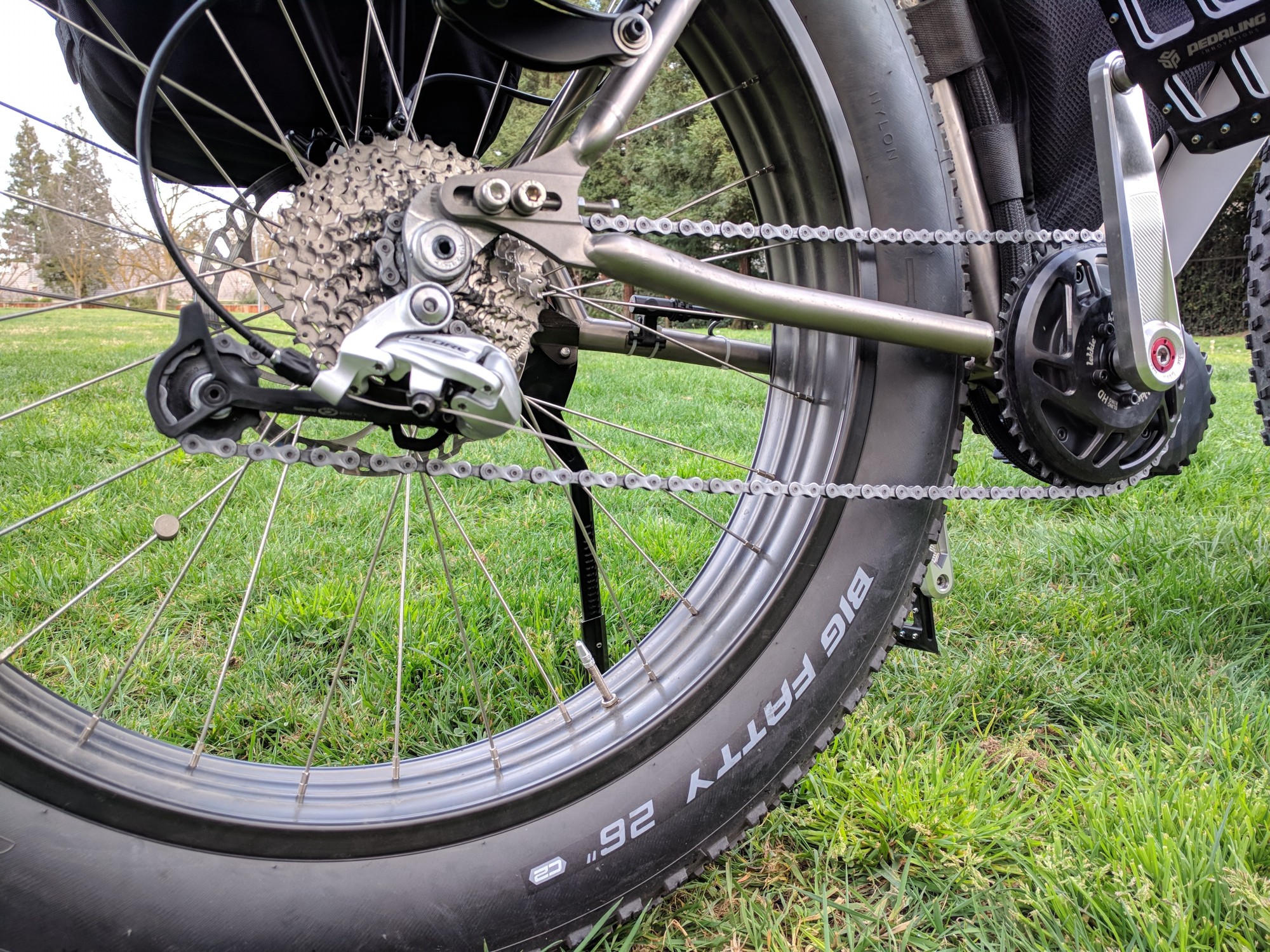

This is what the chain looked like on the biggest cog. This is perfect 1x drivetrain chain length. The top pulley is just a hair forward of the bottom one. The cage is not stretched forward. In the first picture, I let the cage do its job which is wrap chain (just a little too well).

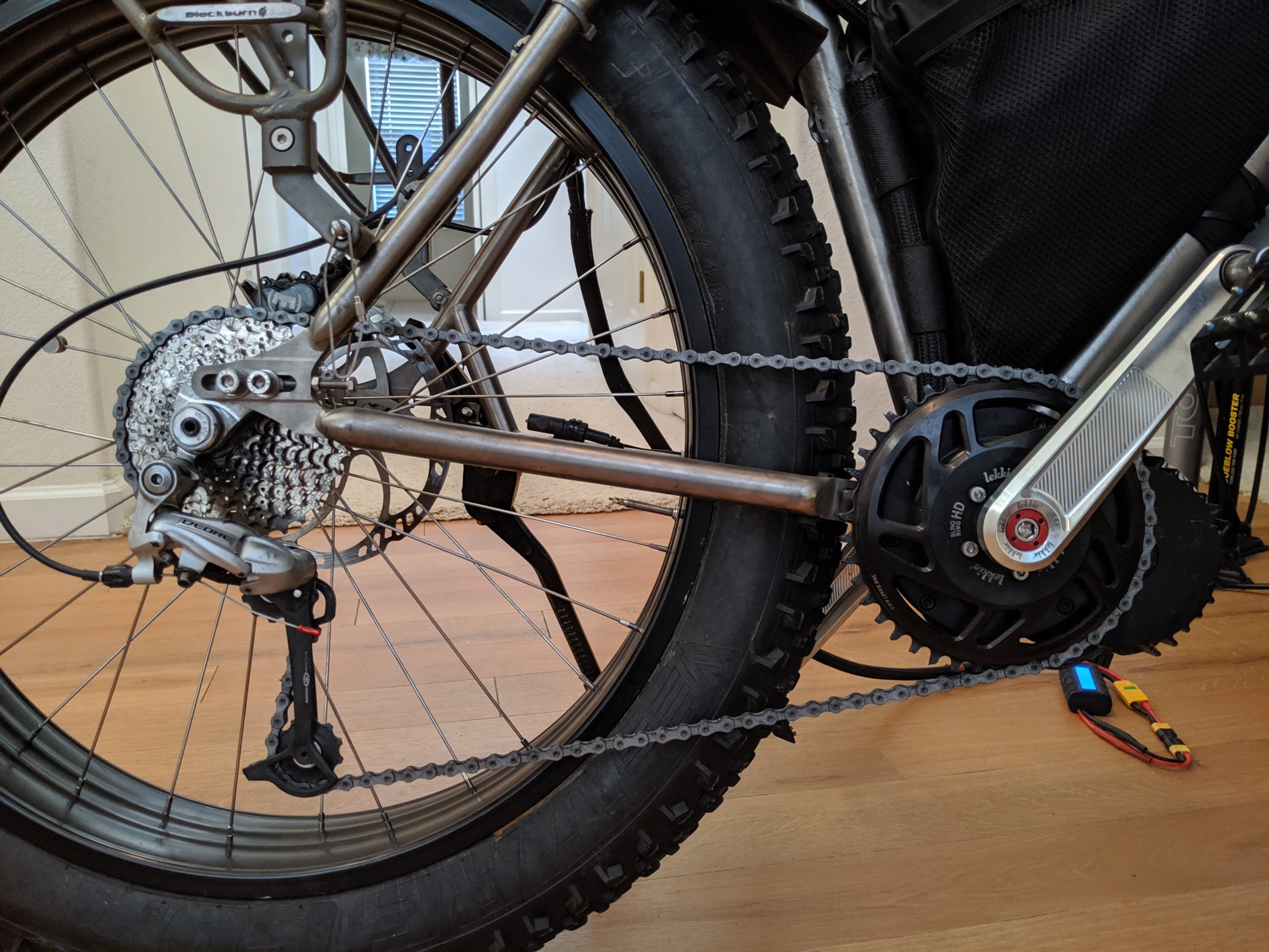

Here is the After shot when I took out two links (a narrow one and a wide one... the least I could remove). Big cog is not perfect but its still good. Visually there is very little difference between the two small-cog pics if you are just looking at the chain.
