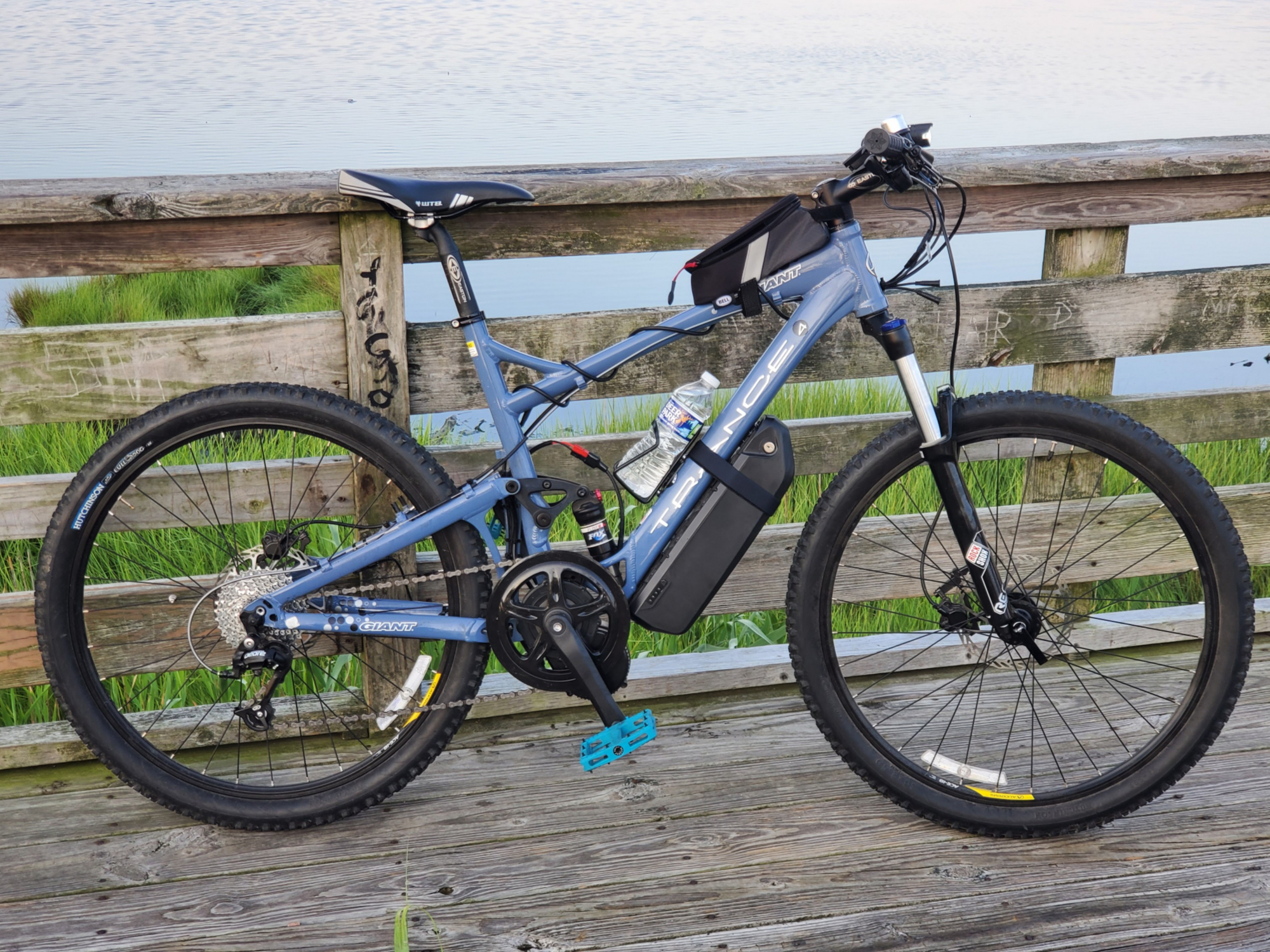

@Coachman , you have a similar commute to work as I do. On bike, my commute to work is 22.6 miles one way. Flat around here with "hills". Majority of commute is on rail trail, the rest through neighborhoods/city roads.
On my acoustic bike, I can average around 14 mph. However, if I did that commute on my acoustic bike and averaged 14 mph, I'd come into work a hot sweaty useless mess lol. So I built an ebike for the purpose of the commute (and because it's fun haha). I put a BBS02 kit (750 watts) on one of my bikes (2005 Giant Trance). It has a smallish battery, 48v 12.8 amp hours, so I have to keep that in mind with range. Given that, I will average about 17 mph on the converted bike at PAS level 4 (out of 9). It takes an hour and twenty minutes to commute one way. And I come into work without sweating like a hog haha. I'd like to get a bigger battery so I can bump up the assist level to average 20-22 mph and shorten the commute time.
I have a smaller chainring on order (a lekkie 40T ring). A 48T is currently on there now. I'm thinking with the smaller chainring, I might get more battery range as the motor doesn't have to work as hard to get up to speed. It'll probably put less wear on the cassette too - sometimes I get a lot of chain skipping as the motor tries to get up to speed from a dead stop (I need to install the gear sensor still too).

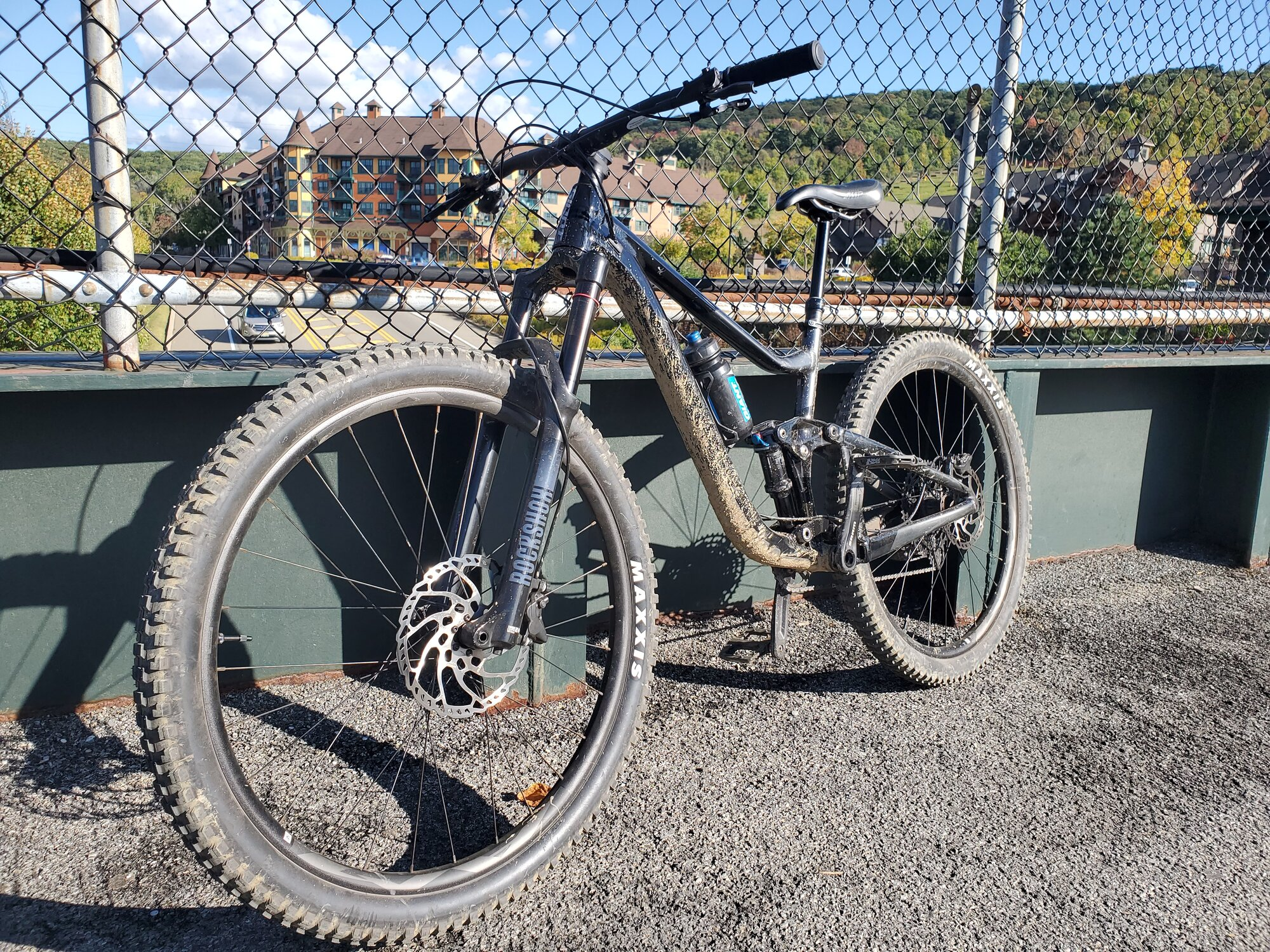

I was contemplating converting my fun bike, but I'm keeping this acoustic because this is my trail and downhill bike (2021 Giant Trance X 29)

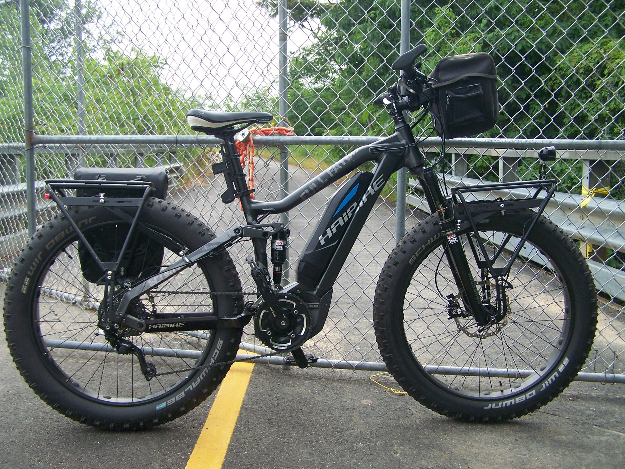

Haibike Full FatSix, which is a close enough cousin to your Pugs for this discussion. I don't commute to work, thus don't have a rigid time slot I have to adhere to; so my rides, which average 20 miles long and upwards, averages anywhere from 11 to 14 mph. This speed range gives me the most economy per full battery charge. At those speeds, I can consistently get 40 miles on level ground, asphalt riding; provided there is no strong head wind. I have found that going above 15 puts a crimp in battery range. And at around 19-20 mph, battery economy will be dismal; figure 20 miles range or so on a fully charged battery....
Installed a PearTune speed chip in the Yamaha edrive system about August, 2020. Observations: In top, peak riding condition, mid-summer, on my 20 mile riding circuit, going full-out, got me an average riding speed of about 16.7 mph. Mind you, that is riding a good portion of the course at 19-20 mph. At 63, I do not have the power or endurace of when I was 23, but still, I'm of the conclusion that only peak performing cyclists will be able to manage a straight through 20 mph and above average speed.
I was able to hit 30 mph for a few dozen or so yards with the H-bike and again, to keep that speed with this 250watt motor would require an Olympic cyclist style conditioning.
When hitting 30, the thing that concerned me was the tires, tubes and rims. I don't believe these non-DOT Schwalbe Jumbo Jim 4.0's at 120tpi using 25 psi in the tubes are made for that kind of sustained performance over miles upon miles.
This is all just one person's personal opinion, based upon my own conditioning and the bike I am riding.

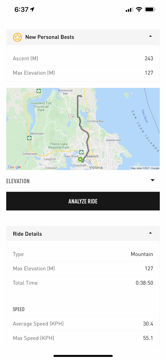

Here are three variations on my work commute (Fast/Slow/Hilly). ~20kms each way give or take the route that day. The fast run is on highway shoulder. The slow run is mixed-use city trails. The third option is my "Workout" route with lots of undulating hills and a couple of good climbs. Al three are very fast by acoustic standards, and unsustainable unless you are very fit. I find I mix in well with the serious road riders on the flats, but I leave them behind on any sort of incline or hill. But around town for shorter recreational rides, I seldom exceed 25km/h (15mph). Just my own experience...
View attachment 93781View attachment 93782View attachment 93783
This is very useful, thank you!
