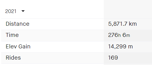

@Coachman:
I don't use my e-bikes for commuting, only for health reasons. Let us assume neither of my e-bikes has a speed limiter, and my legs are my speed limiter, same as the necessity to conserve battery charge limits my speed.
Said the above, my average speed on e-bikes in 2021 has been same the 13 mph as yours. However:
  • I rode my bikes for 169 times and you rode your traditional bike for 57 times in 2021;
  • I have covered 3,649 miles and you've ridden for 1,280 mi;
  • I spent 280% saddle time compared to you.
Thoughts?

Well, if you want to average > 20mph then your best choice is a class 3 ebike. With a class 1, you will not be using the motor much at all. Honestly, I believe you are probably fit enough to be able to average close to 20 mph on a non-electric road bike with dropbars if you can average 13 mph on a fat bike.
I am not sure what Stefan's point was and English is not his first language. However, Stefan has a lot of experience with very long distance rides on ebikes and can give good advice for extending the range of your battery.

@Coachman:
Thoughts?

My point is that "with an e-bike you ride more often, and cover bigger distances than on a traditional bike". The third factor is the higher speed (not my case!) High cruising speed is the outcome of the combined rider's leg power and of the battery charge consumption. Now, some figures to illustrate the point. Let me talk about a Class 3, mid-motor e-bike such as Vado 5.0, which is equipped with 600 Wh battery and weighs some 53 lb.
Approximately a year ago, I made a controlled ride in 100% Turbo mode. The distance covered was 26 miles. The net ride time was 1 h 28 minutes, and average speed was 18.2 mph. I can't remember very well but I feel there was not very much battery left post-ride.
Now, the OP might fare better because he is a fit person. Still, achieving high average speed is not that easy because of the air drag. (The power demand grows in the third power of relative rider/air speed).
