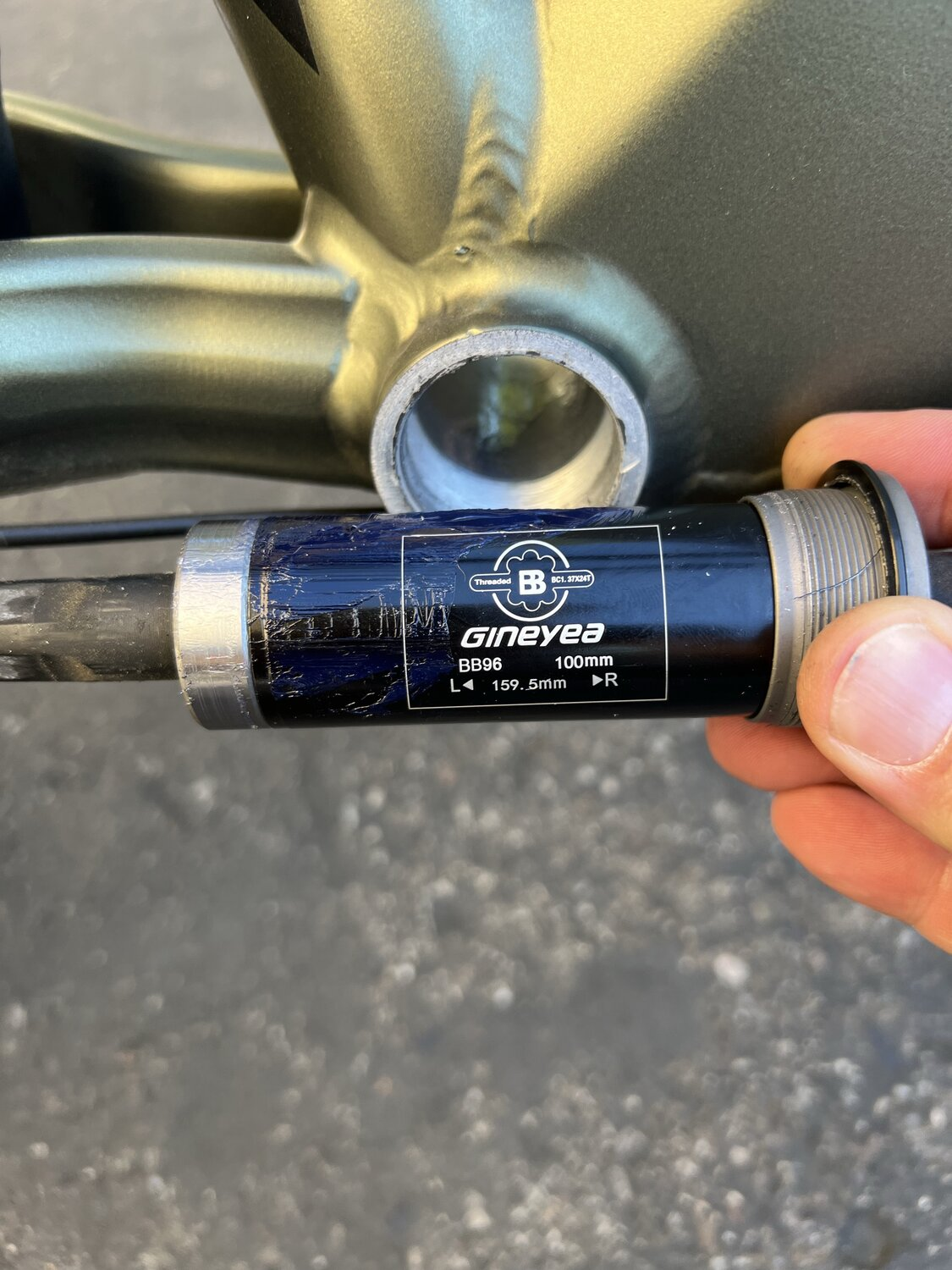

If you pull your bottom bracket cartridge the size is printed on it. If you have the same bike as Dingo this is the image of his that he posted

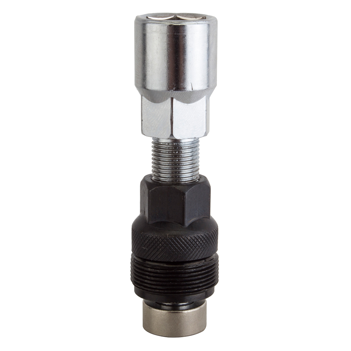

Regarding the prior post that the following crank puller stripped the crank threads, that would only happen if it was used incorrectly.
It is a universal puller for both ISIS and square tapered cranks. These universal pullers have a disc at the bottom to use for ISIS, you have to remove it to use for square taper cranks otherwise the puller will just press against the inside recess of the crank and not contact the axle. If you use brute force then it will strip the threads from the crank. The second puller he listed might work but it isn't the right tool for the job.

Does not the 159.5 refer to the length of the axle? Losing 2mm on either end should not be an issue for most of us.
I use that style of crank puller too. It will strip the threads if you are in a hurry and forget to remove the bolts that holds on the pedals.

159.5 mm is the length of the axle. A couple mm of axle length can matter especially if needed to allow space for the cadence sensor to be installed.
I don't know what you mean by "It will strip the threads if you are in a hurry and forget to remove the bolts that holds on the pedals." you don't remove pedals to pull cranks, the only way that type puller will strip crank threads is if the ISIS disc isn't removed for use with square taper cranks. Even then you would have to a lot of force to strip the aluminum crank threads, that alone should indicate something isn't being done right. Maybe you mean if you don't remove the crank bolts (for cranks with recessed bolts rather than the more common hex wrench type) but even that would be hard to not recognize as the puller should only be able to grab a couple crank threads, if that.
Its only 4.5mm (less than 1/4") longer than a 159.5 if that is what you already have - resulting in 2.25mm longer on each side which isn't much of a difference. I recently put a cartridge with a 7mm longer axle than stock on my 26" folder Dahon Jack to make room for a cadence sensor. I just put it back to a non-assist bike but I'm leaving the longer axle on the bike, doesn't make a noticeable difference to me.
