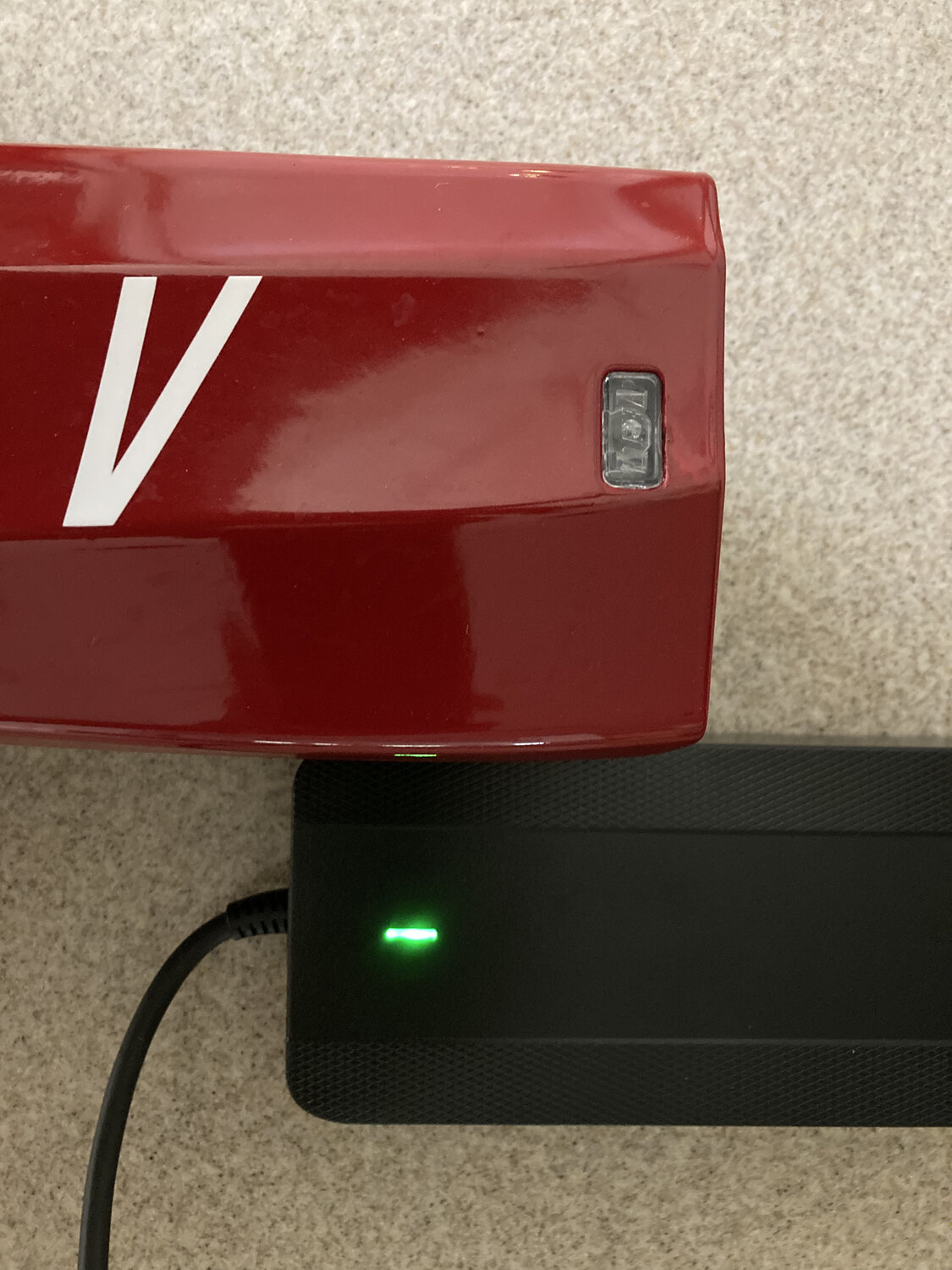

Hi Mudcamper,
I've had a nearly identical situation. My battery died after only 347 miles. It quit in the middle of a short 3-mile ride. I submitted a Warranty Form on August 30, 2021. And over the next four weeks, I provided proof of purchase, serial numbers, as well as images and videos of the problem. Despite dozens of emails, phone calls and online tech support chats, I STILL have not received a new battery. They keep telling me the battery is in the cue to be shipped, but it never does. I have posted a complaint/review with the Better Business Bureau. Maybe that will shake something loose. My patience is at an end.
Also - 2 screws were missing from the Lock Assembly and the battery guide was in danger of falling out. All I needed was two 2.5mm machine screws. Instead, they sent me 2 entire Lock Assemblies. I guess I'll donate them to some needy Aventure owner with a bad lock.
