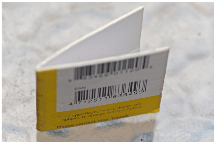

When either wheel is removed you do need to be careful not to tap or pull the brake lever. This can cause over extension of the brake pistons requiring them to to reset before reinstalling the wheel. This spacer avoids this, https://www.performancebike.com/shi...QFZC2NAxwoxuq_OjtL_EwTyB91A4HzJhoCgOwQAvD_BwE . I keep one in the shop and carry one in my flat repair kit.

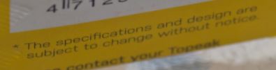

Such a homemade brake pad spacer will do ;) A piece of cardboard.
I had the situation you described earlier and my brother made two such spacers for me :)
