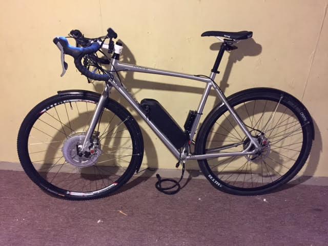

I have a couple thousand miles on an AllAxle that is one of their first gen models. I did a 9c build and a couple thousand on that also using Grin parts before that. Both on drop bar bikes with 45c tires, I suppose what you would call gravel bikes but I mostly used them for any road I was on and trails too.
They made me a believer in front hub bikes that I hold onto to this day although I mostly use my FS mid drive anymore. My Grin hub is being rebuilt into a new frame at this time and haven't got it finished yet but looking forward to it getting done at some point. It is a great motor I feel as it is light for a DD motor, which is my preference over geared because I like the regen feature and silent running.
I ran both with 52v batteries @ 25A with no PAS only a throttle and the cruise control feature of the CA3. As much as I like torque sensing PAS on my FS bike I really prefer no PAS on my road bikes as it allows me to have better pedal feel and gear chainging. I just set to a max watt output I want, usually 500w, and pedal away.
Front hub motors are not all that popular because people think they will handle weird and tear up your forks but that is not my experience. I even mounted my 9c in a carbon fiber fork with a good torque arm and never had any issues. No problem with unwanted wheel spin either. The two wheel drive aspect does come in handy though.
