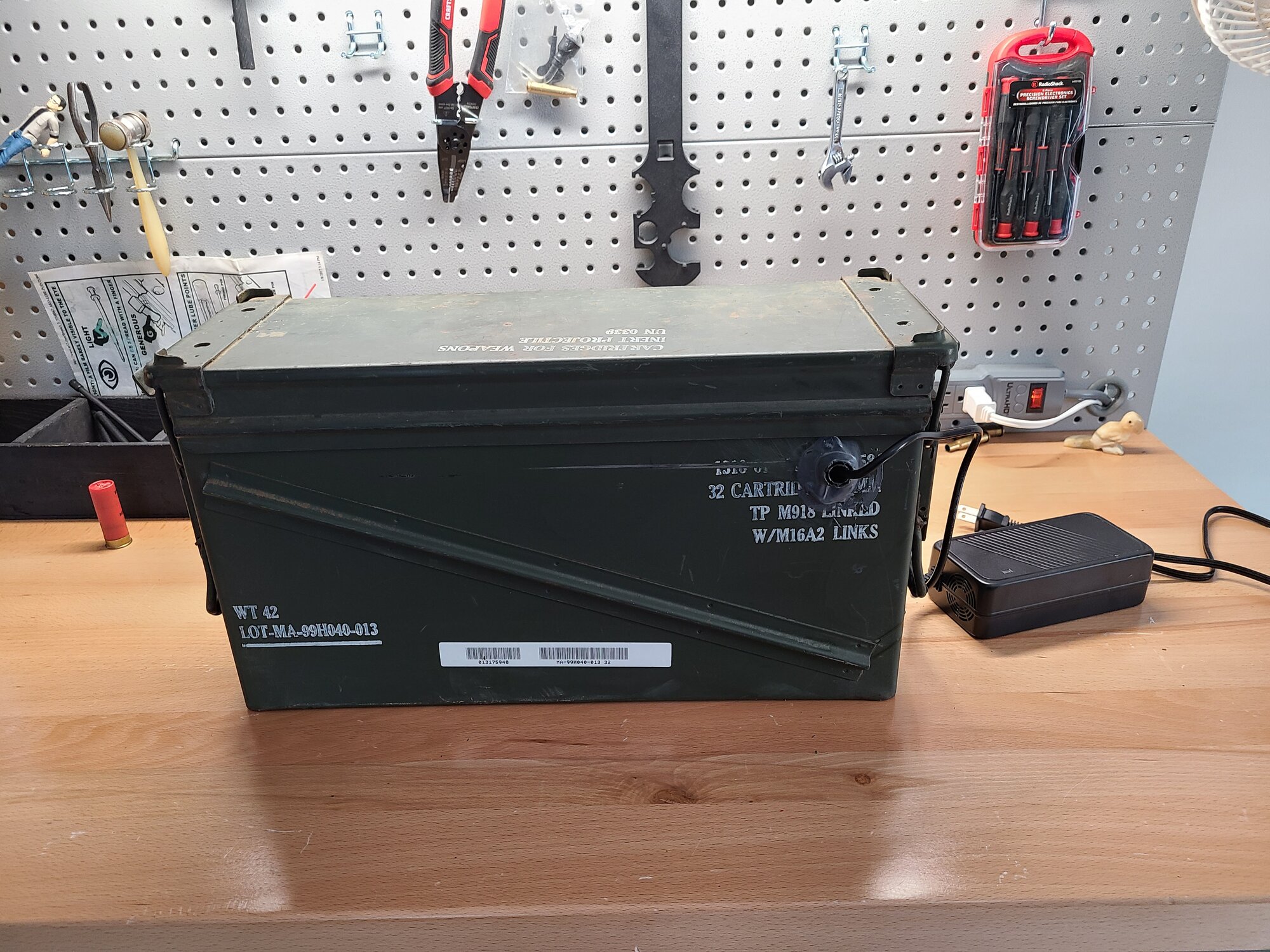

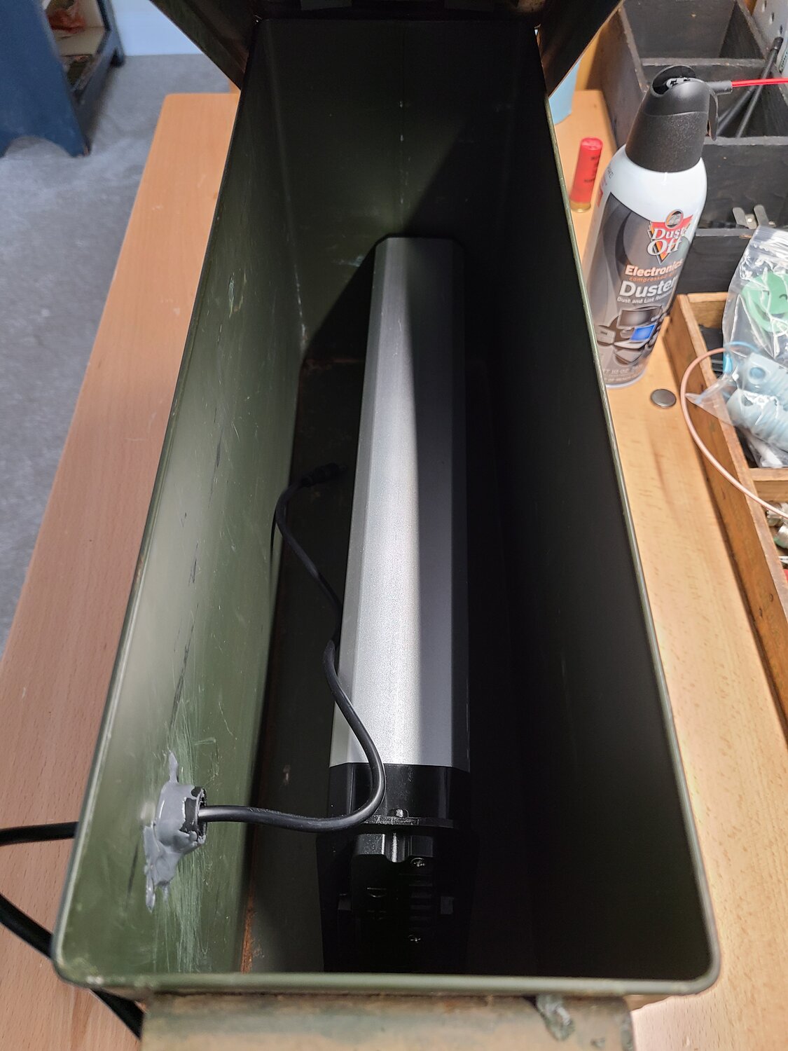

I drilled holes and lined the holes with rubber grommets for wire ports. I added ceramic fabric lining and mounted a smoke detector very close to my basement charging spot. I have welders gloves close by and NEVER charge unattended.

I've added a silicone gasket and rockwool flame arrestor to an ammo can. I keep it on concrete in liu of the double wall construction. Be careful with ceramic fiber. The dust is not safe to breathe.

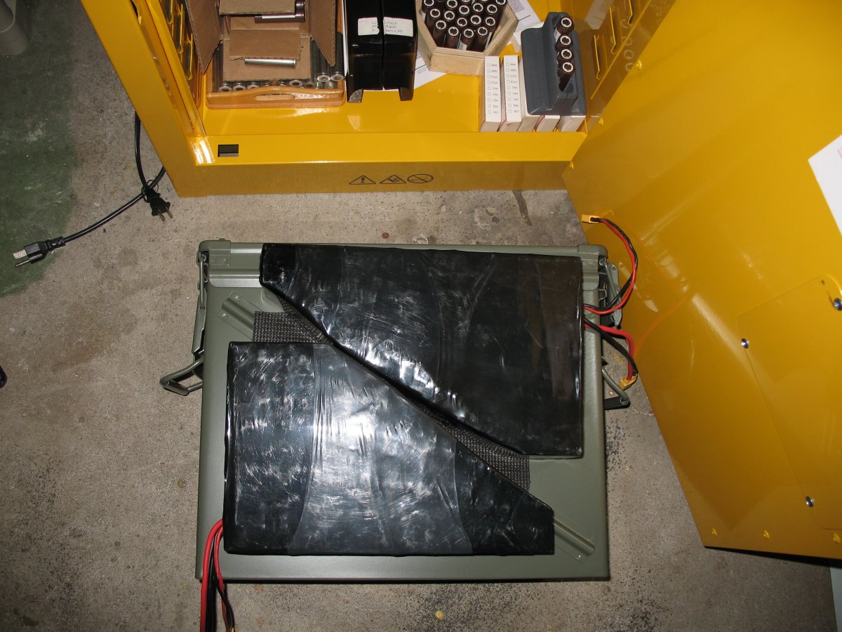

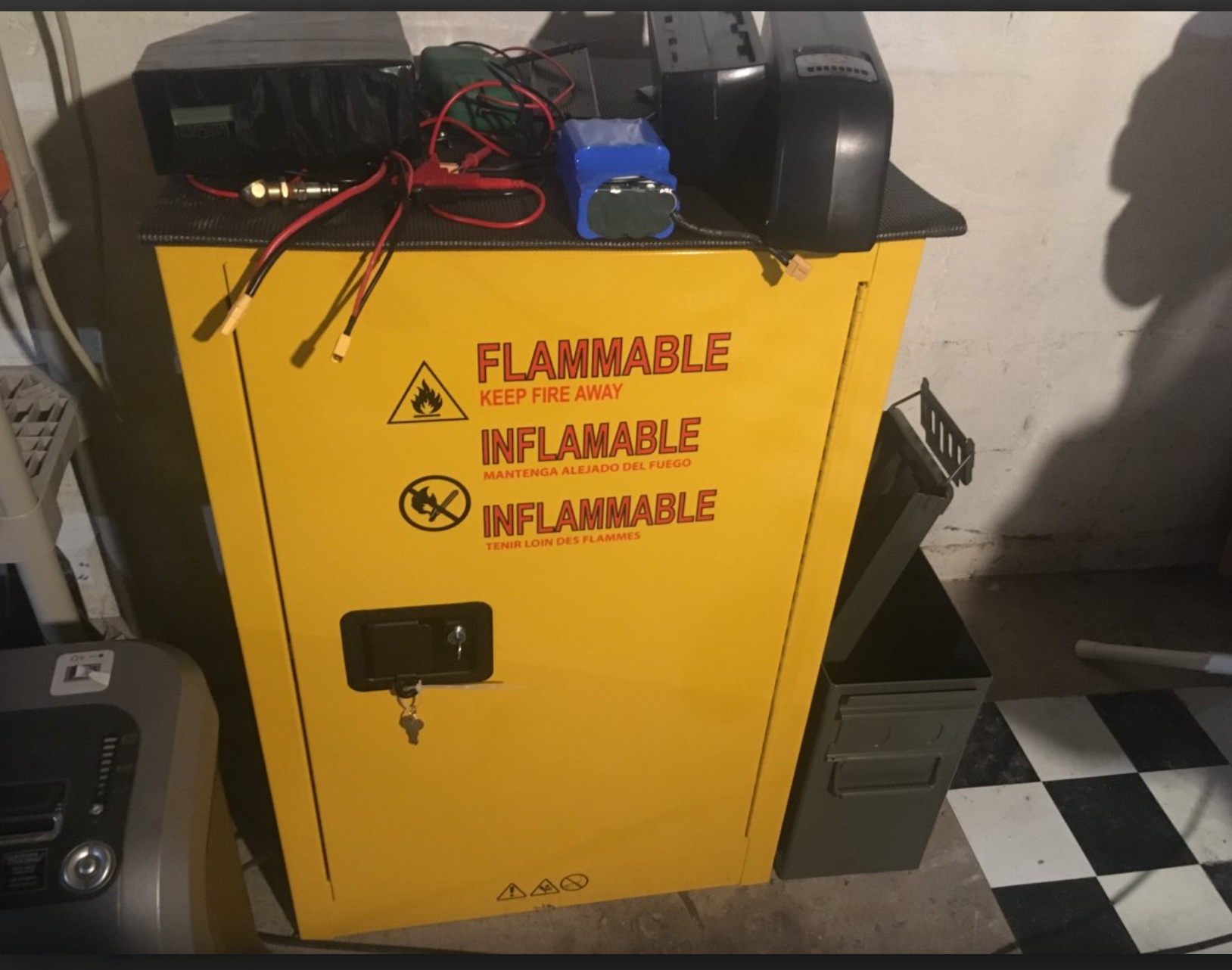

I've been eyeing a fire resistant cabinet like the one you show above. I'm going to have to re arrange my garage storage to make room for it though. In the mean time, I'm using a pair of these $28, 20mm ammo cans to store & charge batteries.
Instead of using holes with grommets for wiring, I use these XLR panel connectors mounted to the side of the cans.
I store the cans on a concrete floor in a semi heated garage where the temps vary between 55 and 80 degrees. I also have a smoke/fire detector nearby and never charge unattended. When full with 4 batteries, the cans are too heavy to lift easily and I wouldn't try it anyway with one burning inside. I keep a rake handy which I can use to grab the handle of the can and drag it across the concrete floor and out of the garage should it become necessary.
Just how effective these ammo cans are at containing a battery fire is unknown. This isn't a perfect setup but I figure it will reduce my chances of serious damage should a catastrophic incident occur.

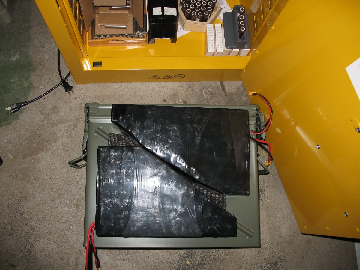

Often some of the guns and ammo websites do sales on large cans. With a little patience, $35-$45 will get a nice large can shipped. The only caveat is they may not have been rehabbed and look rough. I pictured two 20Ah triangles on my large can but i'd not ever charge that many cells at once!
