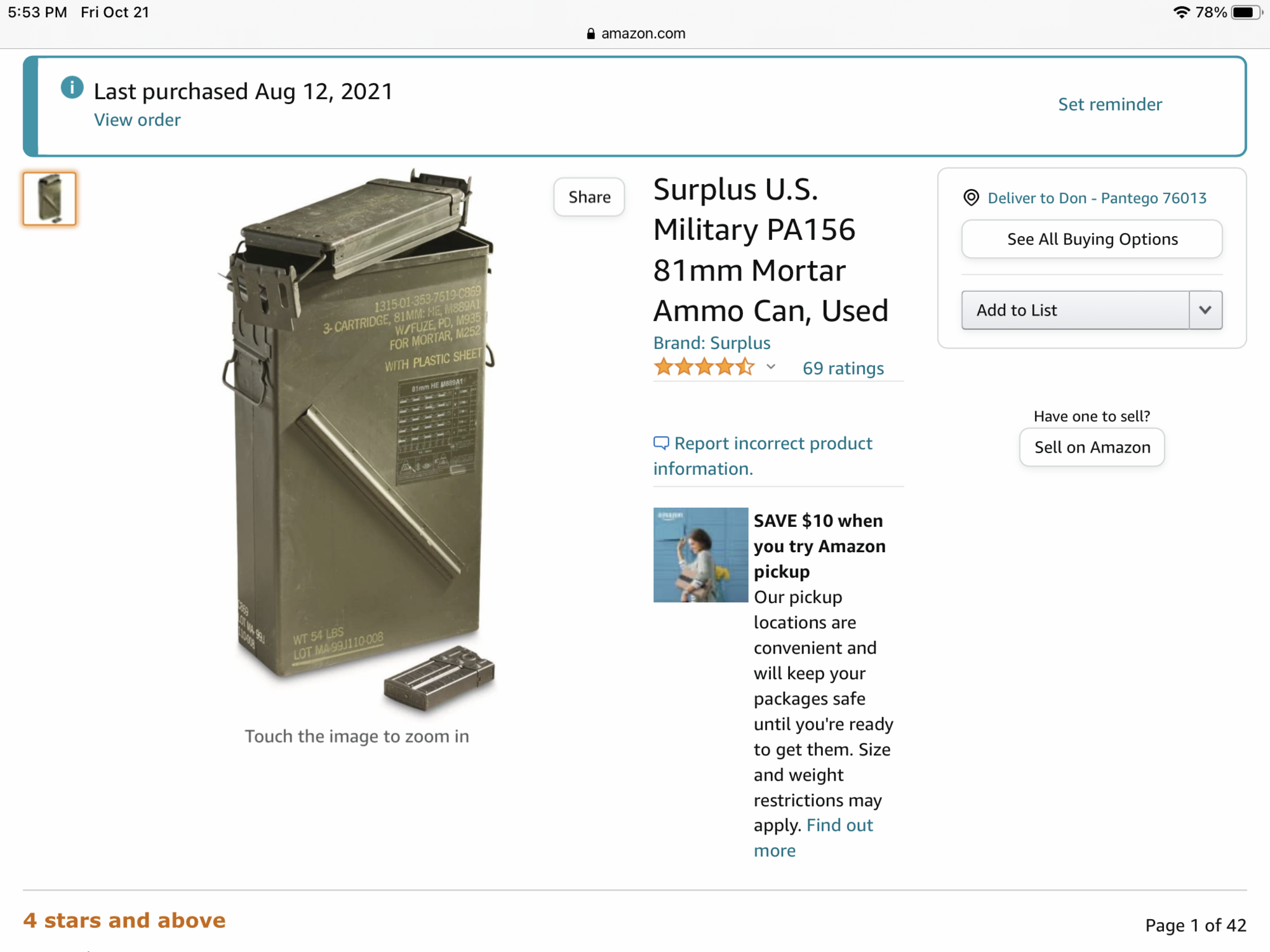

I use a 81mm mortar ammo can, was like $30 to my door from Amazon. Will easily hold 3 full size batteries with room to spare. I lined it with fire insulating blanket. It should contain a mishap if a battery goes south on me, or at least minimize the damage. I keep batteries and charge inside the house.

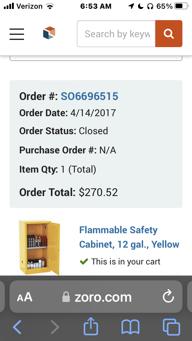

I forgot to add details. I actually looked for a cabinet for nearly 3 months. Zoro had a sale AND free shipping. I was shocked by the deal and jumped on it. Listed now for $508.87 plus shipping. I paid $270 shipped. Which was $100 less than what i saw used being sold for. Seemed to good to be true but sure enough free shipping too. I have seen them for $400 shipped, using Google search tools i got at leadt one listing a day until zoro popped up

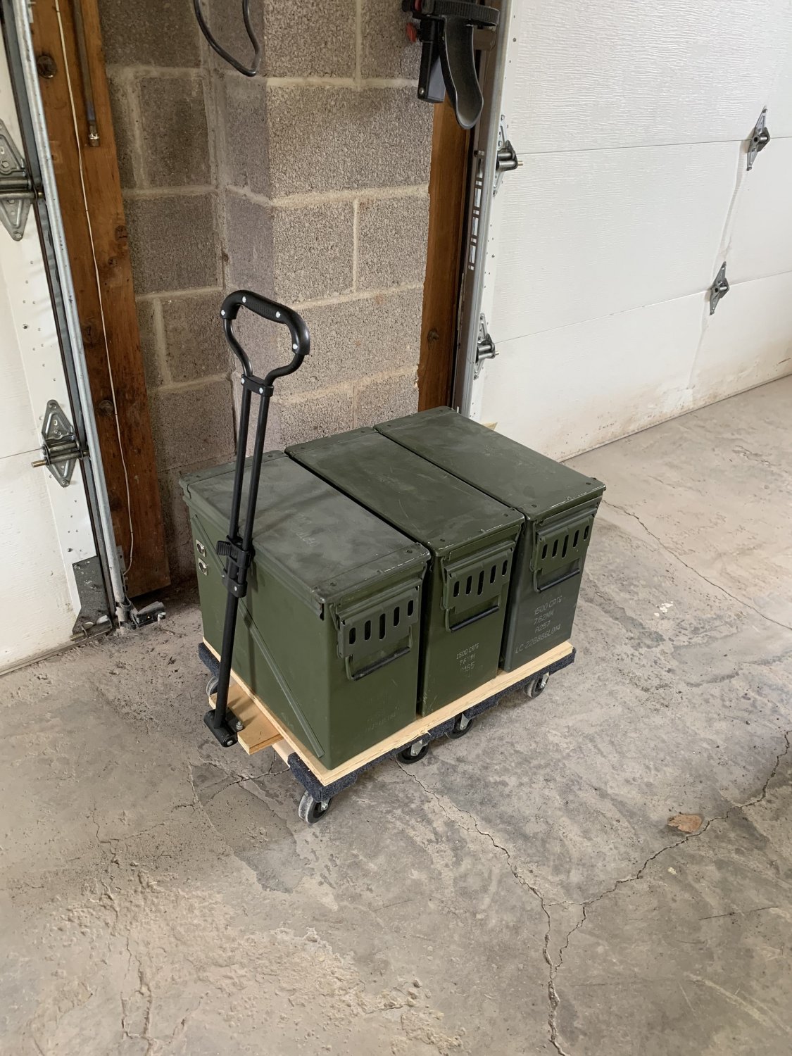

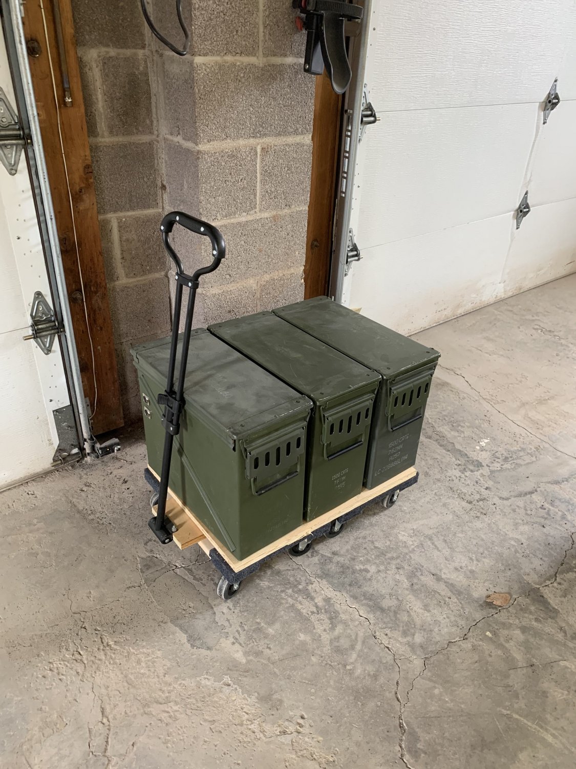

Ammo cans are a deterrent at best, and will not completely contain a fire. They can buy you time however to move the burning battery outside. I have my ammo cans mounted on a dolly that can be quickly pushed out of my garage with a long handled rake at the first sign of trouble.
