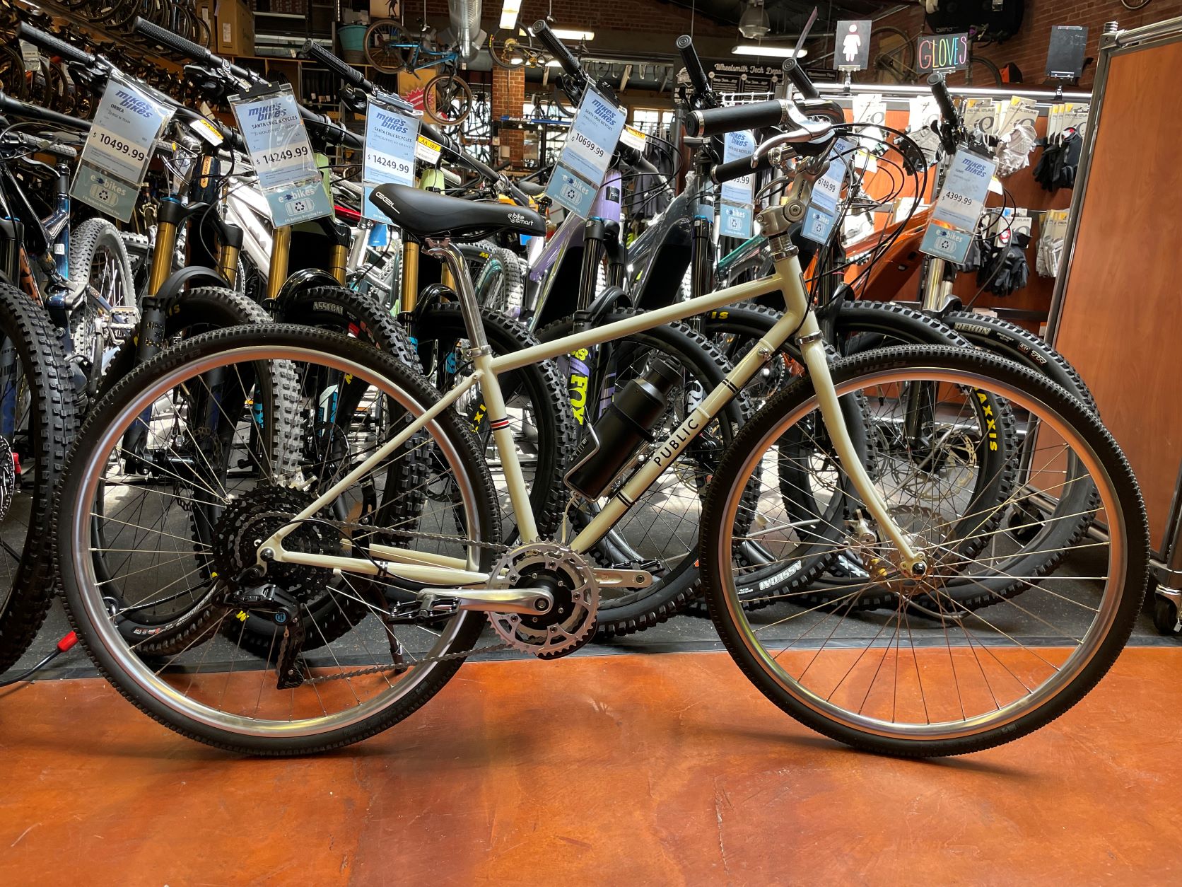

Less is more. Zen is so much harder and so much worth it. Getting to less. Who has the most limited and clean handlebar? What does a clean eBike look like and feel like, being simple. This is what simple eBikes look like when they surpass the ones from stores.

That's nice, but I'm not really into zen or feng shui. Here's a preview of what's next.
