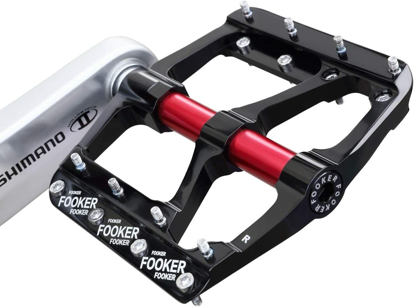

I really like these inexpensive ($28.99 shipping included) MTB pedals by Fooker. The pins make them nice and grippy, rendering toe fenders less necessary. They are very light weight and have a nice thin profile making pedal strikes less likely. I have these on my Allant 9.9S. They really match the black and red color scheme nicely. They do come in other colors.
