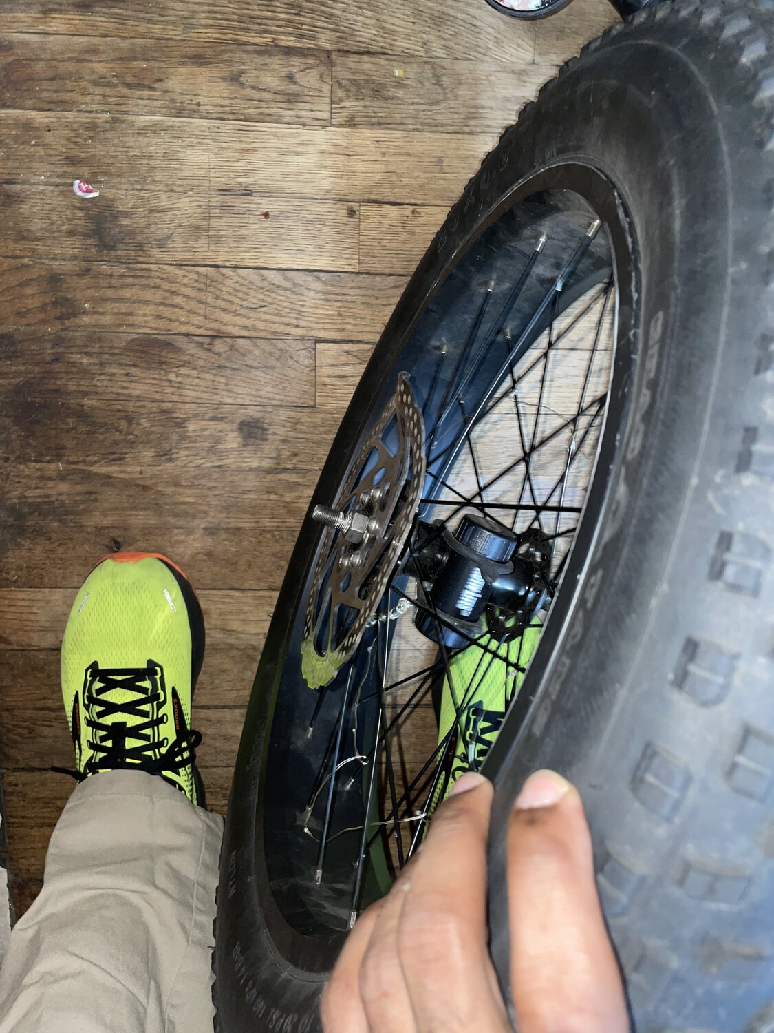

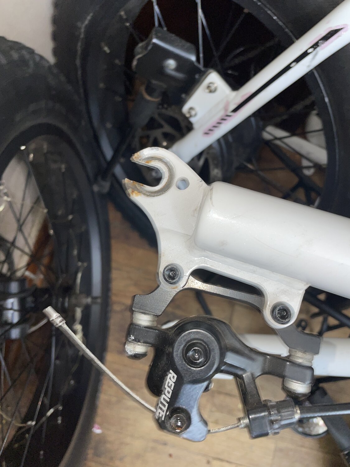

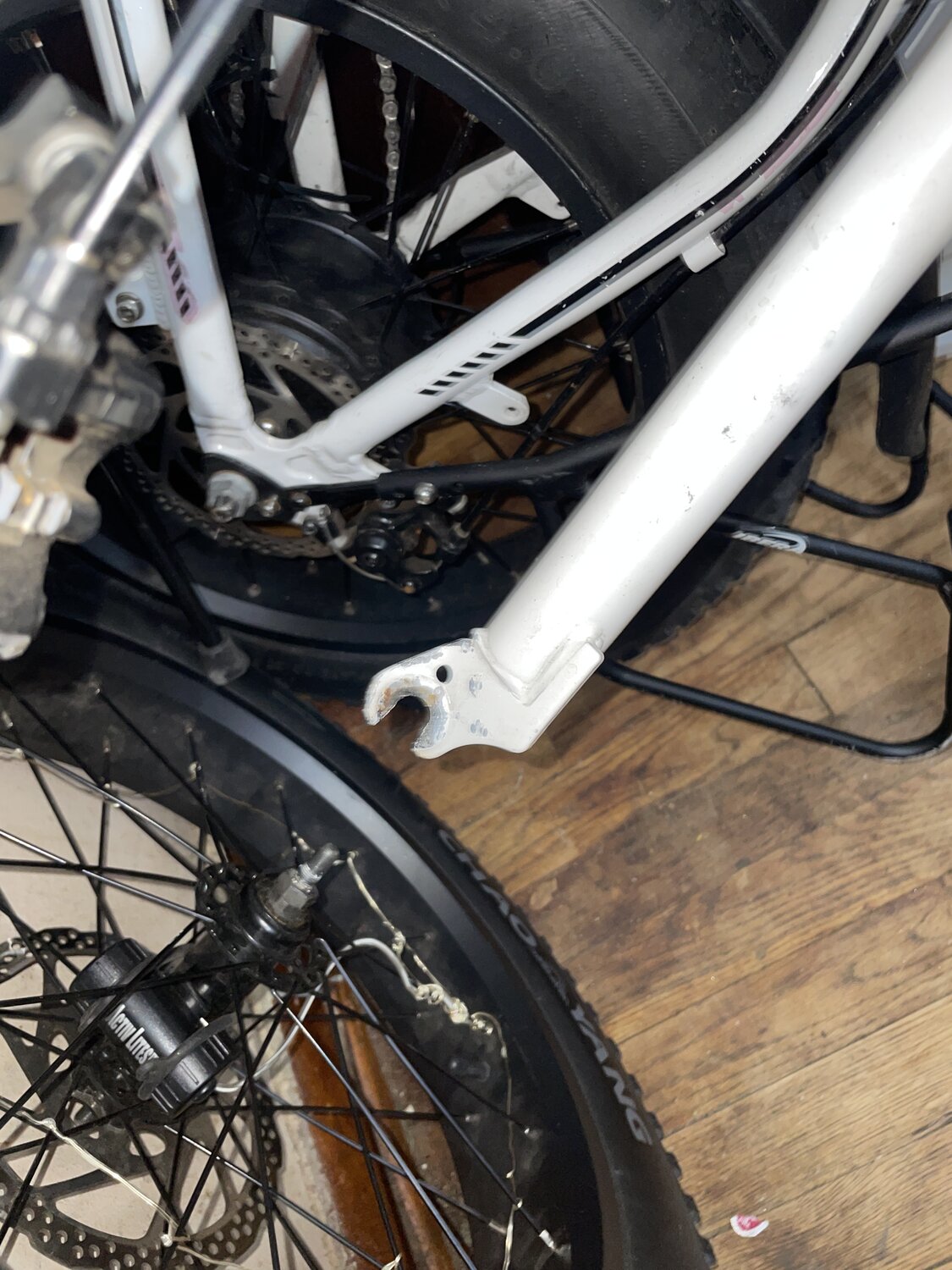

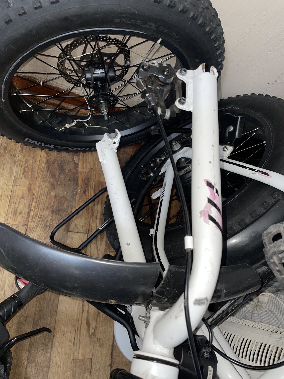

Hello, I need help repairing my bike, which was damaged in an accident. I twisted the front fork and want to know if it can be replaced. The bike uses a disc brake system, and I've removed the wheel. I might need to buy a new fork. I can provide pictures if needed. Thank you for your assistance.

I see rust on the end, but that might be from your washers, Aostirmotor says it's an aluminum fork. You have to replace it, Aluminum cannot be bent back.
Your fork is probably a 20" fork with 135mm spacing. Replacement is complicated because there is no market for these forks. They seem to cost about $100-120 shipped on aliexpress, like this one, So the sellers can ask that kind of money for a $20 part,. Ridiculous for a $699 bike,

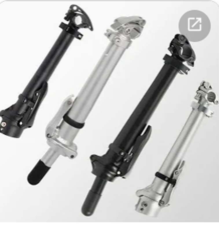

The other issue is making sure the fork will fit. Forks are either 1" or 1-1/8" in diameter, threaded or threadless. If your folding steerer tube is held by two horizontal screws in the collar, it's threadless. If there is a center screw that holds down the steerer, it's threaded. The two in the middle are threaded.
