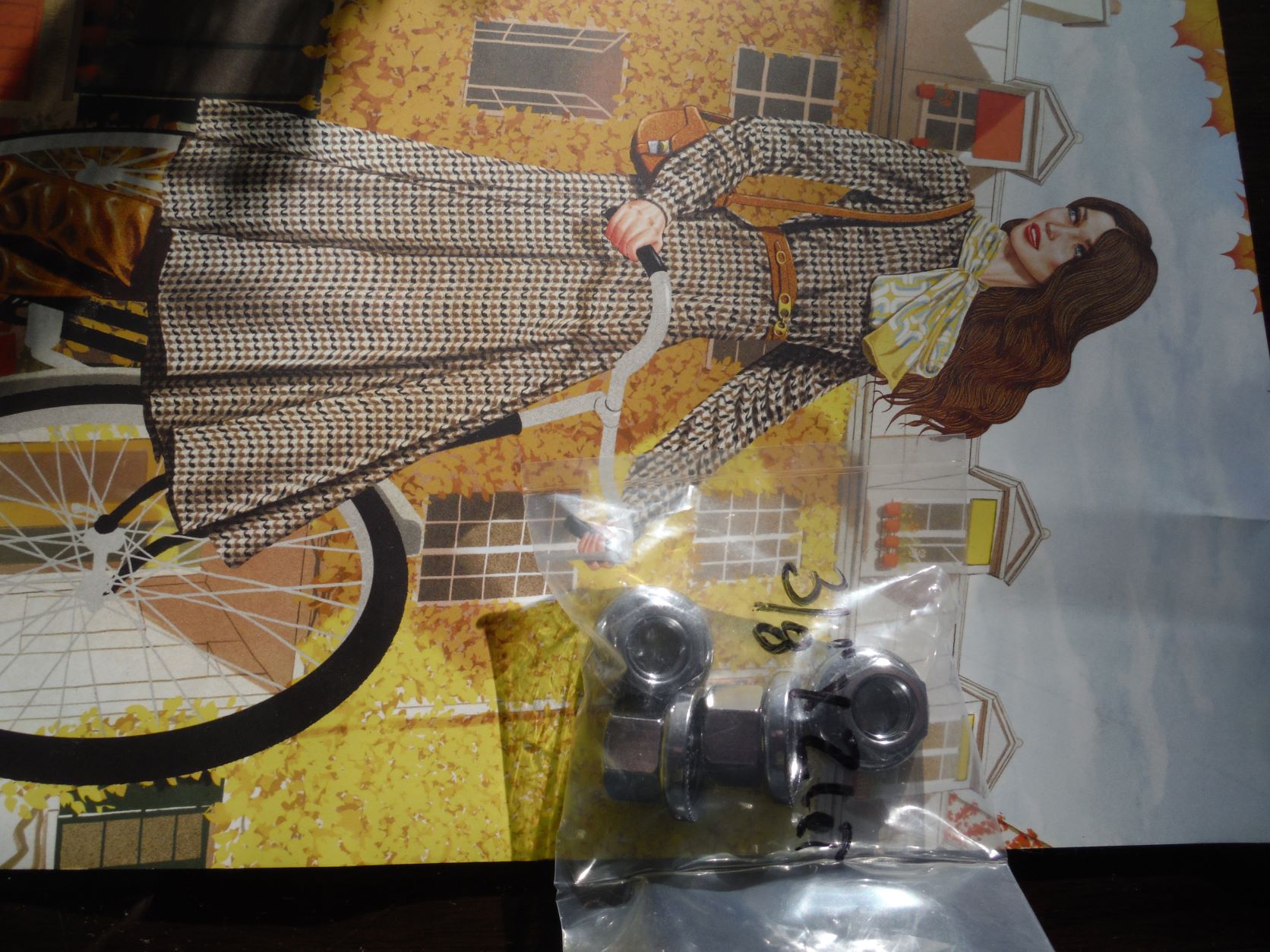

With thousands of bikes it is good etiquette to open with a photo. That helps so much and it takes the burden off the reader to try to do the research. @ABM is new and could not know this, thinking that members of the forum are smarter than we actually are. Here are the nuts I have been using for Nexus and Alfine hubs. They are very strong and precise. I use a drop of oil so that the washer portion spins freely and grease the axil and nut threads.

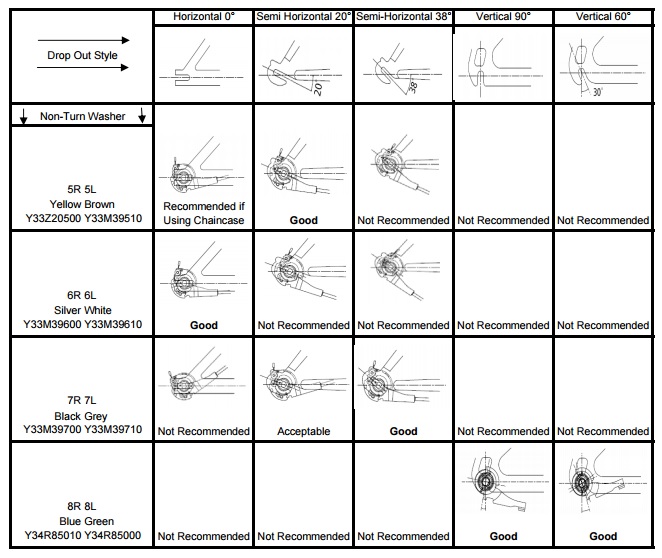

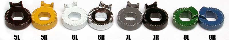

Thanks for yor help. I feel obliged to tell you all how I have been dealing with my case. My usual technician is on vacation now. So I went to a new bike shop to buy a set of proper nuts this evening. they told me the nuts I had were very good so I didn´t need to buy better ones. They thoght I should bring my bicycle to their shop for inspection, so I did and when they cheked the hub they asked me to leave my bicycle there for mending. I couldn´t understand why; it just needed tightening. I pushed them and, eventualy, they explained to me that a washer was missing and the safe that prevents the wheel to drop completly was wrongly fitted. Now I prefer to say my usual and currently former technician made a still one more mistake. I hope my new technician be the right and definitive one. I had never been into internal change bycicle before I bought the one I own now. I'sorry for bothering you unnecessarily.
Yep, the Shimano IGH hubs use a special washer that is designed to lock in the drop out. Sounds like you've got a good bike shop there that spotted the issue!
