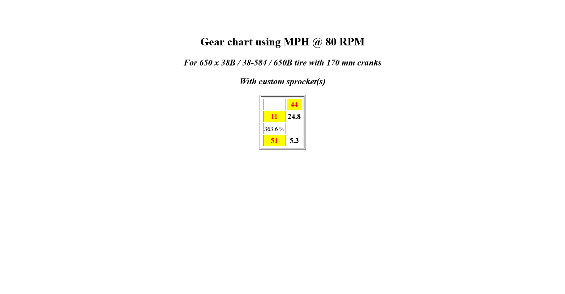

I'm afraid I've lost track of what the main bike under consideration is, but: If you're talking about a full suspension bike, making a big change in the chainring can have other consequences you want to consider. If you look at the Powerfly FS series you can see how the lower pivot of the rear frame triangle is right where the chain leaves the top of the chainring. That maximizes the amount of pedal force that is turning the wheel vs moving the suspension. If you get a significantly larger chainring, it will change that geometry.
Also, if the chain crosses over the rear triangle (like it does on the Turbo Tero X) it might need a relief cut for the chain which won't line up if the chainring is much bigger.
And it might have a guide for the chain that you'd have to remove or modify.
For example, doing the math on the Tero X I just got, if I wanted to be able to hit 28MPH at a cadence of 75 in top gear, I'd need to switch from a 38T front to a 48T front (!) which is 40mm larger diameter, so the chain path would move up by 20mm. I just measured and the chain would definitely hit the rear triangle in the lower gears. Plus if you look down from above it's clear that the front chain guide is doing important work, so it would have to be redesigned to fit the new chainring. (from a straight gearing perspective it would probably be great. I haven't gone up a hill that needed a gear lower than 3rd yet)
That Marin has 650b tires that are smaller, meaning lower geared for climbing, than most modern mountain bikes or many gravel bikes. It has a chainring with 44 teeth and an 11-51 cassette. Pedaling at a cadence of 80 rpm the speed range is 25mph on the flats and 5.3mph for the steepest hills. That is a whapping 472% gearing range.
