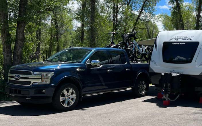

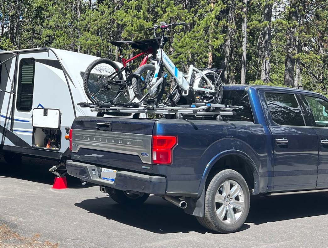

Just an option and an FYI. I have an F-150 with a tonneau cover with a bike rack over the tonneau cover. I had the rack before I got the Lectric bikes and all works very well.
Truck Bed option for carrying bikes
Pace Edwards UltraGroove Metal Retractable Hard Tonneau Cover
Thule Rapid Podium Feet for Thule Crossbars - Fixed Point - TH460R
Thule Podium-Style Roof Rack Feet – 3101
Thule ProBar Evo Crossbars - Aluminum - 78" Long
Thule UpRide Roof Bike Rack x 4
We carried four bikes, three Lectric and a Marin MTB over 4,000 miles without any problems.
The only downside is I must remove the front fender when transporting the bikes. Yes, the bikes are heavy but they are manageable. Even after breaking a rib on the MTB in the Teton’s, I could still lift the bikes up onto the carriers. I use a stool due to the height.

@wszlecric what Ford is that???
