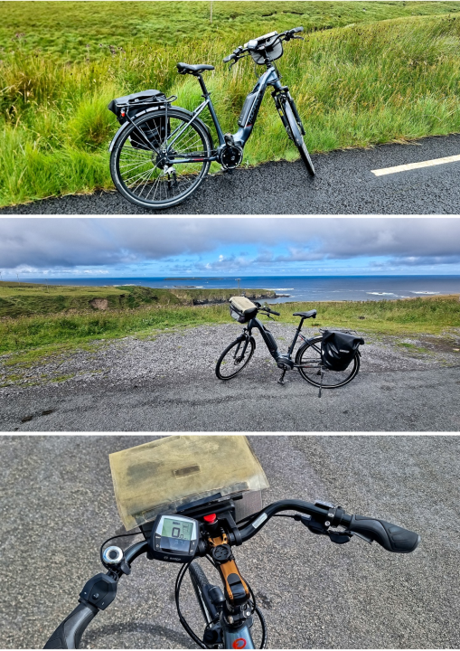

Having said the above... You already know my legs are bad but I have developed a kind of fitness (related to pedalling). I had a 34 km ride in Irish hills this July, riding a pretty unknown brand (Thompson) e-bike but equipped with a 50 Nm Bosch E-Bike motor. To my surprise, I had no issues climbing even a 10% long hill there despite the relatively low motor power!
My average speed was 19.5 km/h, which I perceive as pretty good!
