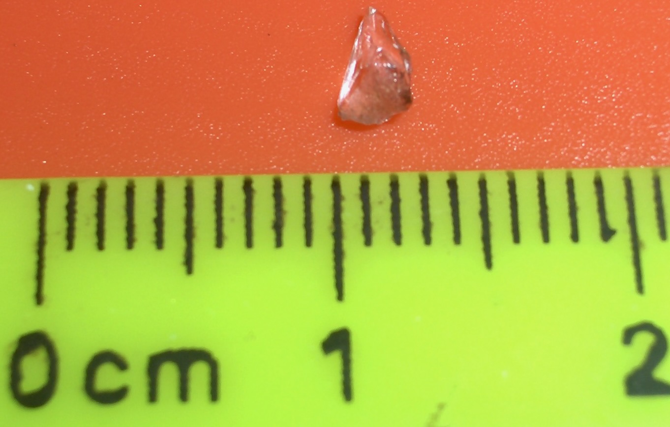

I have ridden my Abound about 30 miles. I used it to get groceries in this afternoon. When I rolled it out an hour later, the back tire was flat. I took the wheel off, cleaned the tire, and found no evidence on the outside. In a case like that, I mark the tire at the valve on the chain side, and I mark the tube at the valve on the same side.
I found the puncture in the tube, but the casing felt smooth in that area. Matching the tube to the tire, I determined the exact spot and saw a bit of discoloration. Digging with my fingernail, I got out a granule that had been completely imbedded in the soft rubber. It had once been broken glass, but being run over countless times had worn it too smooth to prick my skin when I rolled it between my thumb and forefinger. It was like a grain of sand, but at 2.5 x 3.5mm, slightly bigger.
It reminds me of the time I had a flat from a 1/4 inch length of thin stick, not like a thorn, but fairly soft, almost like the stem of a leaf. What's wrong with ebike tires these days? In the days of the classic 26 x 1-3/8 tire, it took something like a nail to get through to the tube. One reason I bought the Abound was standard rims. The OEM tires are Innova. Schwalbe has more than one puncture-resistant tire that would fit.

Thread count! (TPI or EPI) There's no sign of tearing, so the granule, 2.5 x 3.5mm, must have lodged between threads. That looks very bad. Schwalbe says the cheapest tires have 20 to 24 EPI. That would be one every 1 to 1.25mm. Tires with low counts are usually made with thick threads, so the spaces would be far smaller than 1mm. These Innova tires must have a very low count of thin threads. I guess somebody in authority at the Abound factory doesn't know tire specs. My trip meter keeps telling me how many trees I've saved, so there must be incompetence on the design team.
