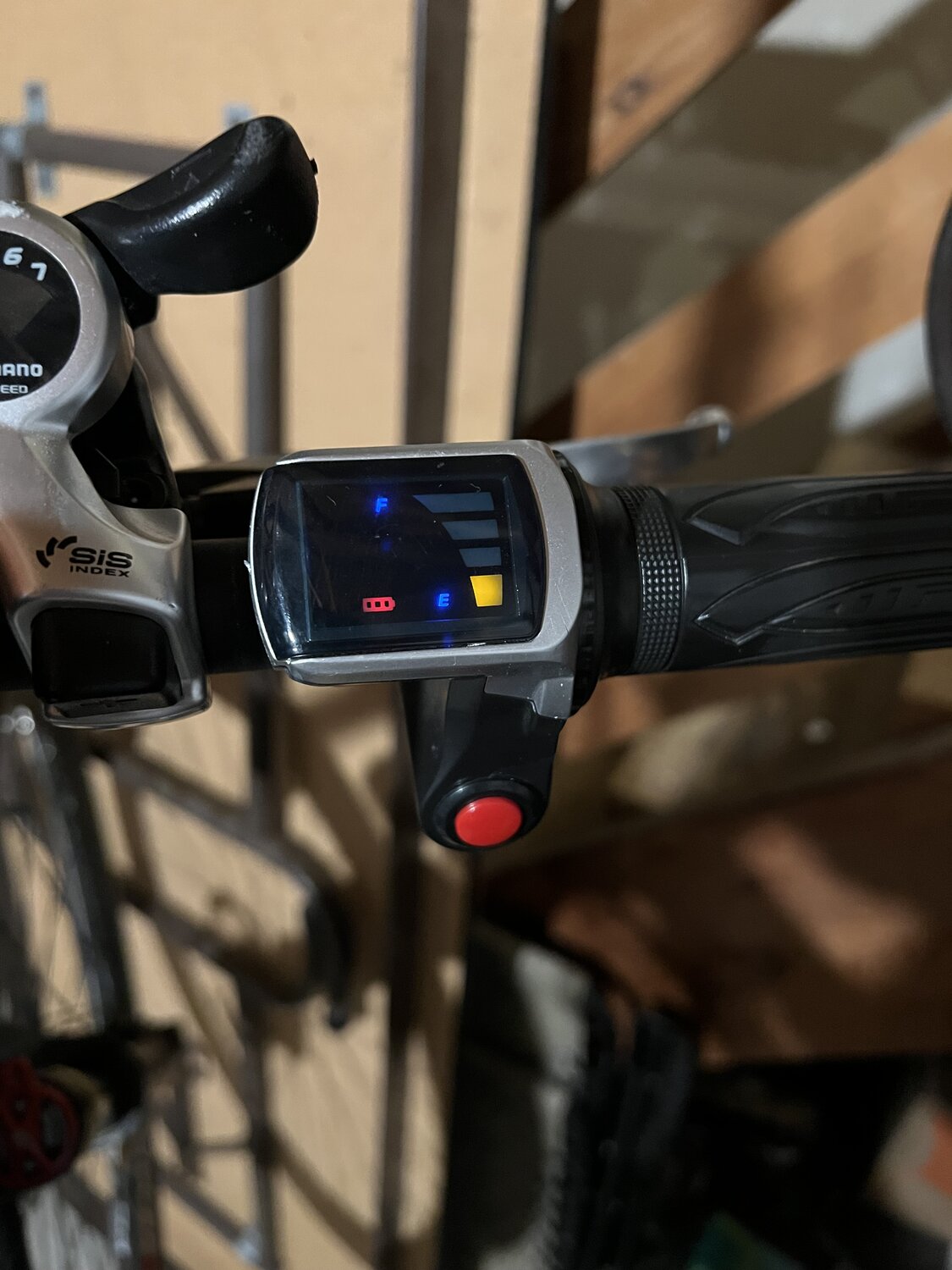

It looks like I just fried my controller. Symptoms: Battery can charge to capacity, but the LCD reads "empty" and the bike won't move. I tested the battery output, 58V, 28A. Some voltage is getting through to the LCD though. Does anyone have a recommendation for a replacement? I use two 52V 24A batteries to power a 1500A Voilamart hub motor (30 mile round trip commute - when the first battery gets low I switch to the second. ) This just happened yesterday, and I'm in a spot since I rely on the bike. I'd be grateful for your input. My ebike is a Franken-bike, for sure, but it is my necessary ride, as I am saving for a car.

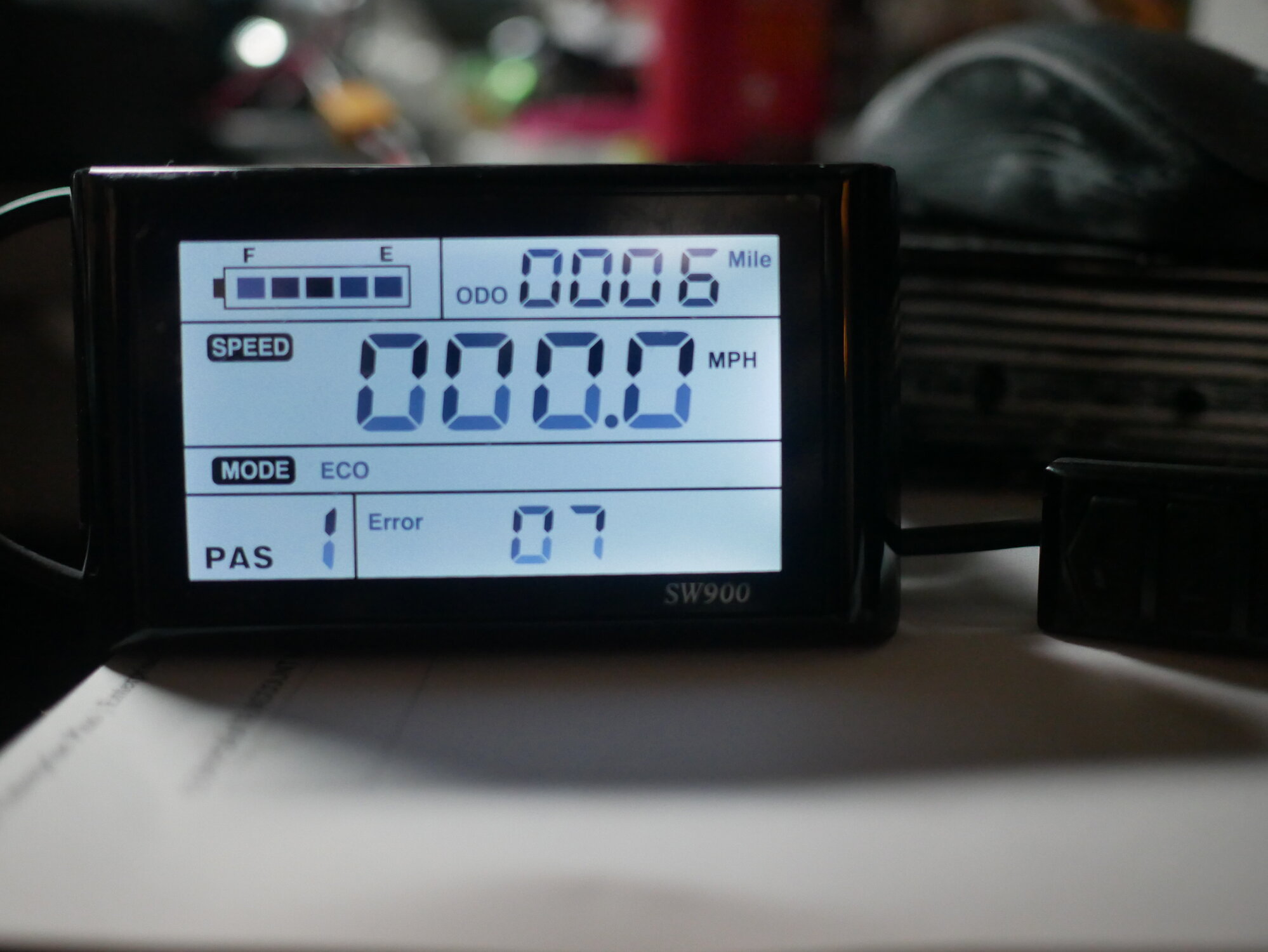

I saw on an amazon that some Voilamarts use the SW900 LCD. Does your kit have this one? "Empty" means it doesn't turn on? You're getting battery voltage at the LCD connector?
There's a workaround for many controllers that use LCD's like this one. If you have this LCD and it's not powering up, then a lot of controllers can be jumpered to run w/o the LCD and work with throttle and a basic PAS.
Maybe you can clarify what you got.
On the ride home yesterday, I found it off that the first battery went from 3/4 charged reading to 'empty' in a hundred yards. I switched to the second battery, got about 5 miles, then it died. This is why I'm thinking'controller'
The red means the battery is flat? Or does the yellow mean one bar of battery? And a meter says you have 58 volts on both batteries? And are these the same two batteries from this original post? If so, I'm thinking they finally gave out after six months of heavy usage.

Since then, I bought a 52v 24A battery from Matt at Bicycle Motor Works. Seems to do what he said it would do. I have the other functioning battery strapped aside the new one and make do with that. The 'yellow' on the lcd means 'out of gas'. The suddenness with this happening to both in one day points to a common factor - and the controller seems the culprit. As of five minutes ago, I put a meter on the batteries, one at a time, and got fully charged readings.

So you got close to full charge with meter, and the meter is correct? (Does it read 58V if you check one of your chargers? )
When you connect these batteries, the handlebar display lights up and says no juice. That's a puzzler. I believe the displays have their own measuring circuits though. Make sure your meter is calibrated and check it again at the display connector. Probably red/black wires.
