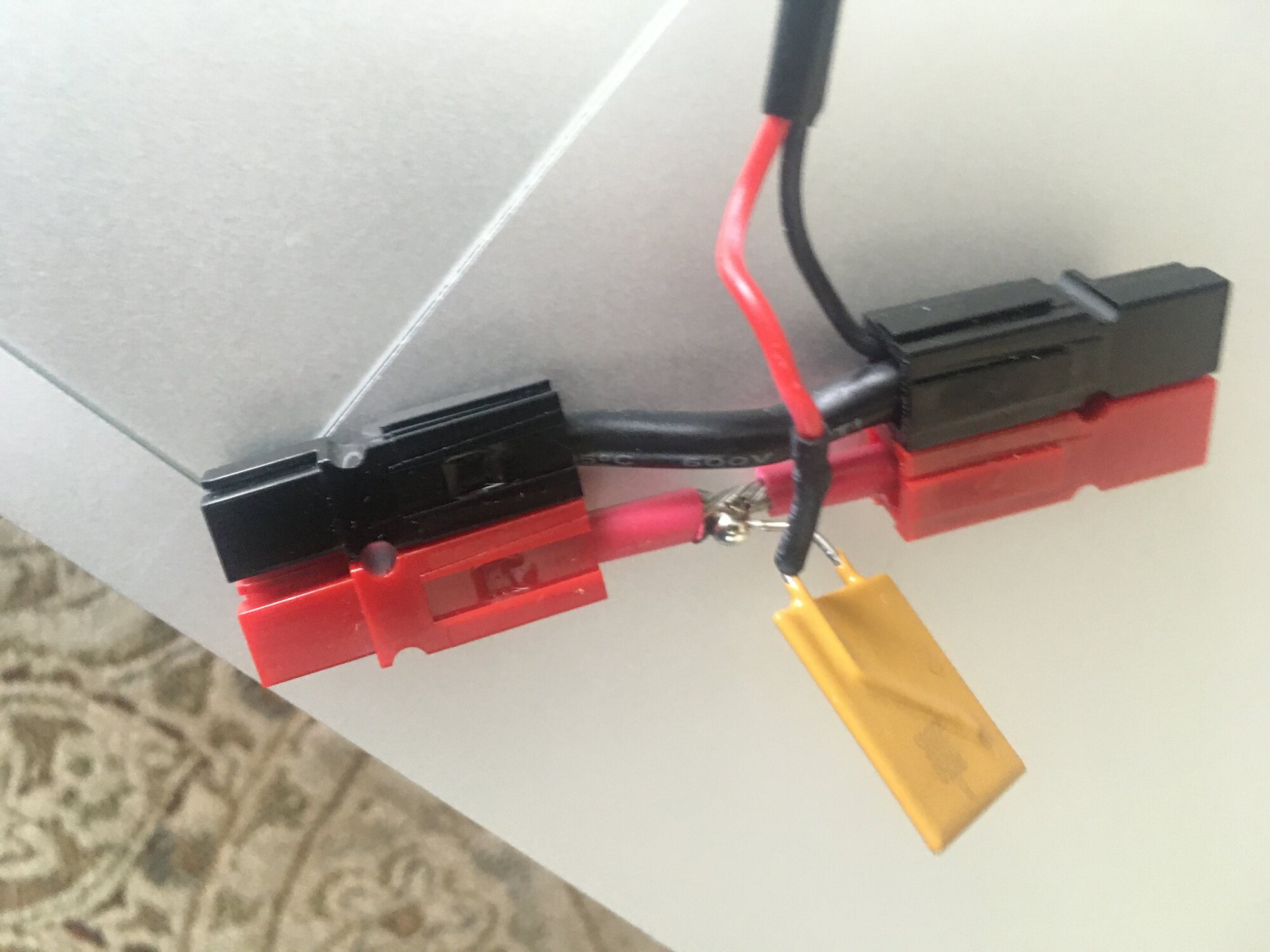

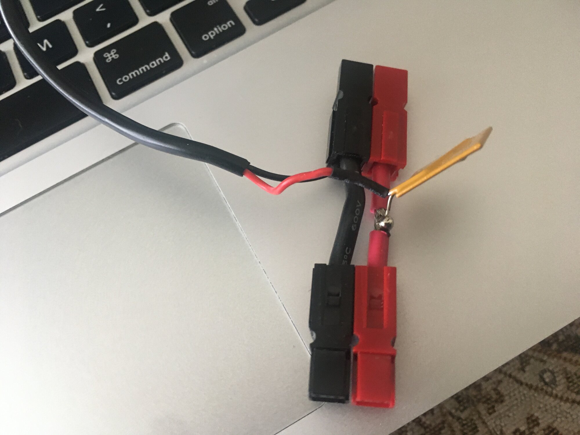

I’m becoming a fan of “simpler is better.” I use a tap directly off the battery power out wires. A proper StVZO headlamp that operates on a range of voltages works best for me. 6-85V Input Range, and StVZO
I’m
Is Lectric using Anderson PowerPoles to connect the 5-blade battery connector to the bike circuitry now? My XP - which is less than a year old - uses Dean's!
Sheesh! Shown as an example. The same can be done with Dean's!
