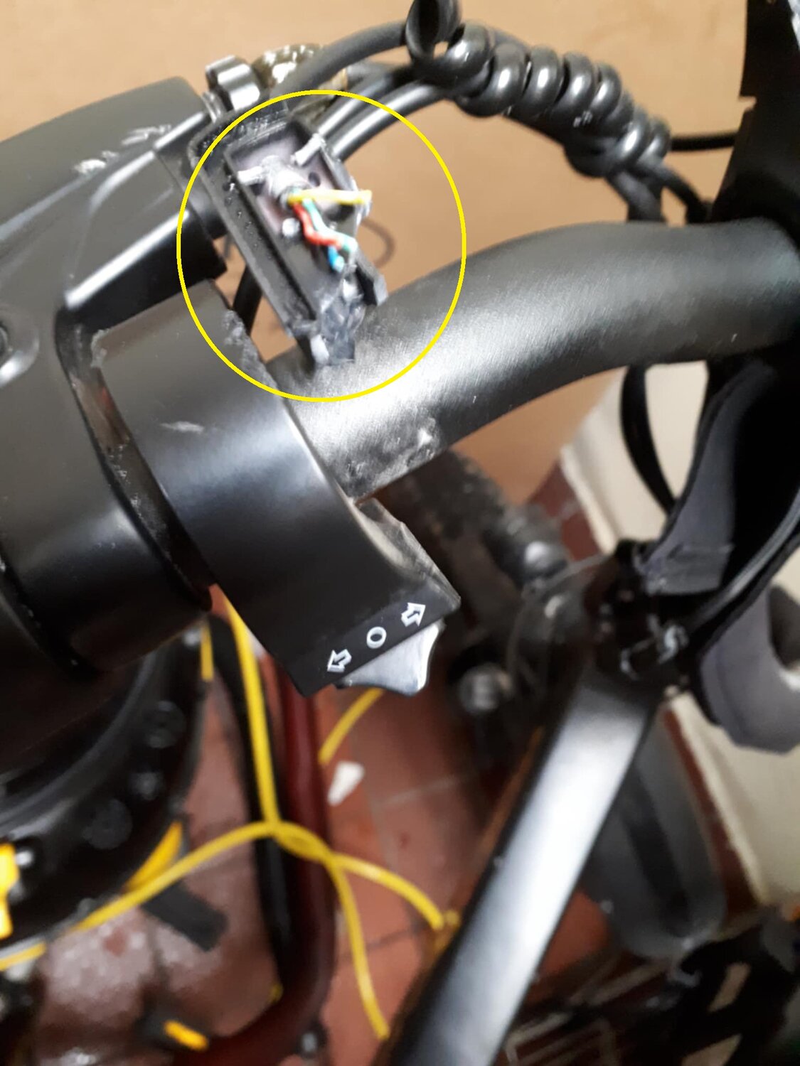

Along with my message, here is a picture of where the missing part would go. There's at least four tiny wires.. blue yellow red... The picture is a close up of the left side of my handlebars..
the button with the two arrows beneath the wires are where the bike signals left or right.

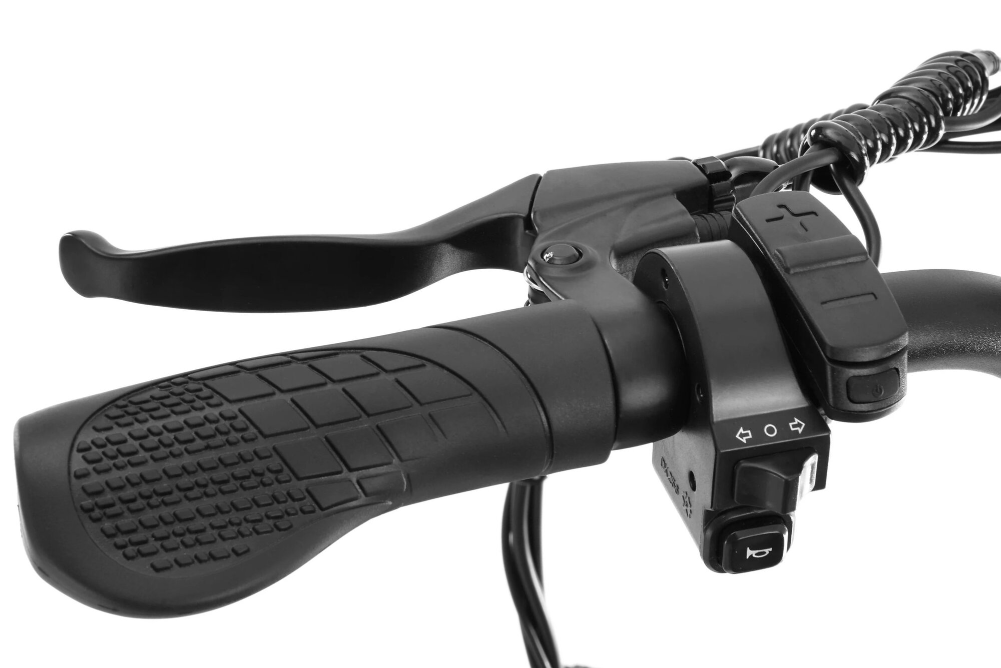

From the Polo web site. On the top, there are two arrow buttons with a power button in the middle? Lights is the bottom button facing to the rear?
Usually, the arrow switches are three spst switches with a common connection. That requires 4 wires. The lights would add a 4th switch and a 5th wire, Count your wires again, .
If you have some electrical knowledge, you can make this switch work for the motor controls, Will be some trial and error to associated the up, power, and down buttons with the proper wire color, The unit cable goes direct to the display?
You can buy a second handlebar switch for the lights,
Or you could contact POLARNA and see if they will sell you a new display, These switches are usually attached direct to the display.
Having jus read your reply, I went inspecting my handlebars again, and yes the missing four button piece I described above, does go directly into the display. I don't have any electrical knowledge. Your amazon link you provided might jus be what I'm looking for. Thank you! And thank you for the immediate reply. Should I not hear back from POLARNA, and I'll have to create an amazon account, Which I should be able to no problem in a couple hours.
