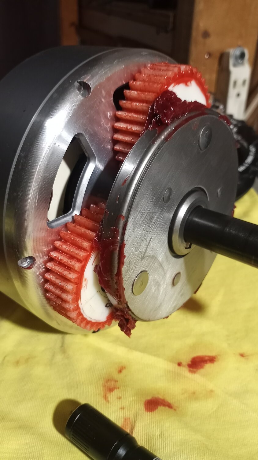

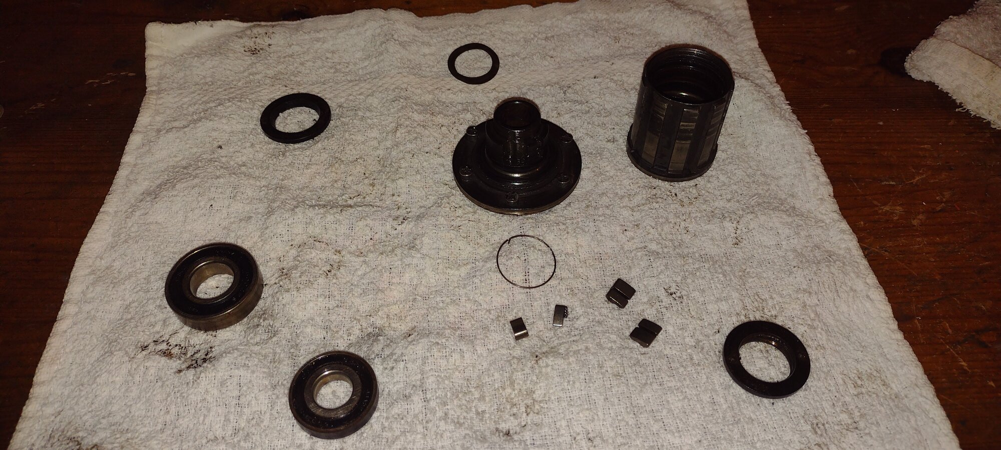

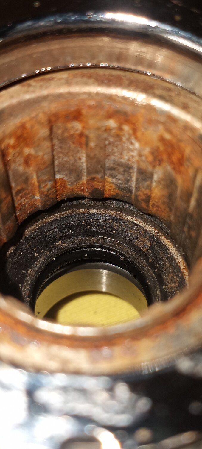

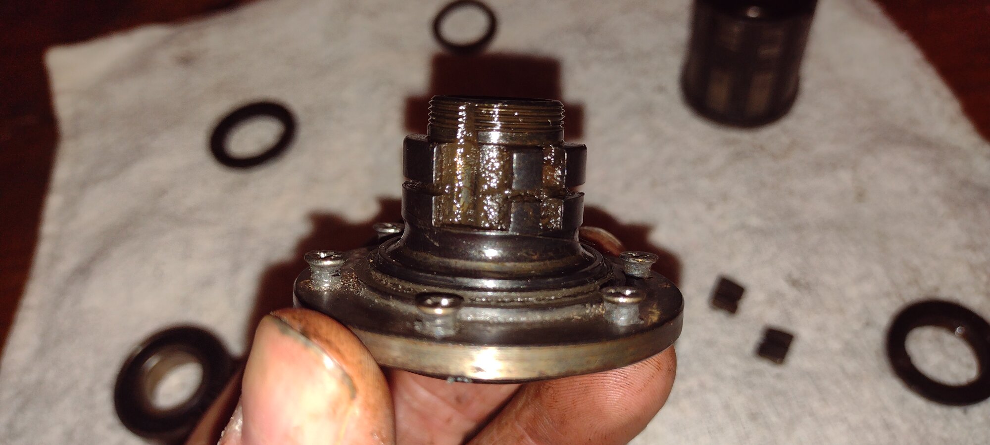

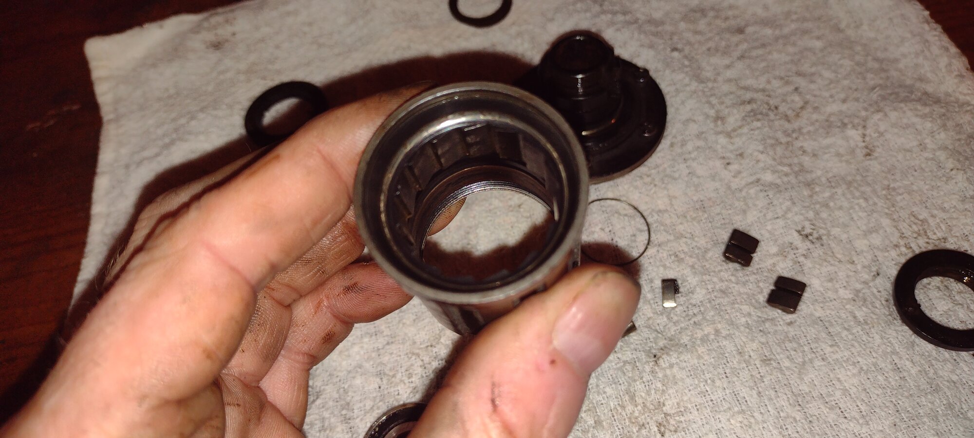

Heres the inside of the G60 Freehub if anyones interested, not that difficult once you get the bottom bearing out.
As you can see the failure was a broken pawl and it left the spring loose, so they all sat flat.
Perfectly repairable with a kit.

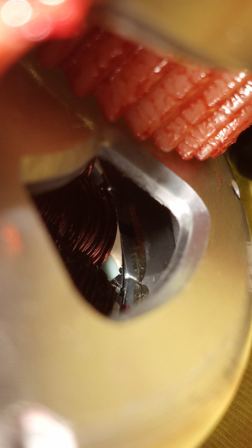

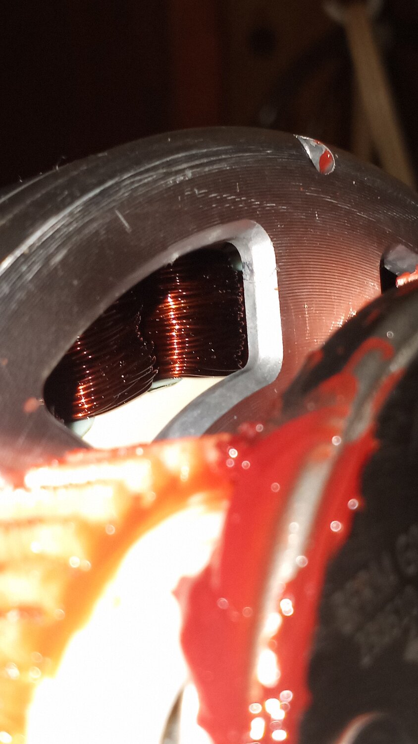

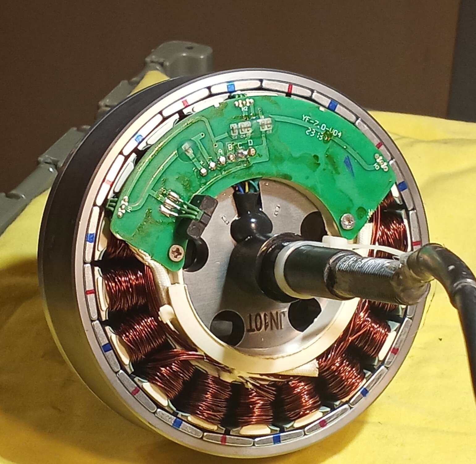

I’m waiting for the right chunk of time for me to open my motor and install a temp sensor. I have everything I need, except the time to do the work. Which, I have no idea how long it will take, so I’m telling myself it’ll take 3 days.

Yeah, I took it apart to grease the motor.
I wanted to try my fancy new $50 airplane grease. 😂
I finally got the thing back together today after sitting apart for almost a month. 😂
I spun it up a few times to remove the globs of grease.

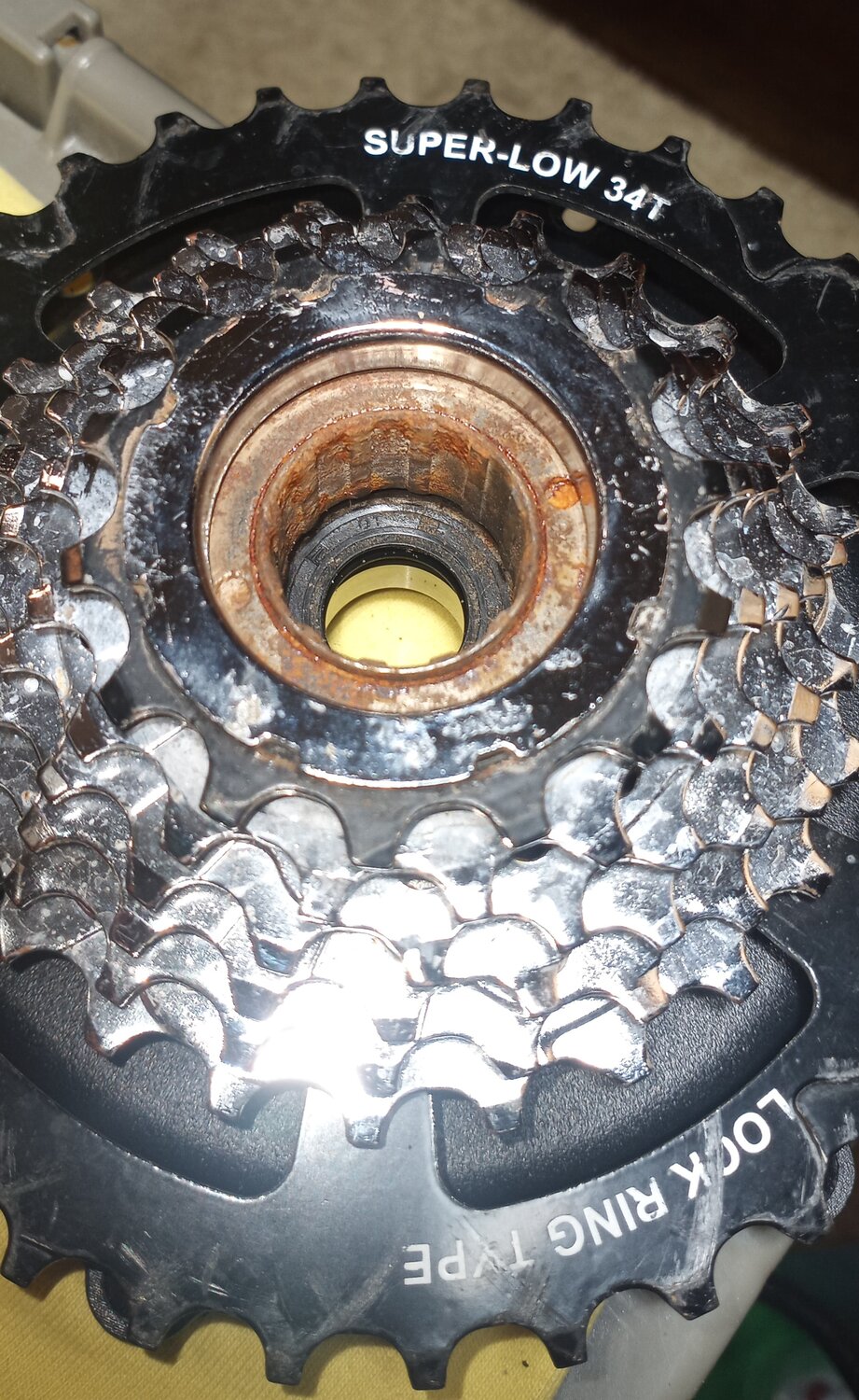

Then @m@Robertson talked me into getting a new freewheel for it.
It's arriving today and the freewheel tool by the ene of the week.
Thats awesome to see. I have two of those and have wondered wtf I was going to do if there was an internal failure on something that specialized.
