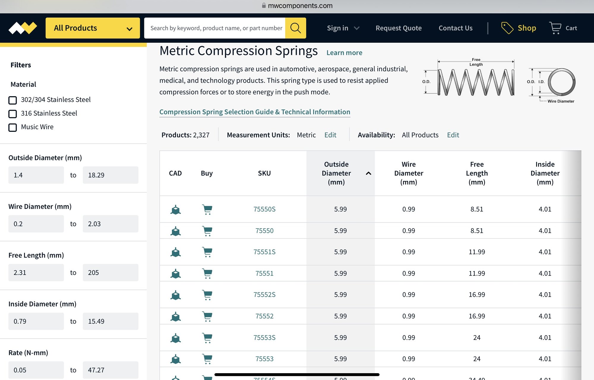

As an example, here is a spring supplier who lets you choose the parameters:
MW Components Springs Metric

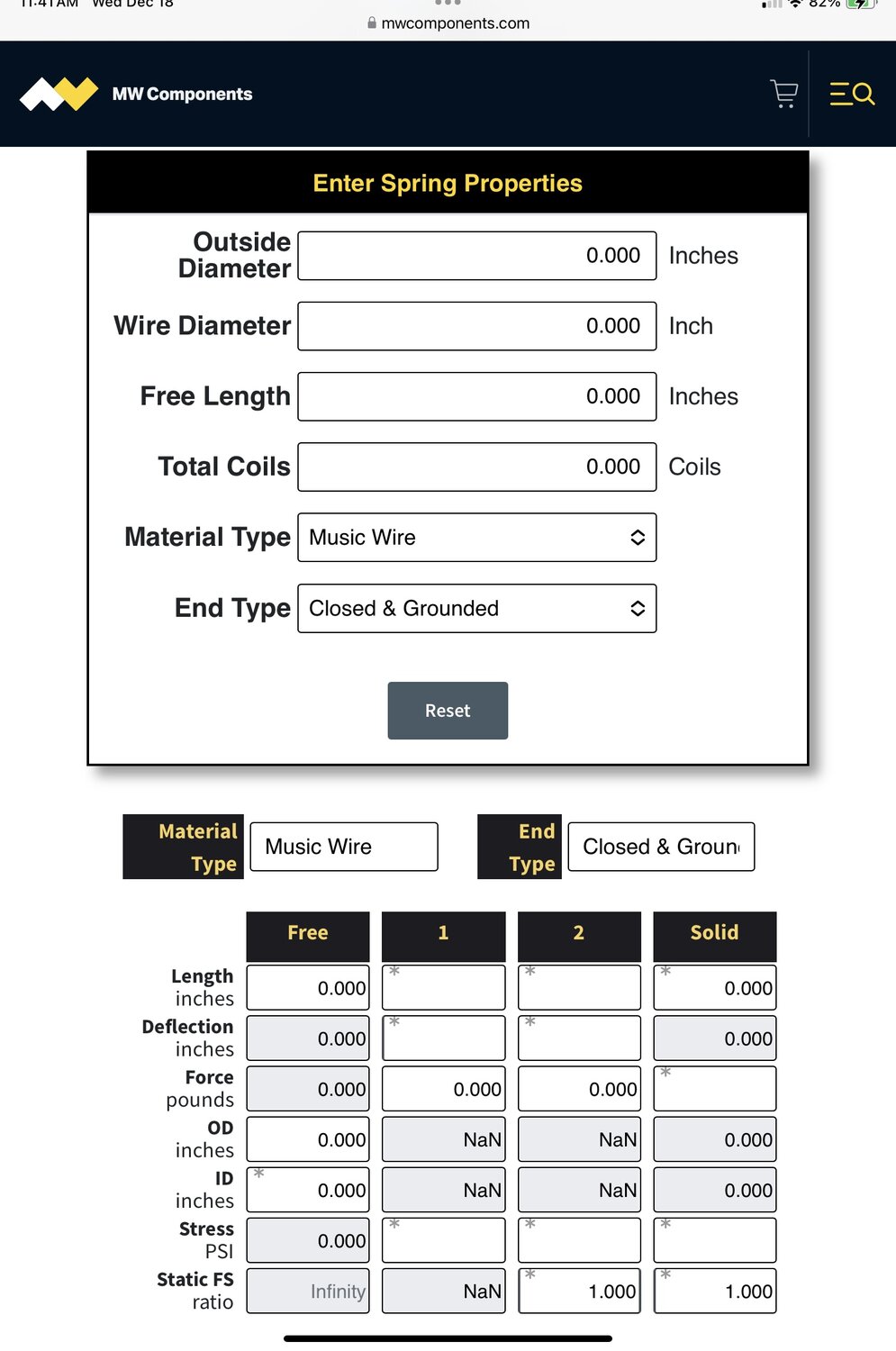

Or after failing to find it, they will build you one:
Spring Calculator
