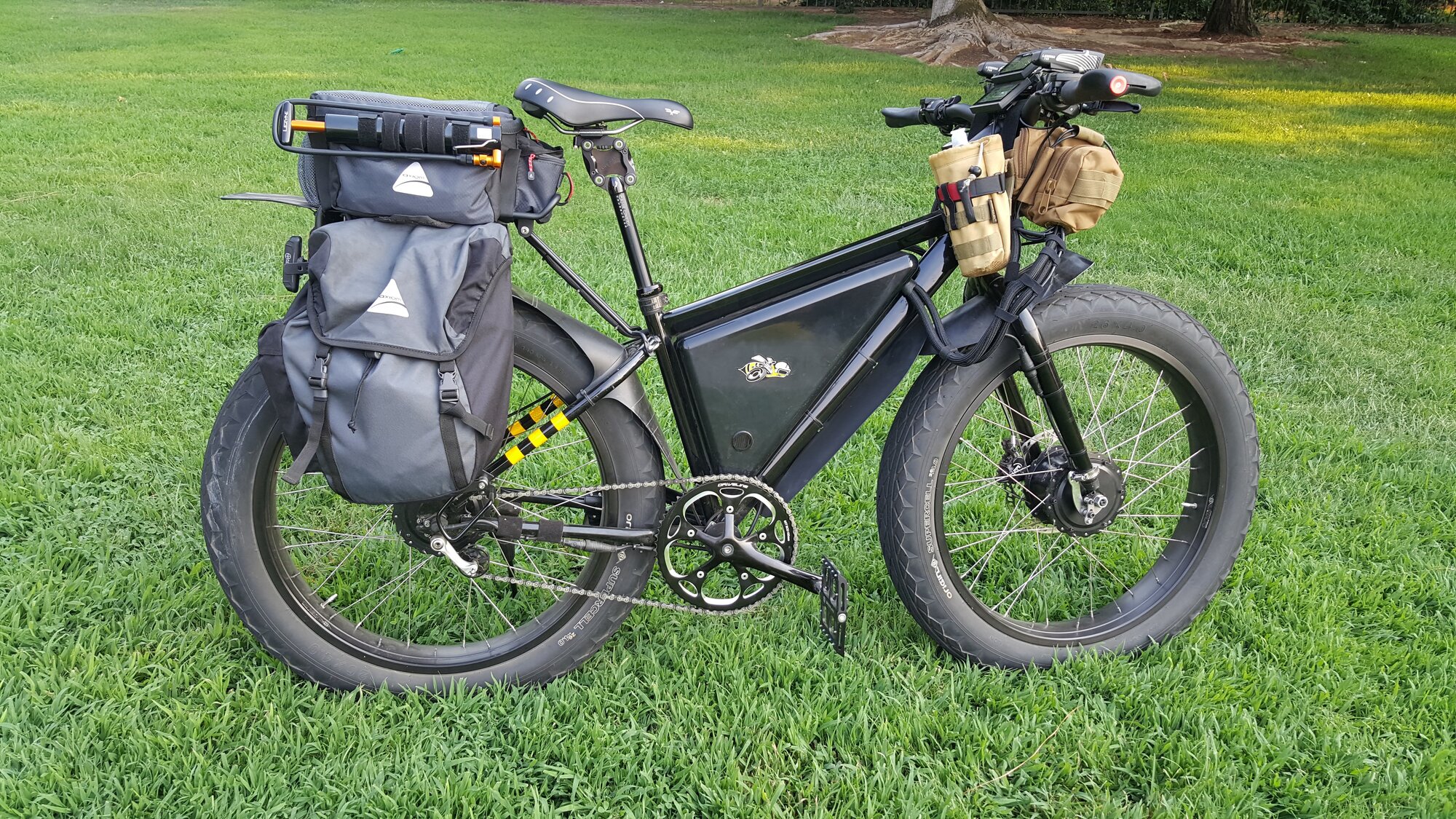

I think a lot of ebike owners miss out by blindly accepting stock gearing. To deal with my hilly terrain without killing my old knees, my 500W, 65 Nm hub-drive eventually ended up with one more gear, a smaller chainring and smallest cog, and a bigger largest cog.
On my lightweight low-power mid-drive — which cares about cadence, not wheel speed — I reduced the chainring to keep my preferred cadence in the motor's sweet spot (80-90 RPM) on steep hills.
Lost some top end in both cases. Wrong direction for you, of course, but these were good trade-offs for my legs, knees, and topography.

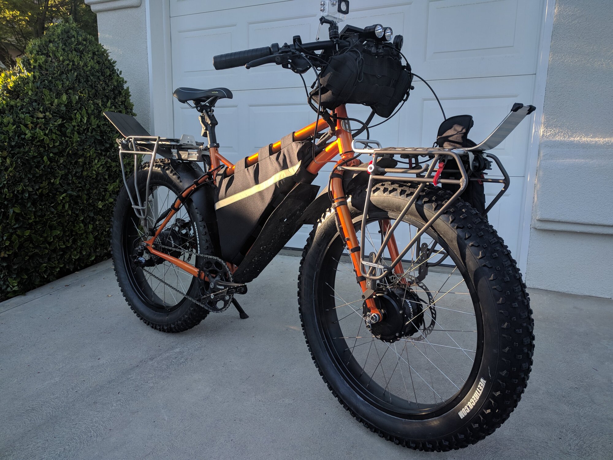

This hub motor bike lived on flat ground. Experiments worked me up eventually to a 60T front ring and a single-cog 16T Shimano rear freehub. The two hub motors meant I commuted at a fast cruise (despite very strong afternoon winds, which the motors eliminated from concern) and the big chainring meant I could work hard while doing it, taking the bike up and over the motor rpm limit for work/rest intervals.
Since you know bikes you can fart around similarly and just mix/match chainrings until you get what you want.
And even though the hub motor is independent of the drivetrain, you can still optimize that drivetrain just like you could any bike. This one has an 11-32T cassette (not a freewheel) that let me do just a 50T front ring for a working cadence at speed.
