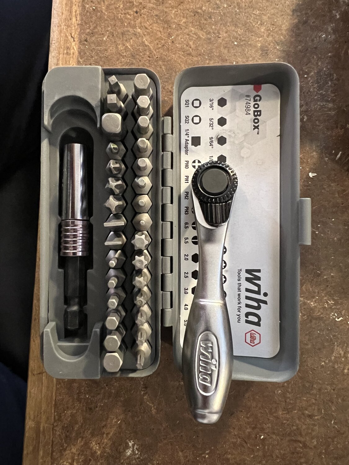

I am amazed a Wiha toolset is only $29. Thats some pretty high end stuff, usually.

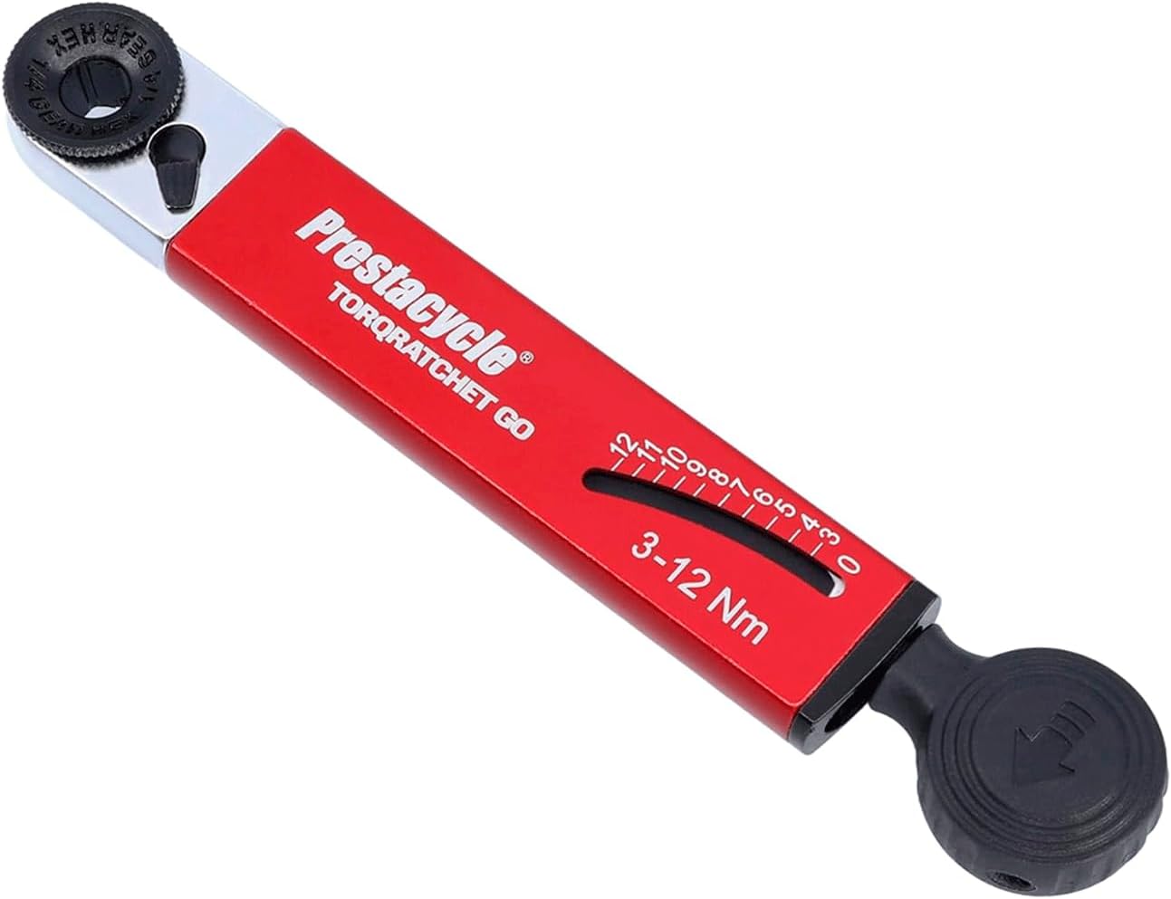

Prestacycle is a USA company that I am sure outsources manufacture to China. I just bought a small torque wrench from them recently that is now my bit ratchet in my tool kit. An ingenious little device. Effective but not cheap at US$60 for the wrench and a suite of all the hex bits (plus some Torx and a Phillips) you would need on a bike.

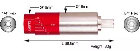

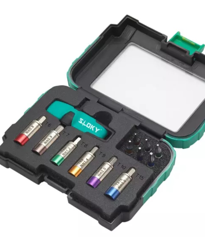

Has anyone tried this style of torque wrench?
I'm liking this,..
It is made on Taiwan.

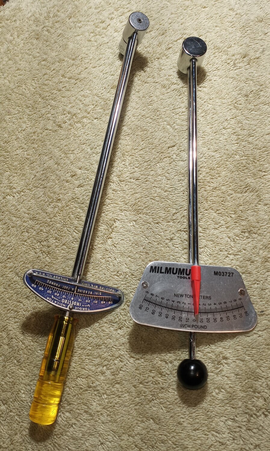

I had one but it was too hard for me to read.
I have a beam style torque wrench in 3/8" and that was my problem as well.
I have a 1/4" and a 3/8" beam style torque wrenches but I can't use them upside down because they don't have double sided square drives.
They're hard to use at an angle too because you need to look at the scale squarely or you'll misread the pointer.
The handles can get in the way too, and they don't ratchet, so you have to keep reseating the bit in the bolt head.

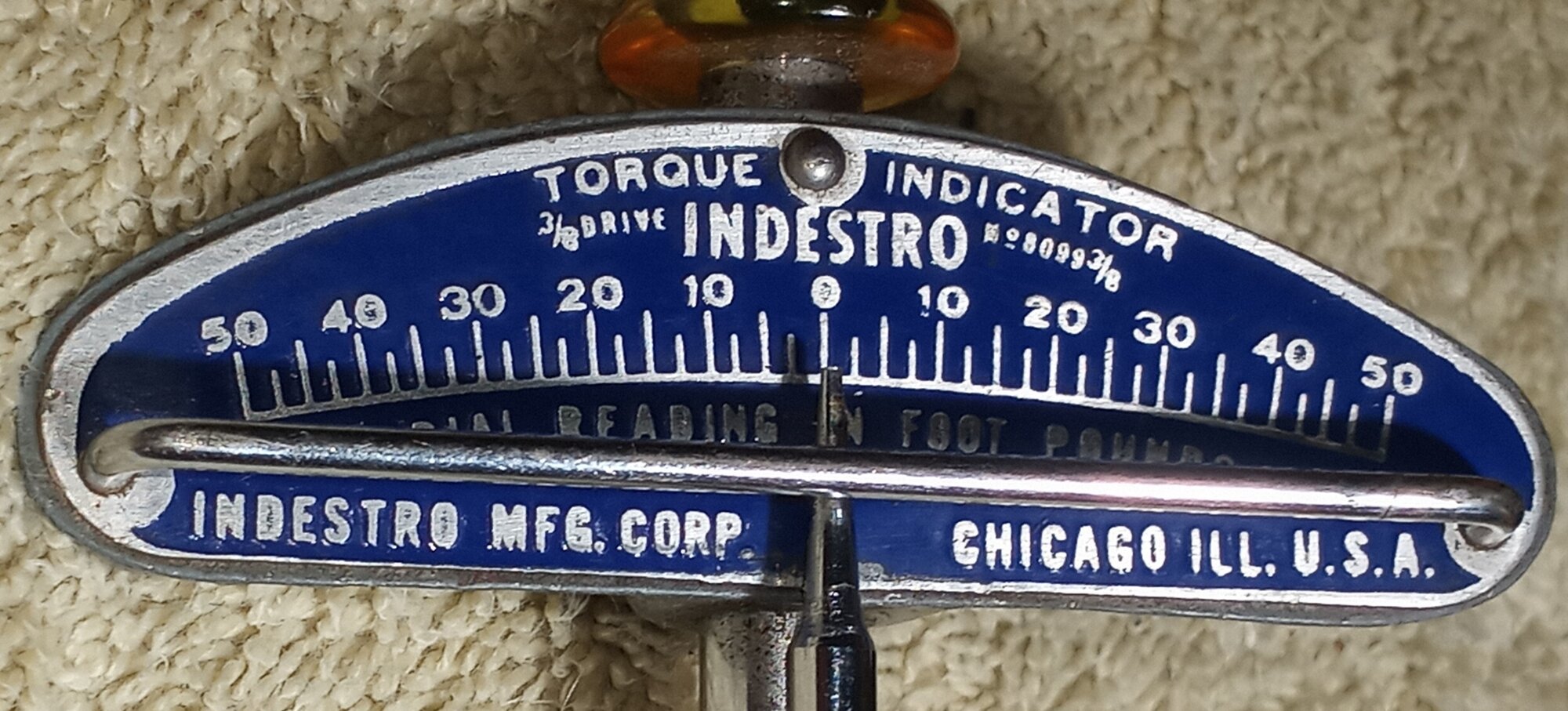

This torque wrench will be 50 years old next year. (1975)
I'm liking this,..

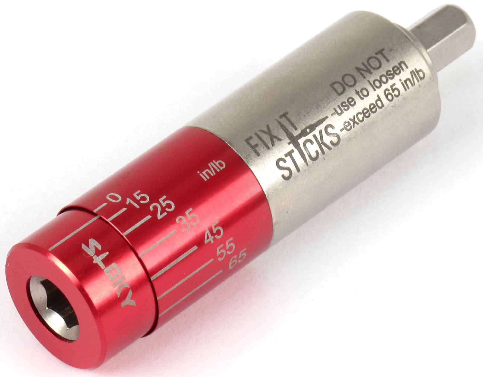

I believe it's made to limit, not measure, torque.
I'm pretty sure it's a spring dial gauge like the Prestacycle torque wrench that @m@Robertson posted.
It says this about it,..
"Visually determine the torque value during the locking process."
It also says "Do Not exceed 65 in/lb" so it breaks if you apply any torque past its maximum setting.
That's what I like about it. I would trust a spring dial more than something that's supposed to click or ratchet when they get to the torque setting.
I figure that a spring is less inclined to go out of spec or fail than a clicking or ratcheting type if you don't over stretch or compress the spring.
It's cylindrical shape would help to keep the scale visible at probably any angle, and would probably allow it to fit into places where my beam style handles get in the way.
I could use extention bits and a screwdriver handle on it to get it to reach.
A beam style torque wrench gets all wobbly and unstable when you load it up with extentions and bit adapters, and it's hard to keep it pushing squarely on a screw or bolt with the long handle off to the side.
The videos on the page show fixed adaptors, identified by color, that slip when the specified torque is reached. The users seem to work in repair shops. The page says the adjustable model opens up possibilities in hunting, shooting, and construction. In the field, one wouldn't want to carry a set of adaptors and a manual of torque specs in case a screw loosened. The adjustable model would let you estimate and adjust.
The page says it's for 2, 3, 4, 5, and 6 Nm. That would be 17 to 52 inch pounds. Perhaps adjusting past 65 inch pounds would deform the spring out of calibration.
Yeah, I saw that too, and I'm pretty sure that's a set of individual torque wrenches that ratchet at a specific torque ??
I think that the one I linked to is a spring dial gauge ??
It's too bad that they don't show that one actually being used.
So the dial is either set to a certain torque then it ratchets, or the dial shows real-time torque as you apply it (like a beam wrench)
I think it's like a beam wrench?

It looks as if it could be hard to read while torquing a screw. Amazon has a 1/4" beam wrench for $20.

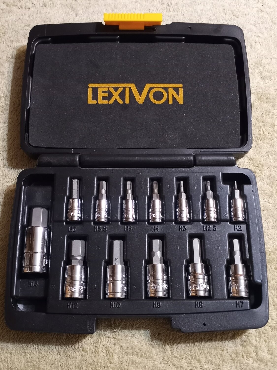

i have a couple lexivon torque wrench socket handles, 1/4 and 3/8, for larger specs like pedals, axles, cranks, etc. they’ve worked well but i don’t love the adjusting mechanism.

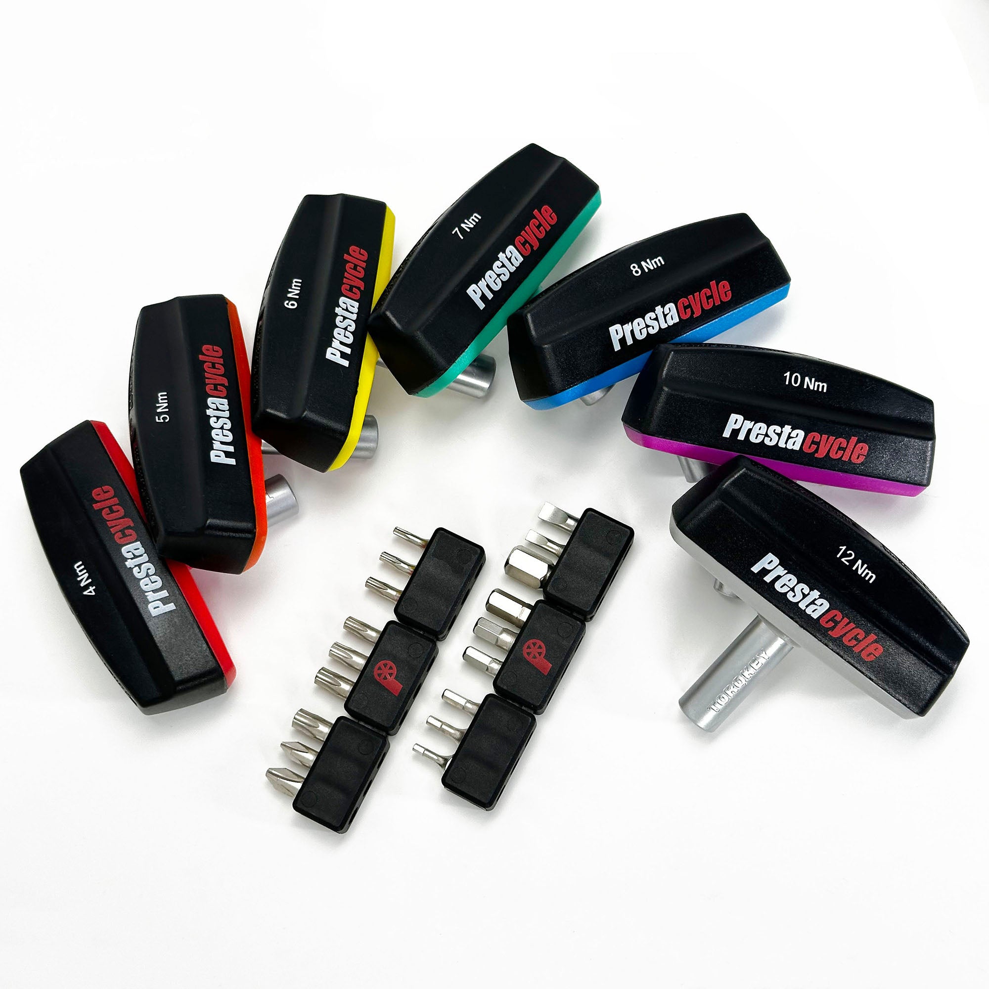

for low spec parts like stems and seat clamps and the like, i have a subset of the prestacycle torqkeys - absolutely perfect for bike use. they can screw AND unscrew, you just grab the right color, zero chance of over-torquing a small fastener. also very compact and light in the tool box.

I bought my ¼" drive in/lb beam wrench on Amazon for $23.
It's kinda junky, but I figure it's better thannothing.

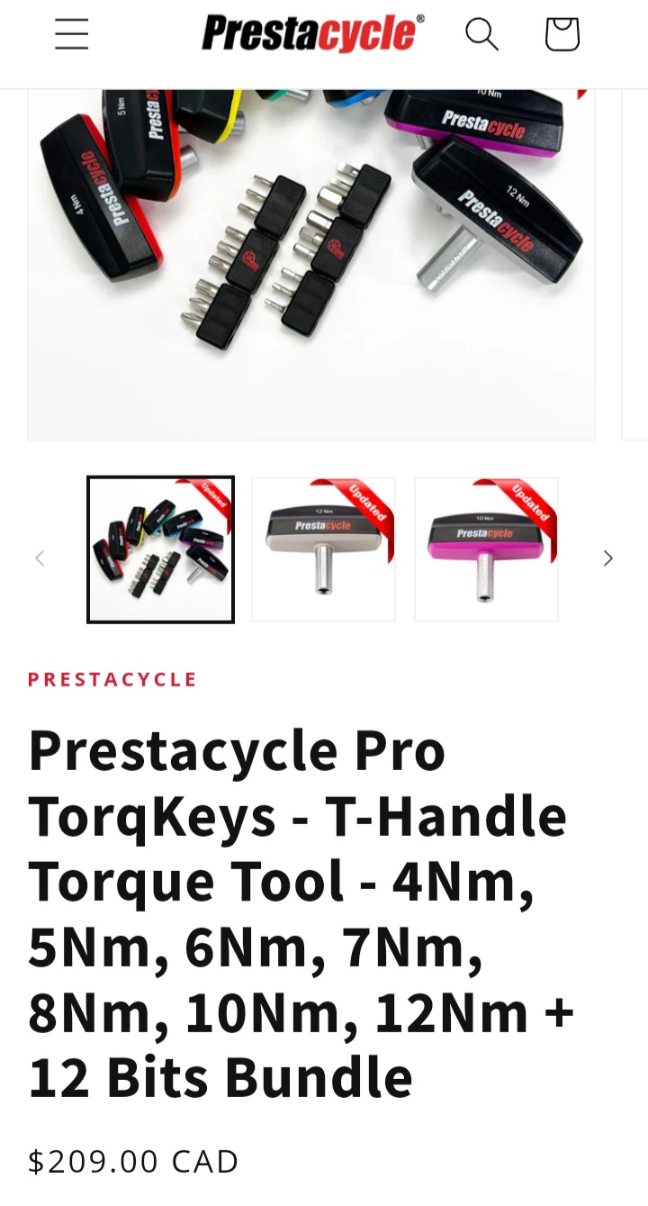

,.. i have a subset of the prestacycle torqkeys -
Ouch $209 plus tax and shipping.
I'm just gunna keep wingin it for now. 😂
