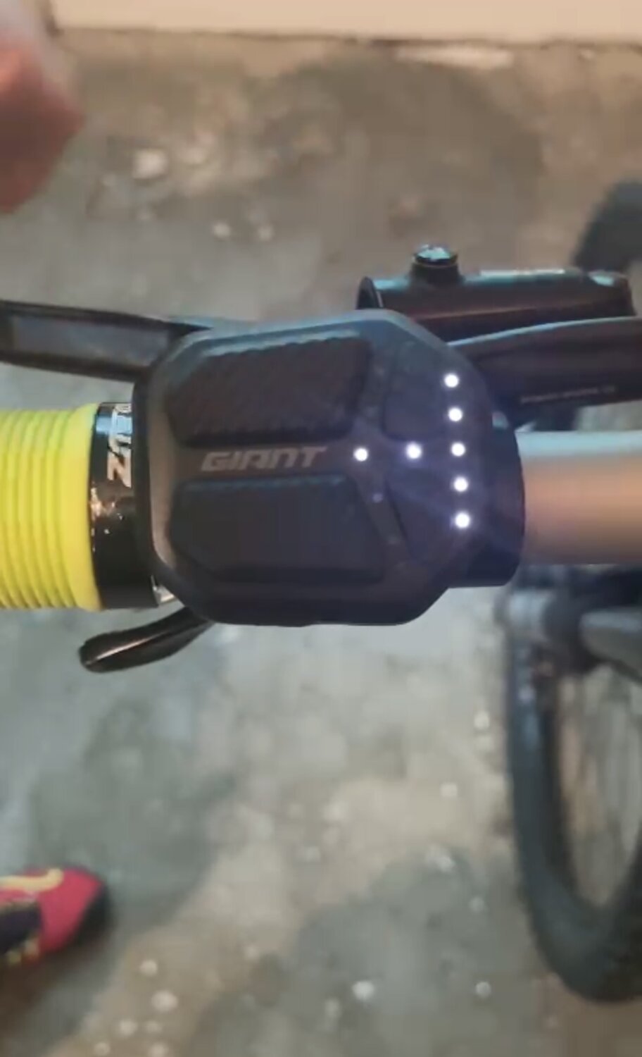

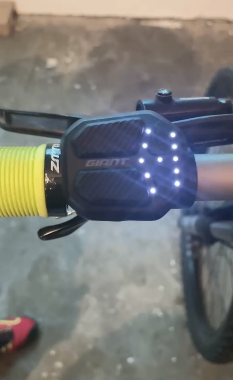

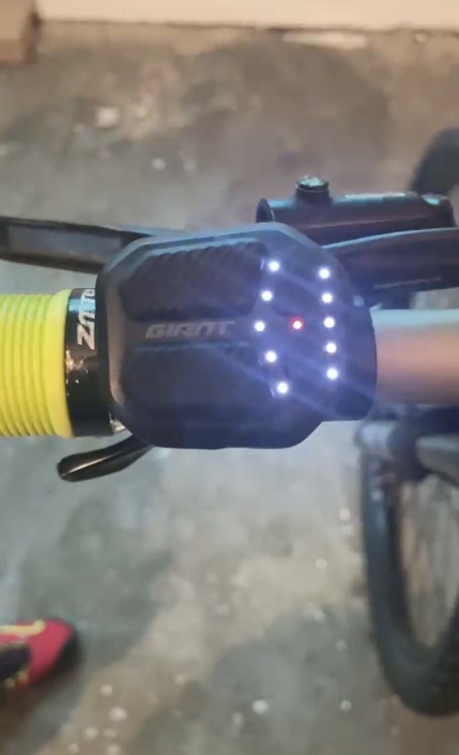

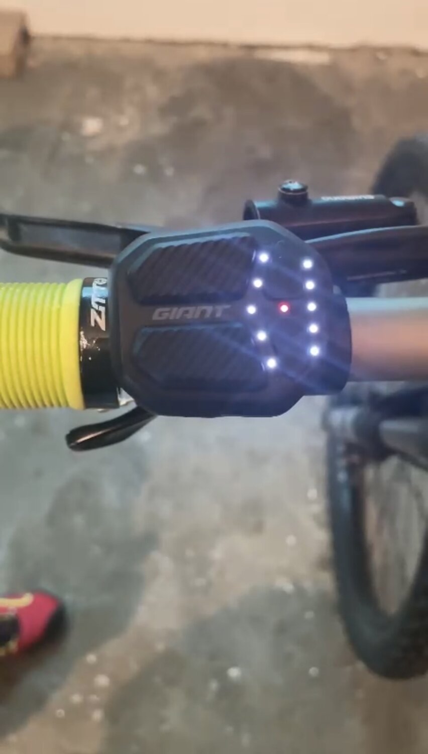

Hi,
I wasn't able to post a video, so I pulled out a couple of pictures to make it clearer what the above problem is about. I didn't find a person who had the same problem as me, so maybe the pictures will help.
As I mentioned earlier, from when I press the button on the ride control, the whole process of turning on the lights takes maybe 1-2 seconds.

I "think" that middle 3rd LED indicates a speed sensor issue. From the manual...
5.4 RIDECONTROL ONE
In case of a system error, the RideControl ONE display can show various error messages. Lighting
indicator (H) will flash, accompanied by one of the error code indicators (L) that double as power assist
indicators). Switching off and on will reset the system in most cases. If so, continuing a bike ride is no
problem. Contact a dealer for final test results via Service Tool.
Note: LEDs are numbered from bottom to top.
• LED 5: Heat issue
• LED 4: not applicable
• LED 3: Speed sensor issue
• LED 2: Motor issues
• LED 1: battery issues
For LED 5, heat issue: The bike needs some time
to cool down. Restart the bike after a few minutes.
Release stress on motor during high temperatures.

That's the first thing I thought of. I tried unplugging it and still the same thing happened.
I believe Dave is on it, the bike knows it has been derestricted at some point and is not going to run. I very much doubt you’re going to get much help from Giant; I would hesitate to spend any more money on this, I suspect it’s a lost cause.

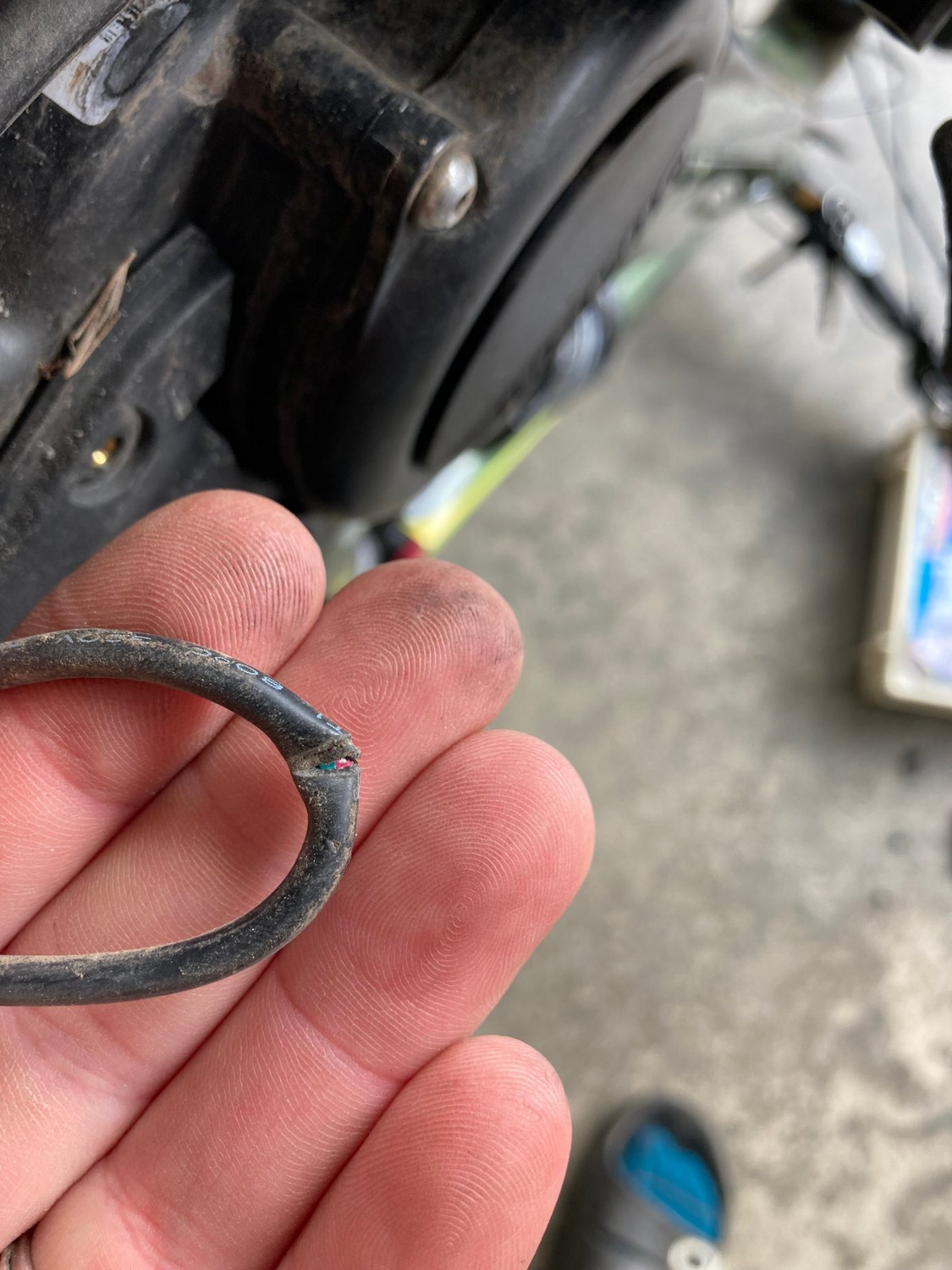

Have you considered having the speed sensor cable replaced first? Some cables on these bikes are known to be defective or perhaps get pinched inside the housing if not adequately reinserted. It’s a rat’s nest inside and it’s a wonder how anyone could put things back together properly. If you can find a reputable shop that can replace the sensor, I think that would be a start.
No one wants to see their motor bricked especially knowing that the bike has been chipped. I’ve read some YouTube comments on a derestrictor site, in this case Speedbox, where some owners of Giant bikes have had to pay the manufacturer directly to unlock the motor. One person even had the motor replaced after it was rendered useless by the chip only to have it occur again. Even after said comments and warnings, others were still in a mad rush to have one of these devices installed. :rolleyes:
