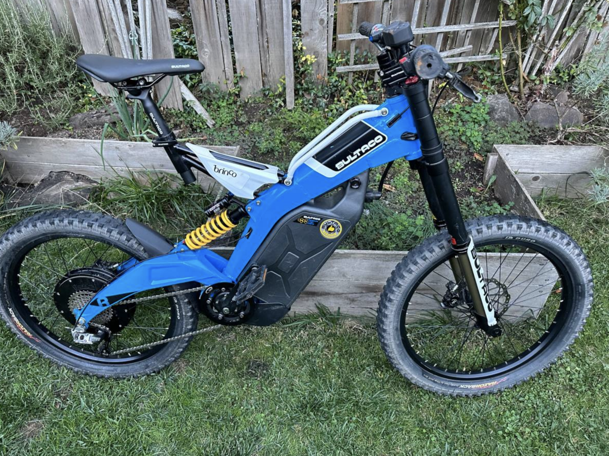

Much more refined and was made 9yrs ago in Spain. 2000w DD motor, 50v 1300wh battery and s Schlumpf High Speed crankset annd 24" wheelset and weighs 40kg. On my local CL for $3500. I want to buy it just to have in my living room!

Much more refined and was made 9yrs ago in Spain. 2000w DD motor, 50v 1300wh battery and s Schlumpf High Speed crankset and 24" wheelset and weighs 40kg. On my local CL for $3500. I want to buy it just to have in my living room!
That's a nice bike, $3500 is a good price.. Schlumpf drive is likely $1k alone.
24" wheels are very nice, just limited on tire options.
I would buy it just to use it as a dirt bike on singletracks
🤣🤣🤣 That's exactly what I suggested he do. But with his existing ( I believe stock) chainring it wouldn't clear the chain stay. I suggested he go with a slightly smaller chainring but as with the bike.. he thinks everything bigger is better.
I wanted one so bad, in fact my first diy ebike had those 24 tyres.
